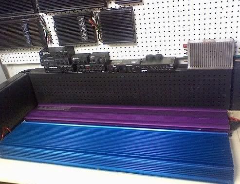

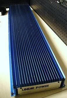

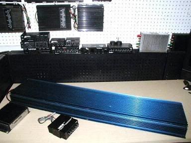

Here is an old-school amp you don't see everyday. It is a Linear Power, 42-inches long. Pictured next to it is a US Amps Vlx-400 and a few other pieces to show how big this thing is. Definitely old-school.

Thats a nice Linear is it real,did it come out of a Kicker(pyle)Demo car.
Speaking of US AMPS,when Jack and Rodney were here in FLA.,they had a display wall which contained what they called the strongest amp ever.And I believe it was at the time,a Second Generation(So-called First) amp that was at least 80 inches long,it never made production.But it definatlly had life to it,circuit board,componets,power wires.
So is the Linear Power real,or is it two amps in one chassis

That's for real - I've repaired one. There are two amplifiers-proper in there with the power supplies operating master/slave (that's the way US Amps put it...but they were paralleled).
I've never seen the big Linear Amp. Wow.

That is a big LP amp....lets find the retail price and figure inflation for today's price I remember getting a price of 350 on a PAII and I worked there, I could have a nice winterbeater car for less at the time.
