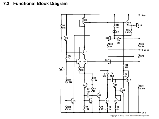

Here is a functional model of the 78xx. The ground pin does not look like an adjustment signal. Perhaps adjustment would be better with a few 914 diodes to create a fixed reference.

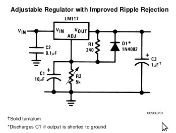

Not true, it is somewhat the other way around. 78xx normally don't have any cap across the normally non existing adjustable resistor while it is recommend with LM317 that usually has the setting resistor. LM317 datasheet clearly mentions what improves by adding the Cadj cap. Without it it makes no real sense to use LM317 over 7815. A 7 dB improvement in ripple reduction is worth the few cents for the cap. If low cost is your thing then maybe but since DIY is more expensive than ready built stuff one better aims for highest performance. Why would one aim for less good performance? Of course one wants better regulation and better ripple reduction!

Attached is an optional improvement. If I add the cap to reduce ripple, I must also add the protection diode. I would consider doing that if ordering a FAB pcb. If I was just hacking a breadboard, I try to keep it simple as possible.

Alas, the thread is drifting .. they all do eventually. I have decided that the concept of connecting a fixed regulator ground to a reference voltage to lift the output was an accidental feature, not by intention. It may have undiscovered flaws unless it is integrated with an opamp as shown in app examples.
