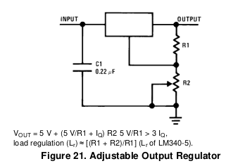

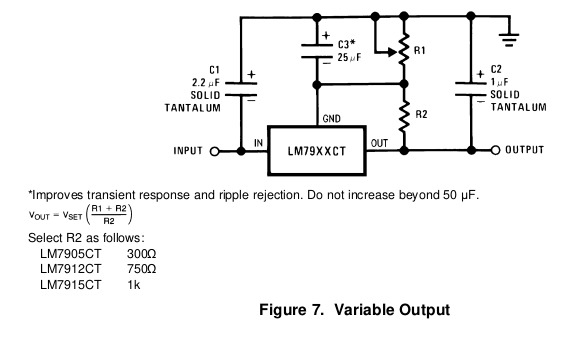

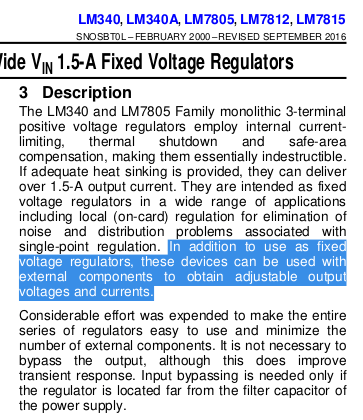

The topic is literally asking why anyone would adjust a fixed reg like a 7815 instead of using an "adjustable" 317. NareshBrd and myself gave valid answers why. The person who is wrong and dragging things off topic is you.Pot calling the kettle back. The difference between you telling me I was wrong, and me telling the other guy he was wrong, and the other guy telling me I was wrong is that of the three of us, only I was on topic.

Pass also use this technique in the differential pre-amp stage of their integrated amplifiers (likely all their pre-amps).
I’m a DIYer, so the four 78xx went the journey, replaced by discrete SparkoS Labs. regulators to very good effect.
- Why adjust 7815, a fixed-voltage regulator?
