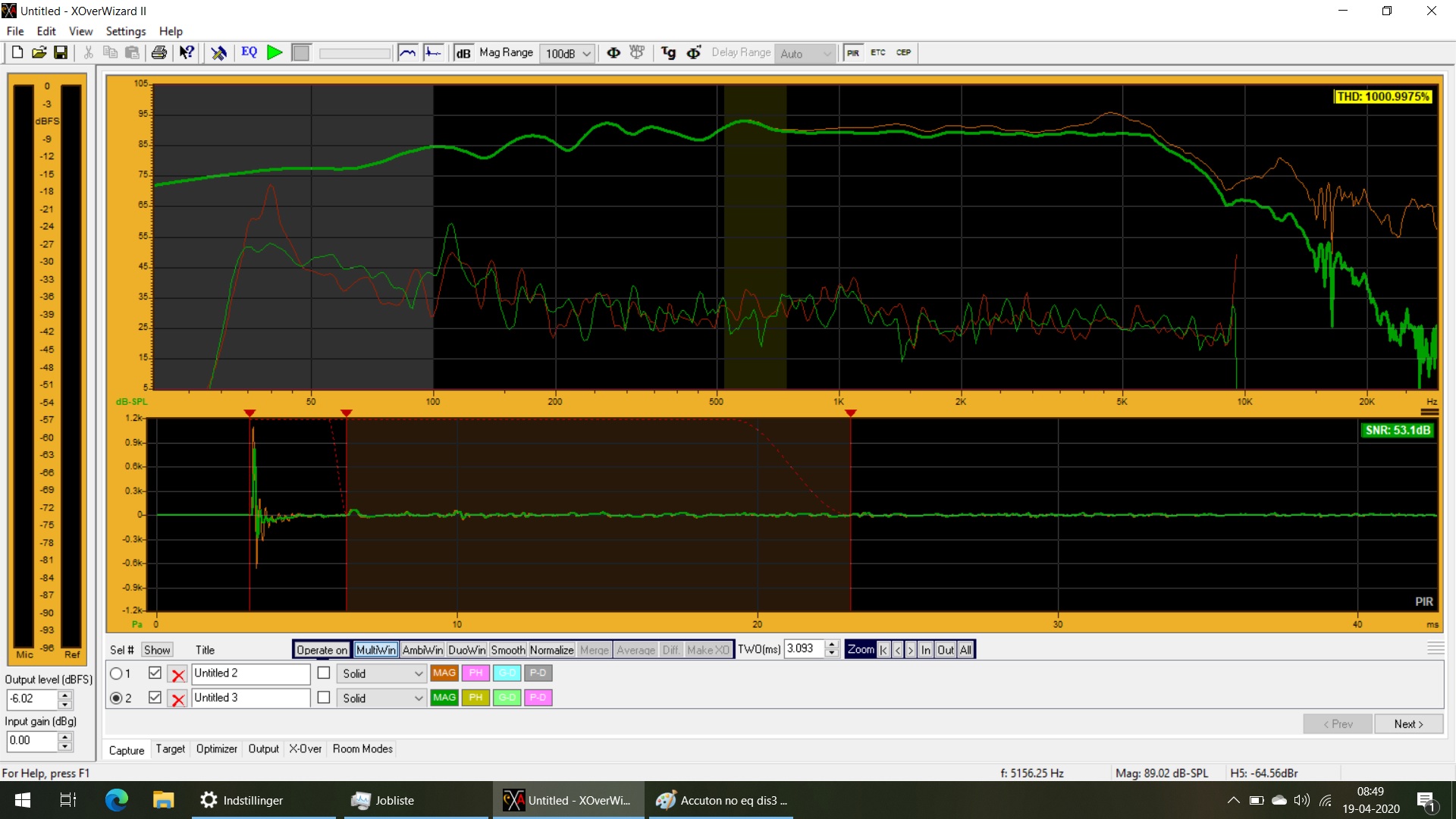

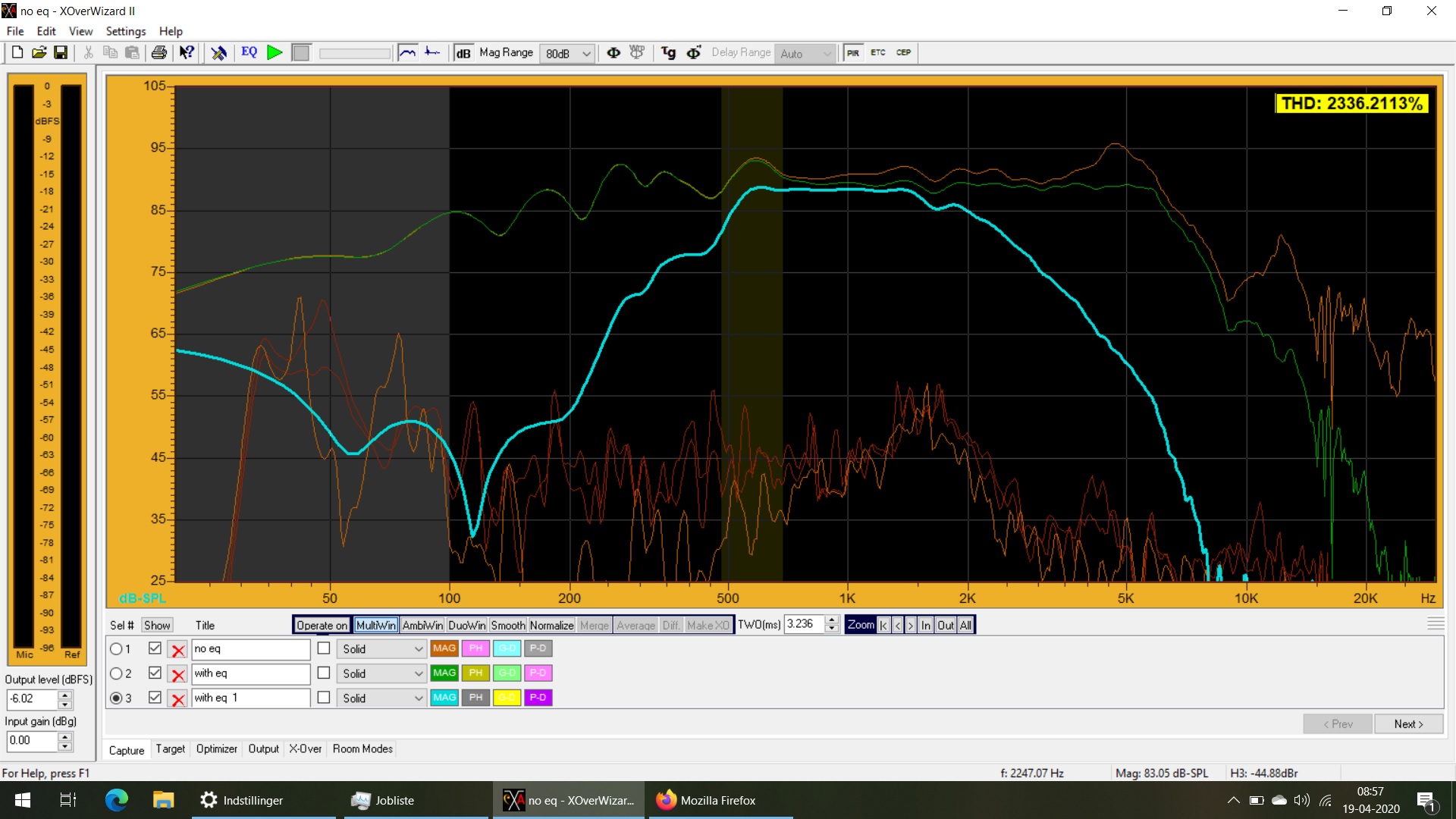

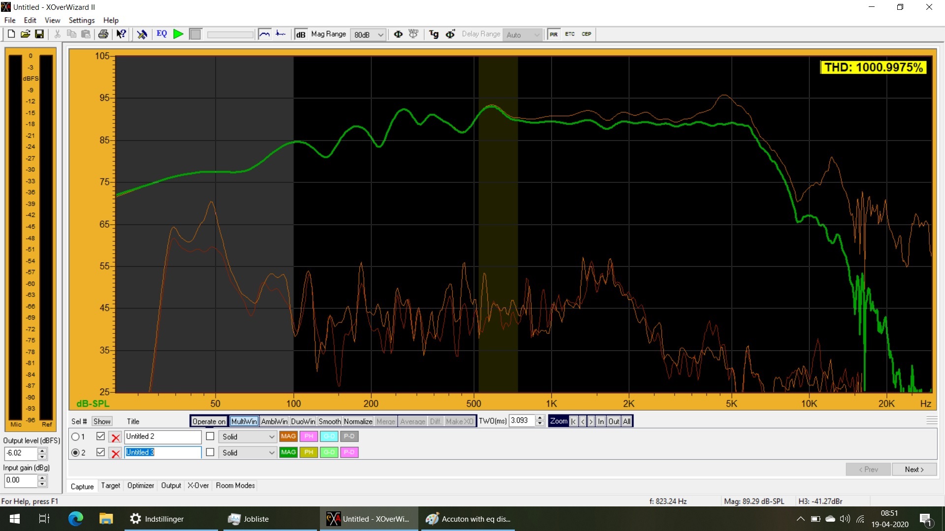

When you measure distortion, it was a good idea to move the mic a little closer, to eliminate as much of everything - besides the driver itself. Now at 10cm instead of ~1m with a pillow on the floor.

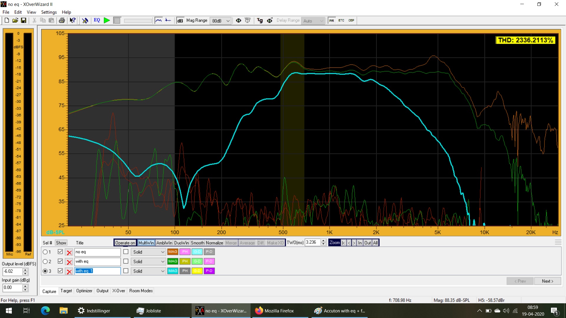

Here are the result with and without the filter(FR + 3'rd harmonics) I currently use in my 4 way system - only the midrange is playing:
As can be seen - distortion do lower, when filters and eq are used.

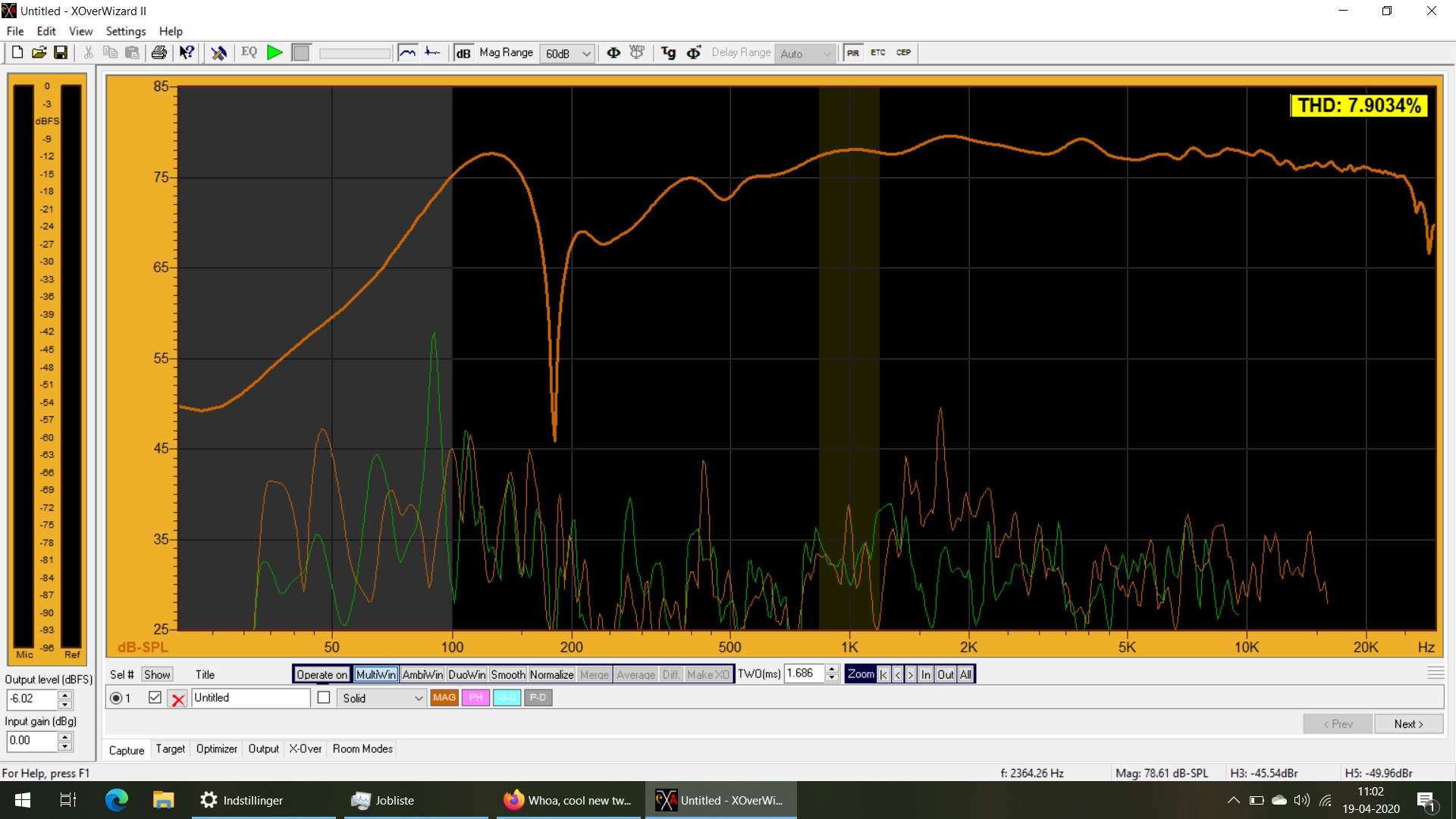

Front plate isn't flat so i expected nonlinearities in frequency response. Try to fill the gap between wg and front plate with bluetack. Just out of curiosity.

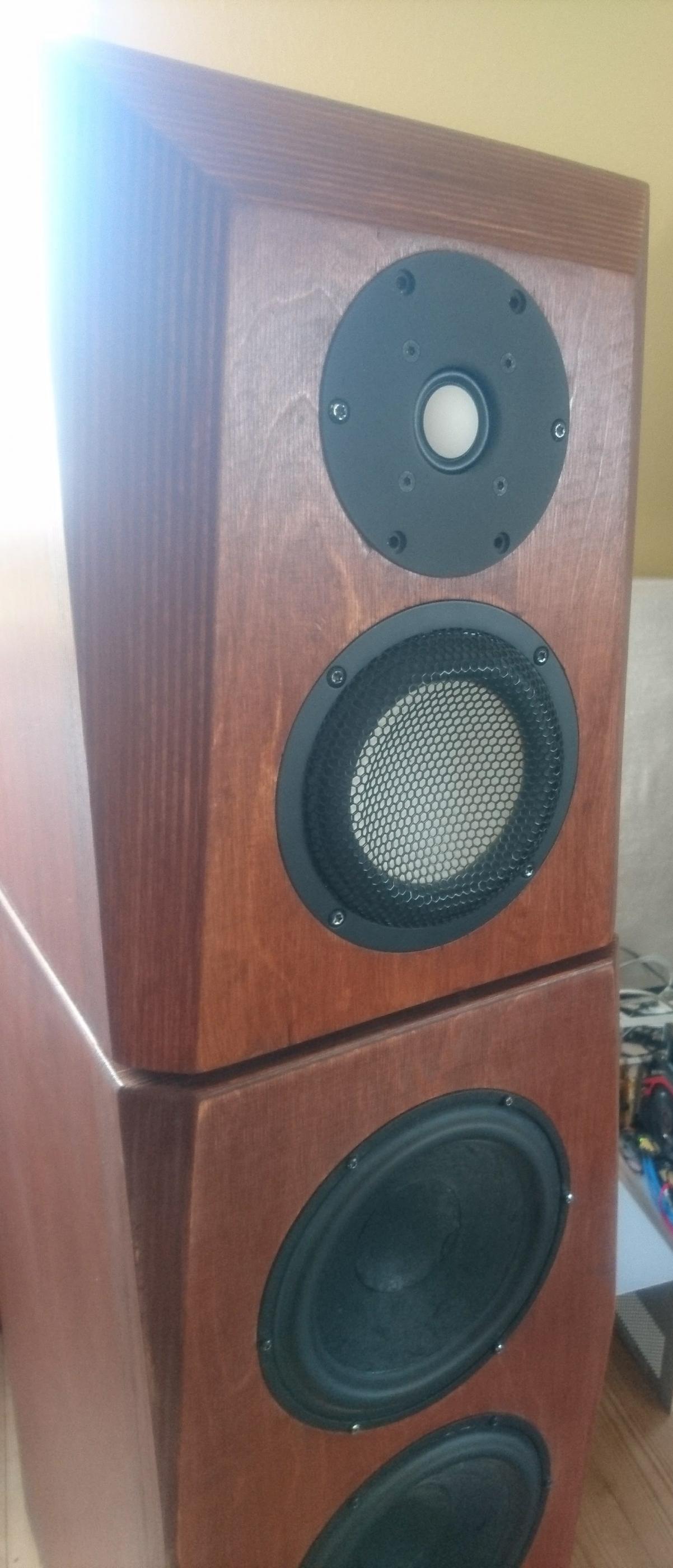

Here we have my speaker:
In this cabinet, with 24LR and some EQ - it measures like this:
3'rd and 5'd harmonics included.

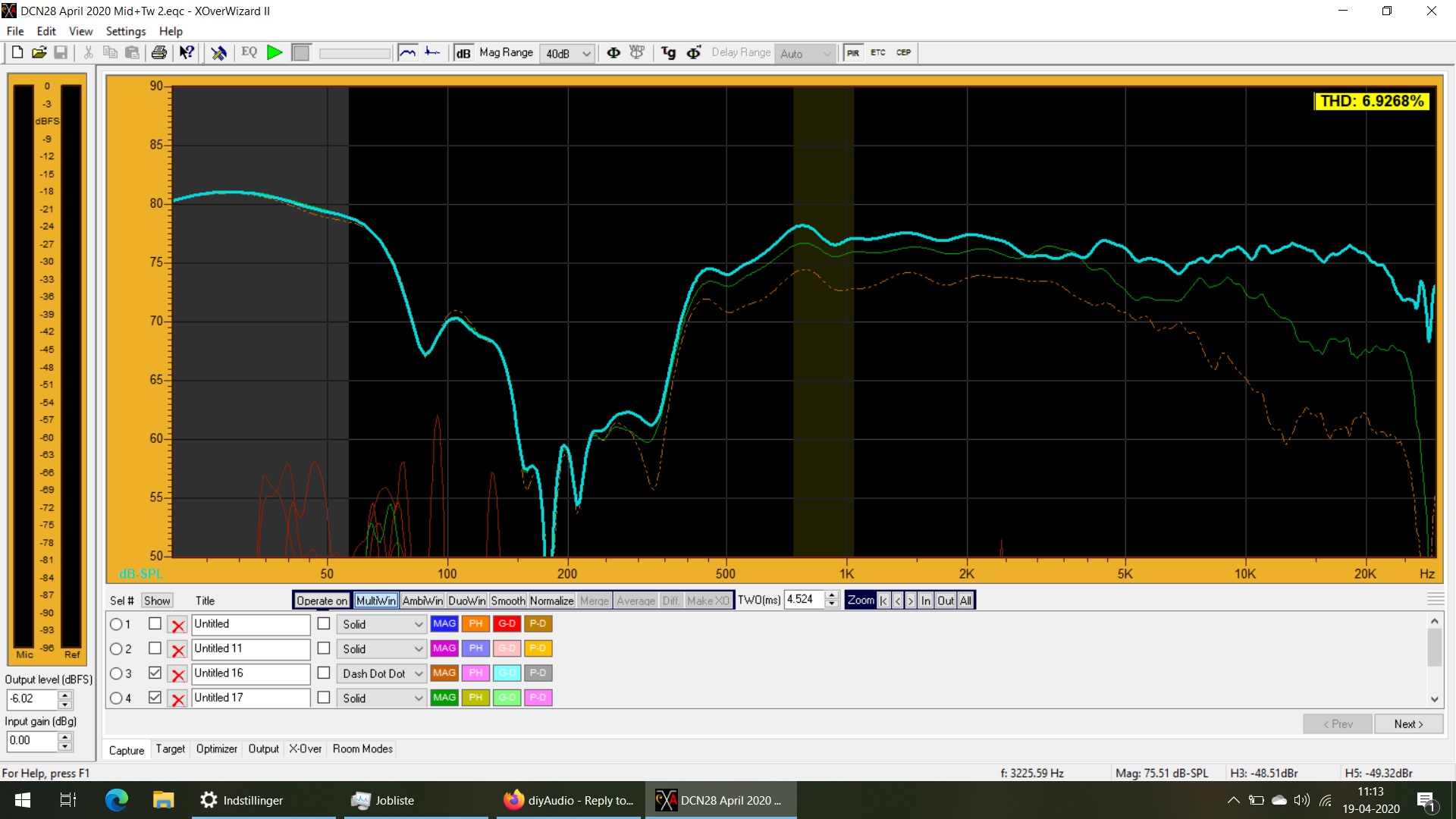

And here are sone quick and dirty measurements of the on-axis and then ~15 and ~45 degrees - just to see that it is not total crazy:
As can be seen when turning the loudspeaker in angles - I did not position the speaker perfectly when it comes to the distance to the mic 😱
