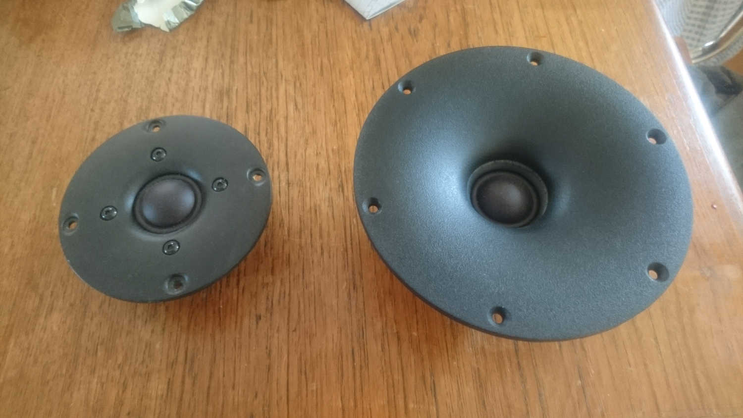

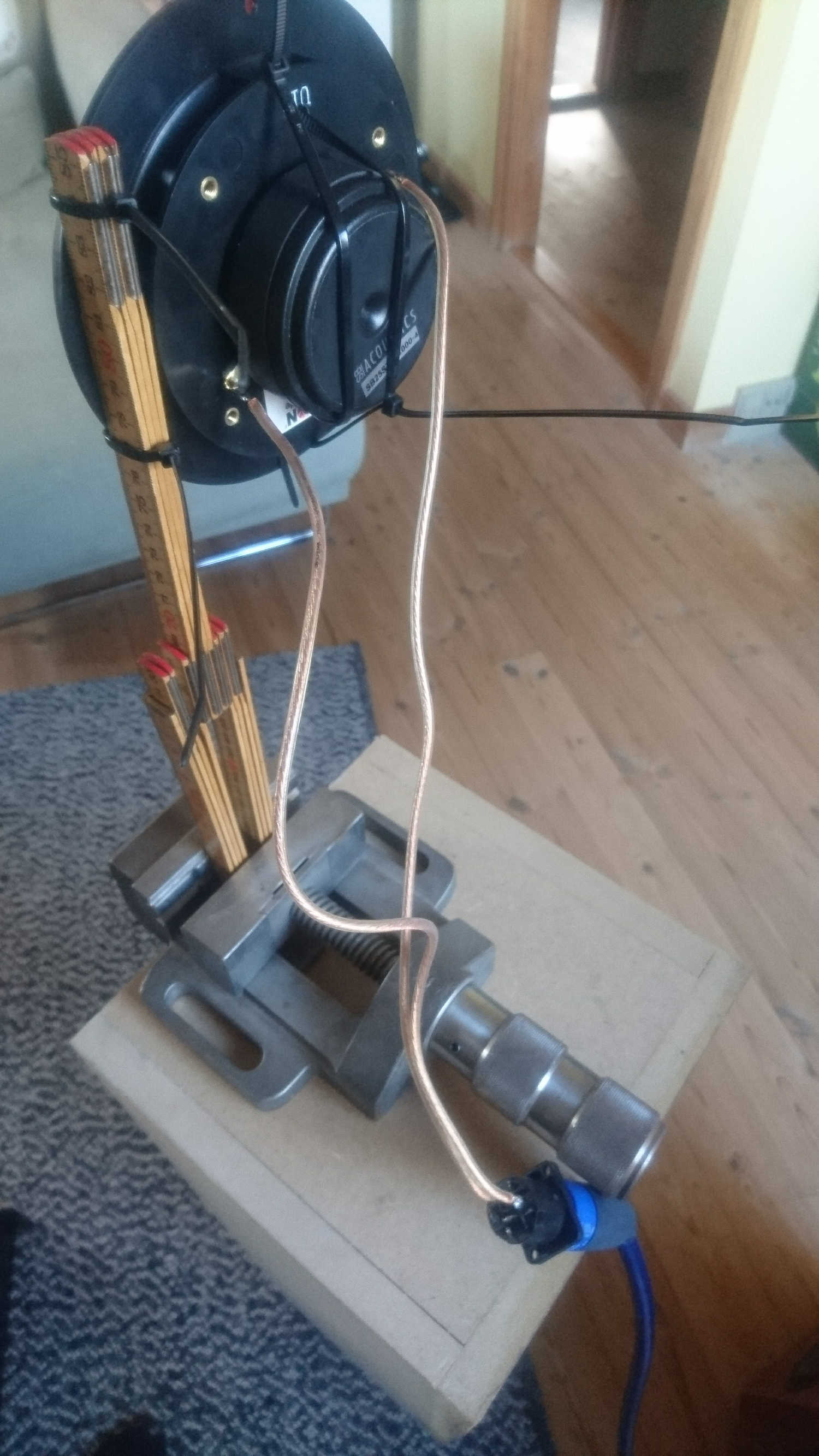

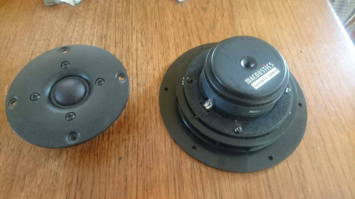

Just bought a set of Visaton 148 R for fun - I'll see if they work with some different tweeters I have lying around🙂
They should be here before the weekend - I'll post back with some measurements.
Excellent! Good man. What do you happen to have lying around? I've been interested in the Visaton & Monacor's equivalent WG-300 for a while, but never got around to doing any work with them, so will be very interested to see your results.
Thank you 😉
I have a set of older 25mm SB acoustics, some Morel Supreme, Seas Magnum, SS Revelator 9900, SS R2904 7000005.
Thought of trying the WG on the SB's.
Maybe I'll try to buy the Seas DXT too, to see what the rave is all about 😎

I suspect it'll do well with the SB. One way to find out... 😉
The DXT is very good for what it is. Doesn't load as low as larger waveguides of course, but what it does, it does well.

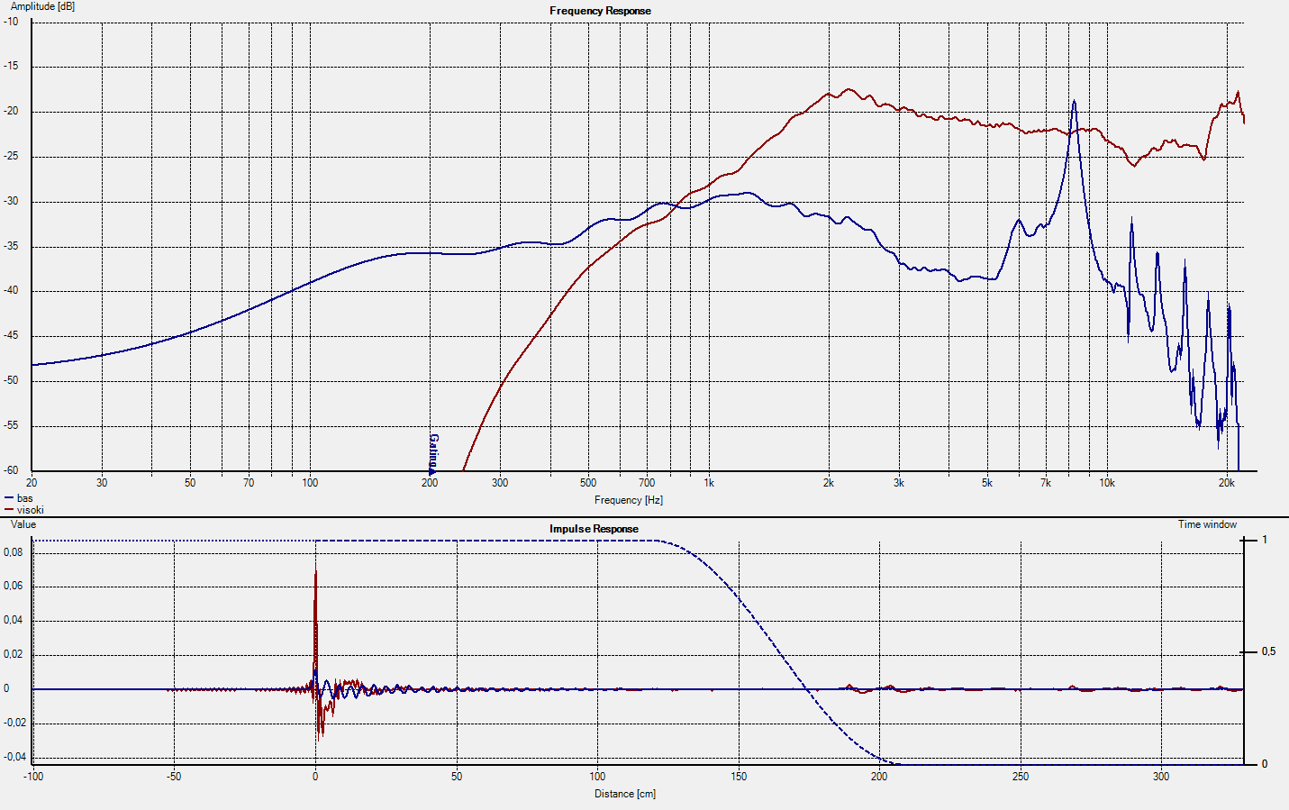

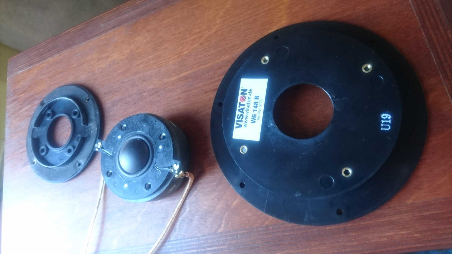

The blue curve is with the waveguide mounted directly onto the tweeter and the green curve is when I took off the front of the tweeter, before I mounted it on the waveguide, so that the dome came as far into the waveguide as possible - should have given me some less suckout....
Both measurements are gated, as can be seen in the impulse-window, where I cut it off just before the floor-bounce

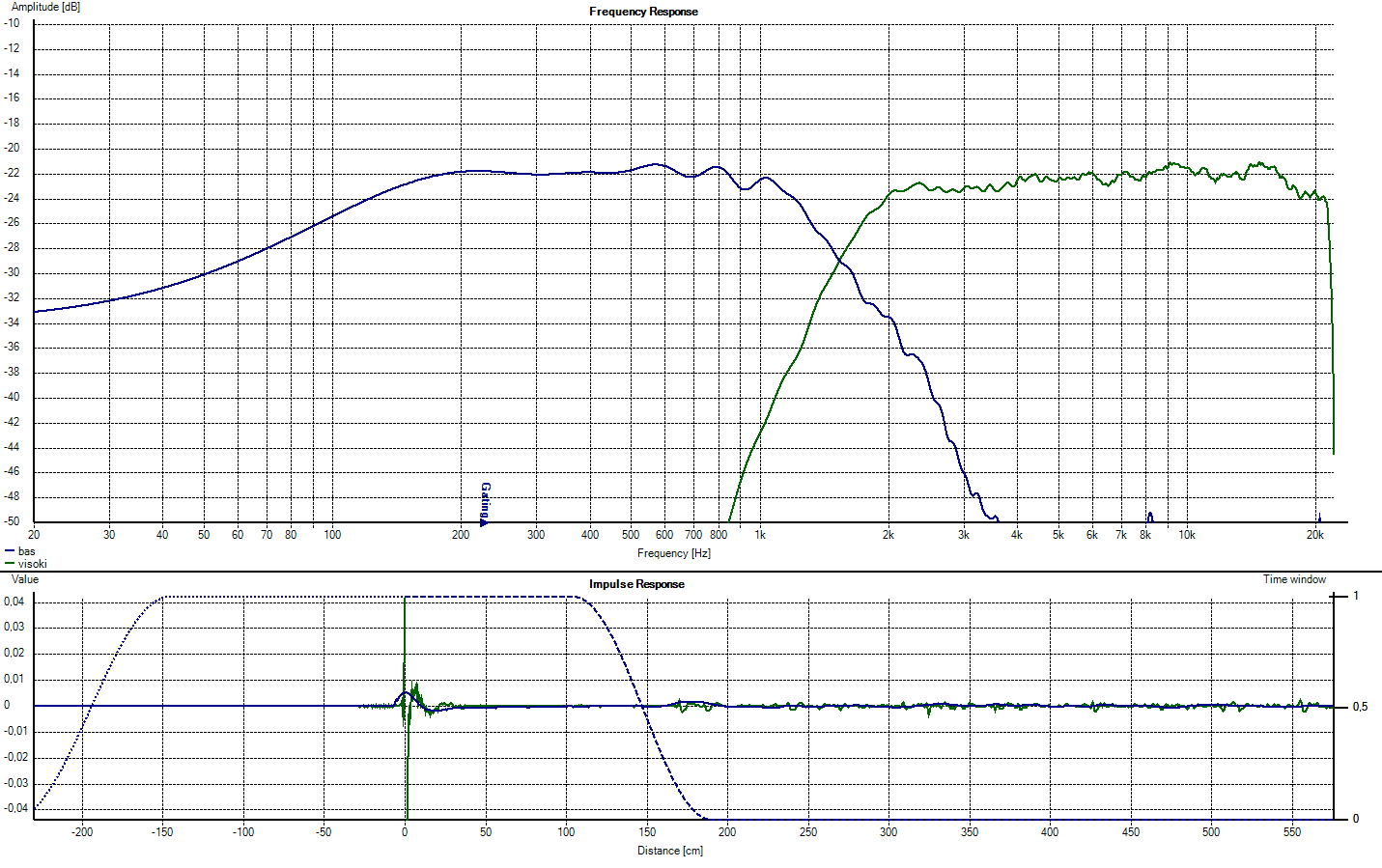

I measured Morel DMS30, Seas 17TFFC and Alpine ring radiator and all three measured fine. I'll post some pics.

...All in WG148R and with Seas L15RLY.
Very interesting. I see some signs at c. 12KHz in these too, albeit variable, so possibly something in the profile. Still pretty good though. 🙂
That looks very good 🙂
I have the Morel Supreme lying around - maybe I should try that one. Why did you choose the Seas + WG and not the DXT, since they should cost the same?
And how did you mount the tweeters?
This waveguide gives me controled directivity a bit lower than DXT and i don't think that DXT could handle low crossover points that you see here. With separate waveguide i have controled directivity where i need it and i am not bound to just one tweeter (as you can see from above). I mounted it the same way you did. Alpine was glued with hot glue gun though, too small and no screw holes.
There are some pics HERE on mounting Morels.
