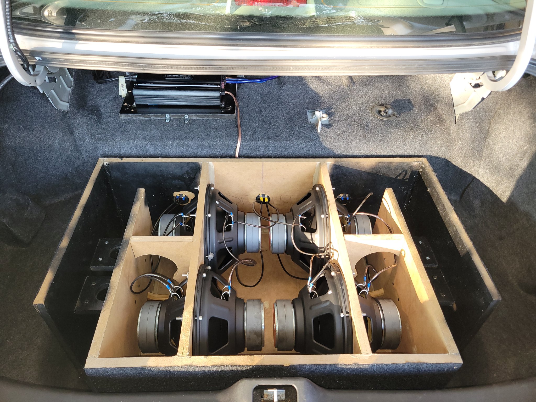

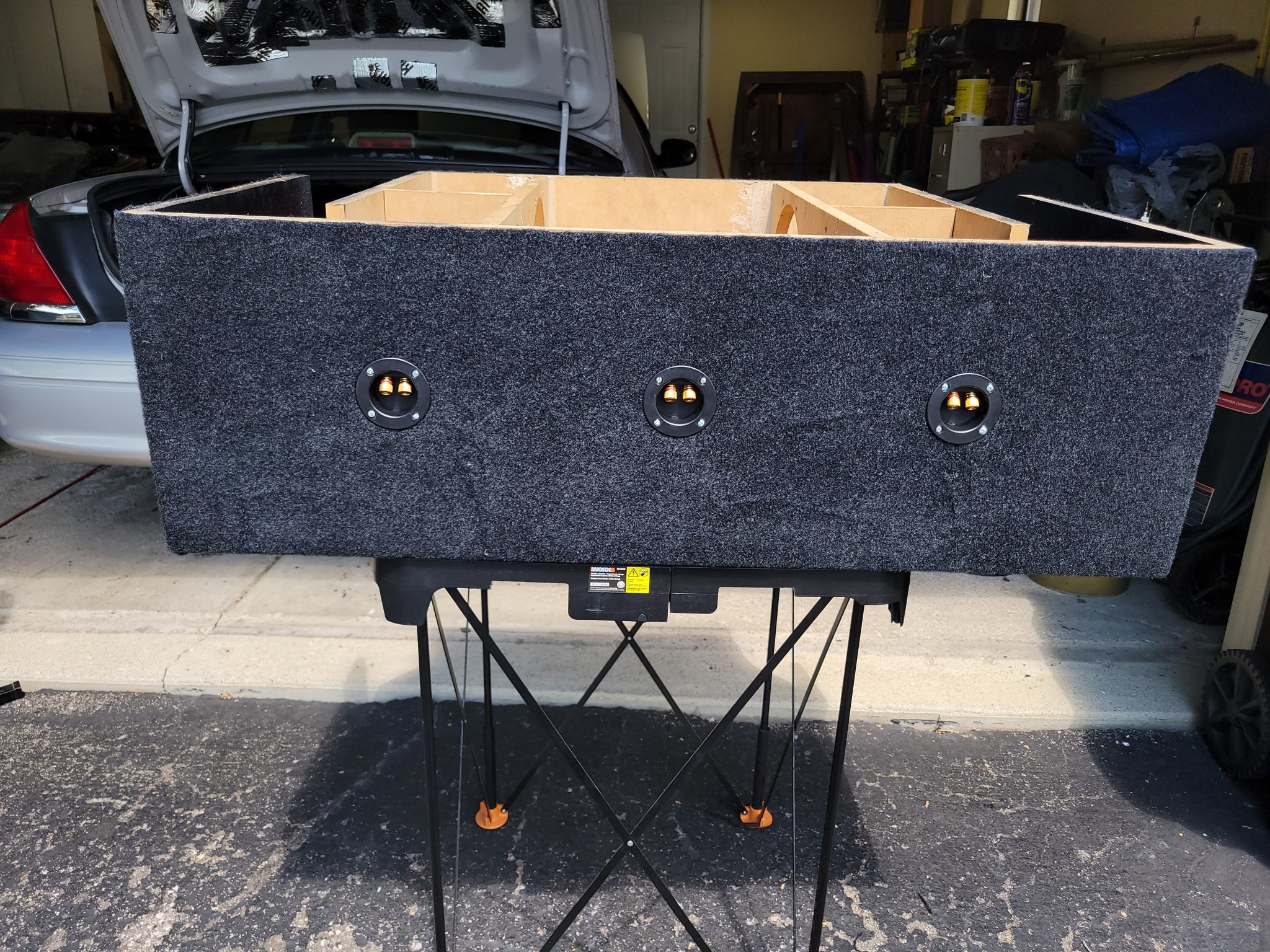

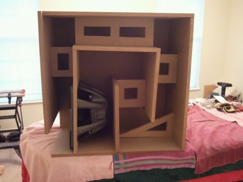

Dayum!!!!The gigantic tapped horn from hell is really pushing the limits .
( nearly an 8:1 compression ratio ) 😱

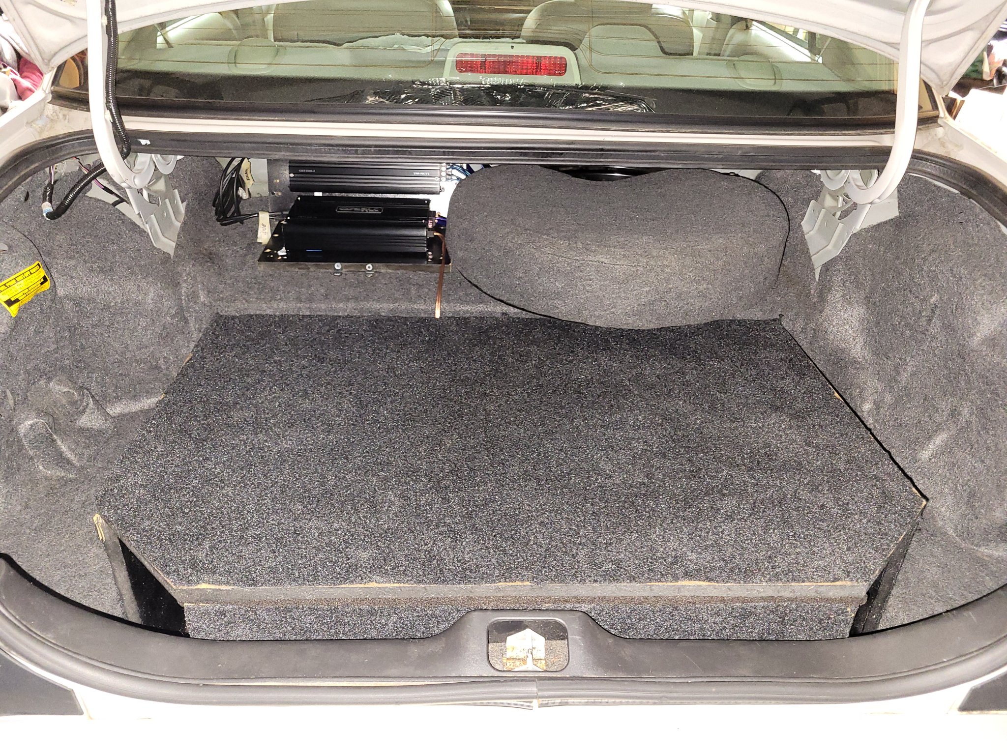

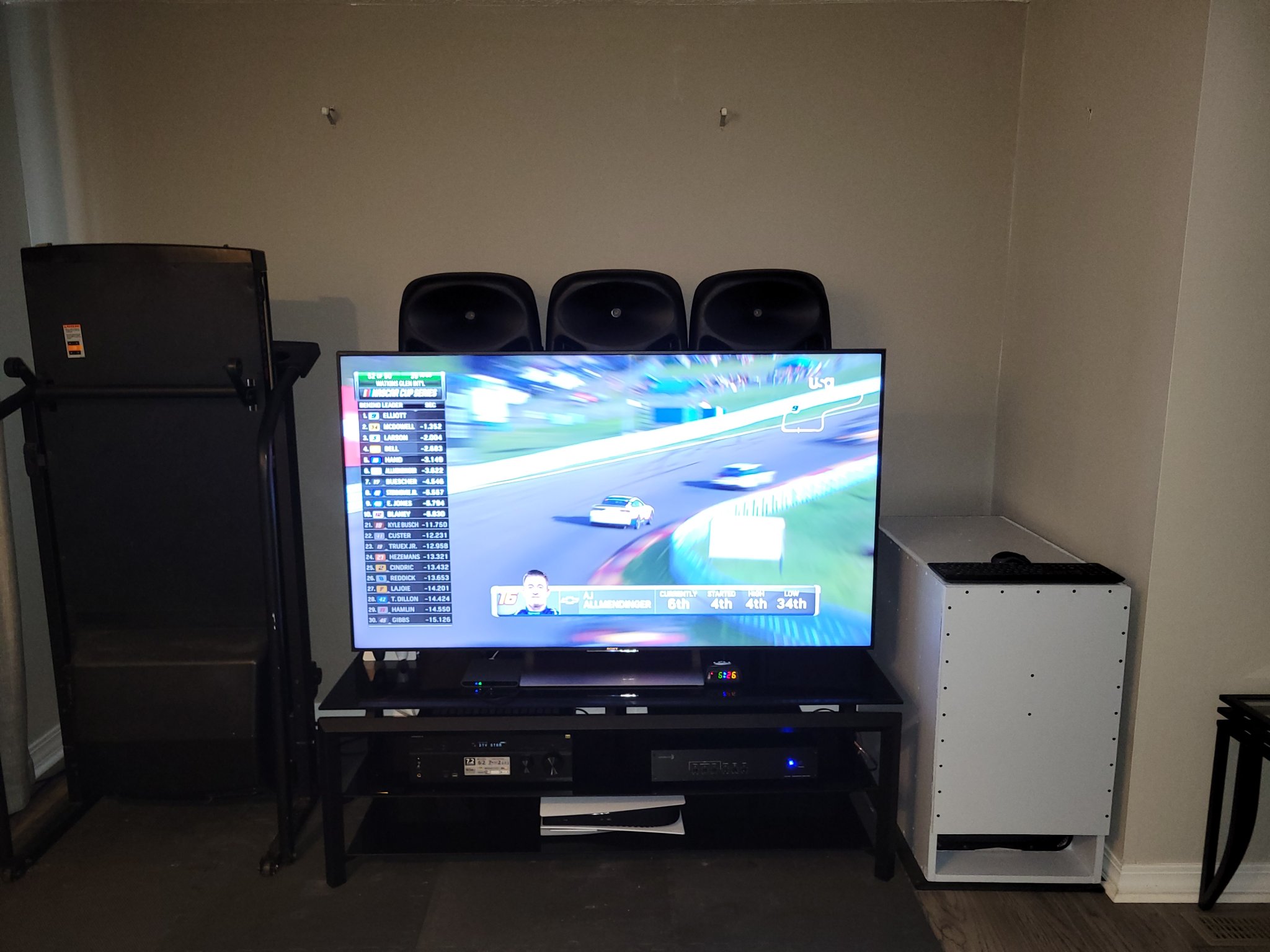

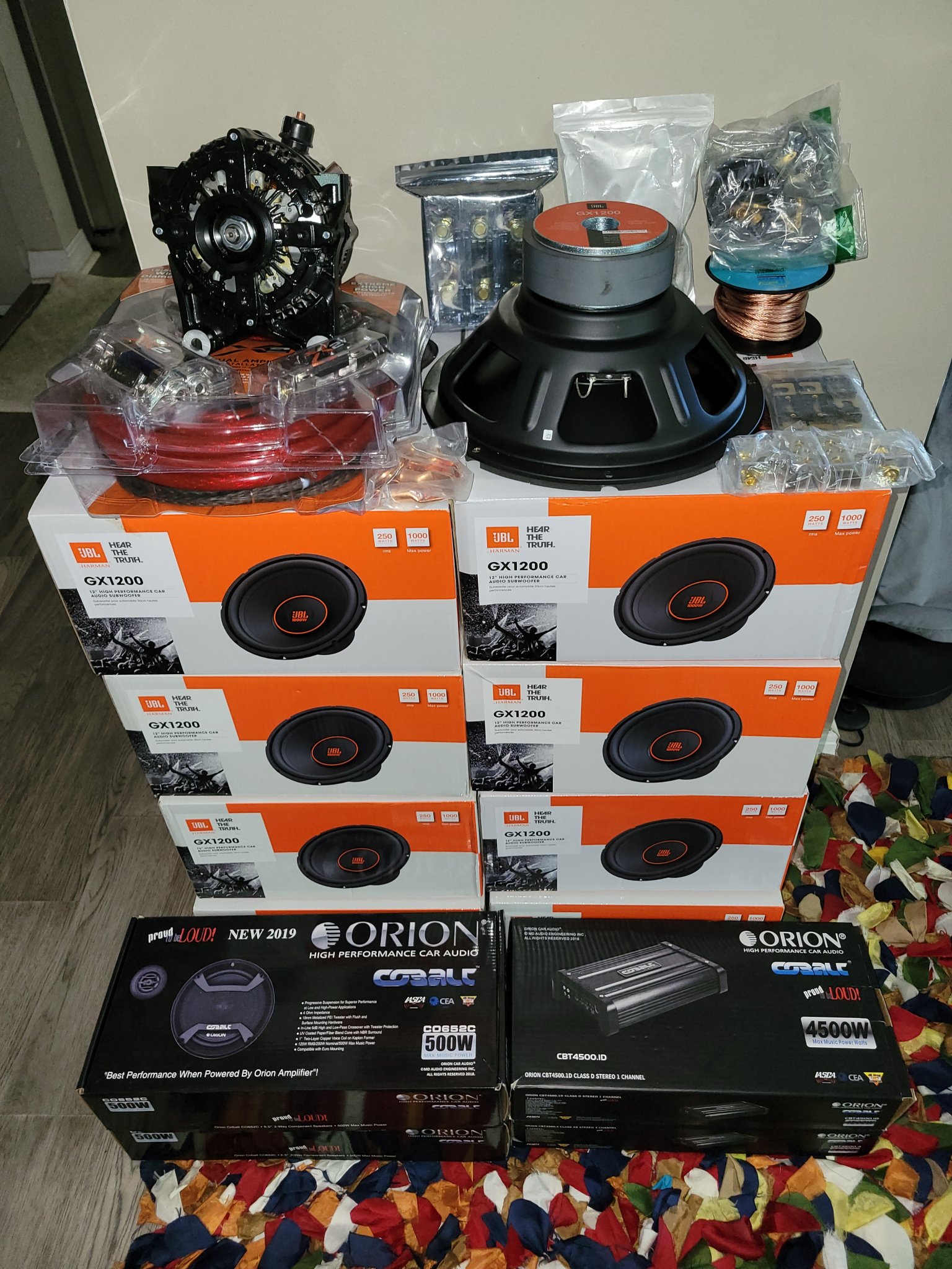

Not 4 x18 TH, but an isobaric 8 x 12 BP4. Just completed the install after 10pm last night. I'm volunteering for the African American Male Walk today and going to a car show afterwards. I have to be at the AAMW at 5am!

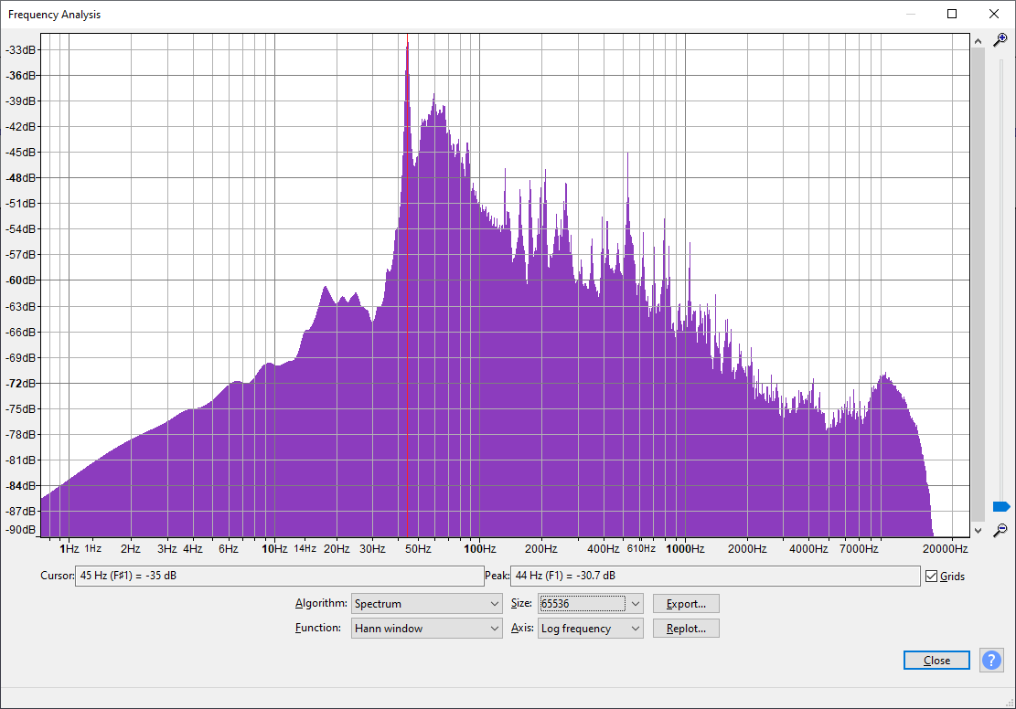

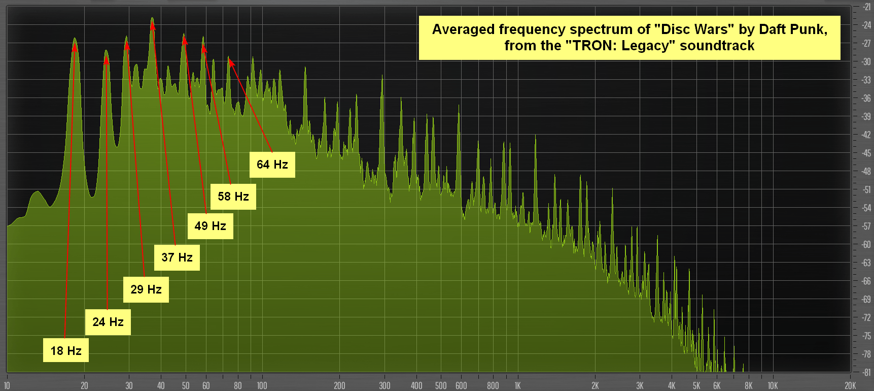

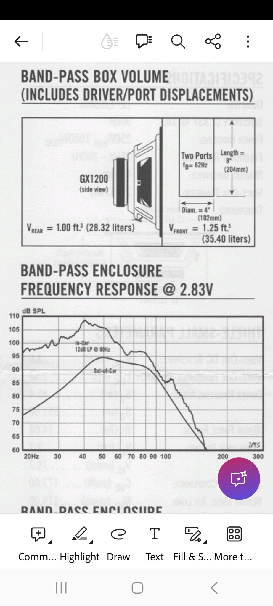

Using Audacity, the results of a spectrum analysis of the track referred to above are shown below. There is a dominant peak at about 44Hz, although there is still a lot of low-frequency energy between 52Hz and 70Hz. Based on the time domain waveform, the dominant kick drum sound is located around 60Hz, and there is a narrow peak located at that frequency in the spectral response.That dry short non-boomy thup thup thup acoustic kick from the dub track and its electronic version here (ignore the overlaid synth bass notes on the kick where that happens) ... Even at very low volumes, this kick travels a long way at night and through neighbours walls.
If there are concerns about low-frequency sounds travelling a long way, then I guess it might be best to avoid playing "Disc Wars" by Daft Punk, from the "TRON: Legacy" soundtrack. Of course, that would also depend on the bass extension afforded by the subwoofer. The frequency analysis indicates that there are large peaks in the response located at 18Hz, 24Hz, 29Hz, 37Hz, 58Hz, and 64Hz.

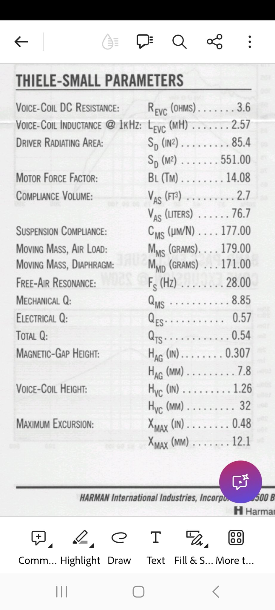

Guys, BP1Fanatic's iso made me reflect on the pro mobile sub drivers again. A long time ago Kicker starting using the marketing name Solobaric for their range of the newly emerging pro mobile drivers in the car and HT/studio
So let's say we place a pair of well spec'ed sub drivers such as the SBA that I am looking at for use as a bench sub. This is just generalising, so a pair in isobaric with all the pros and cons of the system. How different the response would be if the magnets and coils from both drivers were fitted to one chassis and the cone for this new chassis about twice as heavy and the suspension increased in stiffness to emulate the isobaric suspension performance?
Did Kicker actually correctly identify and categorise the emerging driver style by correctly calling attention to a real attempt to emulate isobaric performance from a single driver?
Would it be fair to further speculate that with this new hypothetical chassis, the doubled up coils make for a thermal handling gain and power to driver a further excursion. And that the new, stronger suspension controls this increased excursion by just being there? And then wildly speculate that unlike the isobaric system, adapting the hardware to a single chassis actually effectively eliminates the one drawback of dropping efficiency with the isobaric system and instead deliver a net gain with doubled power and excursion?

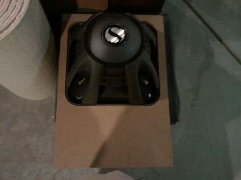

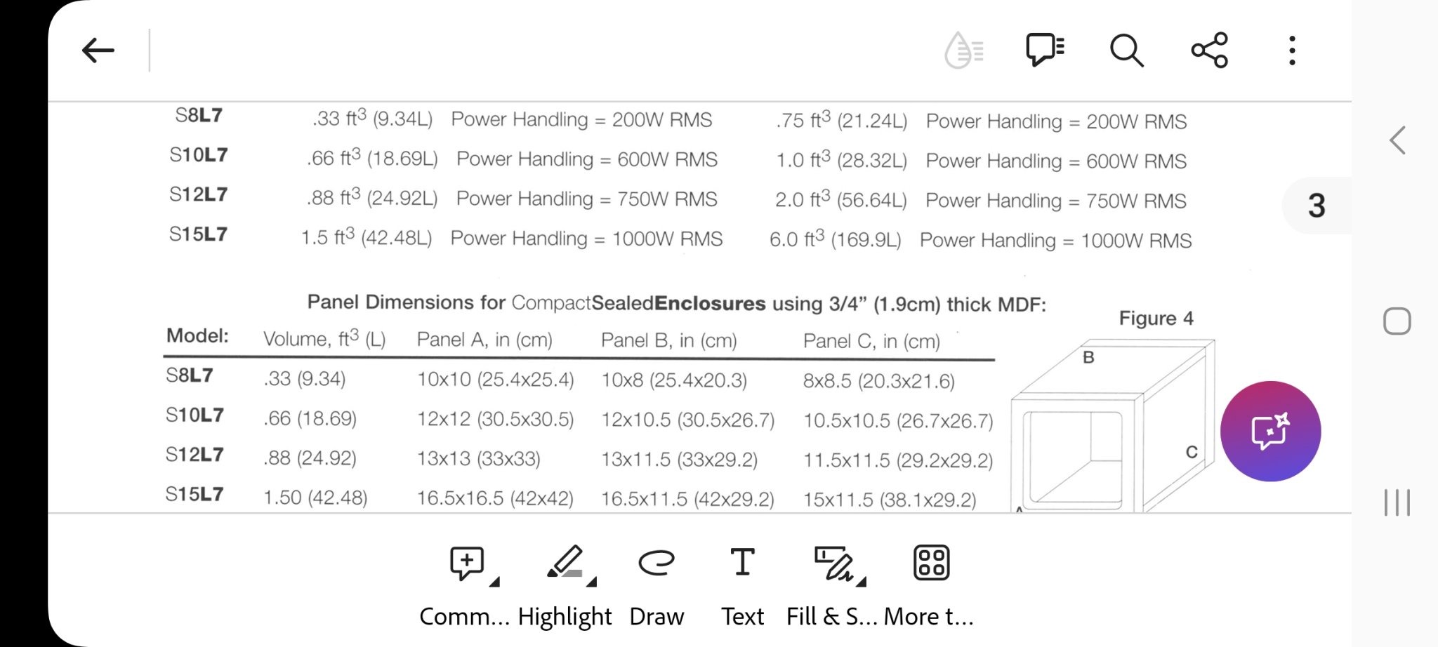

No, the reason behind the name solobaric was just that they had developed a new motor that was strong enough for the subs to be used with higher amounts of moving mass successfully in small sealed airspaces. Their marketing at the time was that you only needed one of their subs for a given airspace for what you would normally (at the time) need a pair of clamshell isobaric subs to work in the same airspace. Nothing more, just a strong motor with more moving mass.Did Kicker actually correctly identify and categorise the emerging driver style by correctly calling attention to a real attempt to emulate isobaric performance from a single driver?
So no to doubling up the magnets and coils and cone weight into a single chassis and calling it a solo attempt at isobaric performance? Because they just made a stronger magnet with more moving mass? How do they make a stronger motor without increasing magnets and coil? How do they increase moving mass without increasing the former, coil and cone material or thickness?No, the reason behind the name solobaric was just that they had developed a new motor that was strong enough for the subs to be used with higher amounts of moving mass successfully in small sealed airspaces. Their marketing at the time was that you only needed one of their subs for a given airspace for what you would normally (at the time) need a pair of clamshell isobaric subs to work in the same airspace. Nothing more, just a strong motor with more moving mass.

Lighter cones are not always the goal, you need heavy mms for any subwooer that is expected to play in small sealed airspace.
The design wasn't to try and emulate an isobaric pair of subs, strong motors and heavy moving mass is just what you need to have for small sealed subwoofers regardless. It's part of hoffman's iron law. They did not design the subs to replicate anything isobaric, they designed them specifically to work in small sealed. Isobaric pairs were just how people got around the limitations of the weak subwoofers at the time. The original solobarics were launched in the mid 90's and were still round.The weird thing is that when someone tries to make a stronger speaker they increase the motor strength and performance as well as aim for a lighter, stiffer and stronger cone. But by your own remark that they are increasing moving mass must mean that they are not doing the lighter cone part as normal but rather going the other way so really are doing something different and trying to emulate the moving mass of the clamshell driver

They did not design the solobaric line around a pair of isobaric subwoofers. They designed them just as a subwoofer to work well in a small sealed enclosure.
Kicker just used the name as marketing, nothing more. It was "Hey, now you can have a 12" in a small sealed box without having to buy two of them". As much as you want isobaric pairs to have been their design target, it wasn't.
