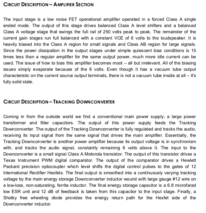

Is this class h? If I remember the datasheet from a high end systems builder who supplies the modules to Logitech, the z623 uses both class h and I or something and embedded fixed DSP. I always feel that there is much greater power peaks then the 140wrms rating for the sub channel. Reviews are always limited to the person's ability to benchmark, but this is one of the better ones by someone who seems to know what they are doing"Tracking Downconverter"

Class H amplifiers modulate the supply voltage to the amplifier output devices so that it is never higher than necessary to support the signal swing.Is this class h?
Bob Carver's "Tracking Downconverter" circuit description sounds similar to that:
Class D amps are now more efficient, weigh and cost less than class H.
Many are also showing as slightly under the certified and uncertified power tests results when tested for dynamic power on the SMD amp dynoClass D amps are now more efficient, weigh and cost less than class H.

The other lil thing that I raised was what I noticed re Bob Carver's mentions of back EMF with these types of drivers.....I don't feel I have come across this being explored and further studied. The motor structure of these drivers are significant, it may pay not to brush off this aspect either
