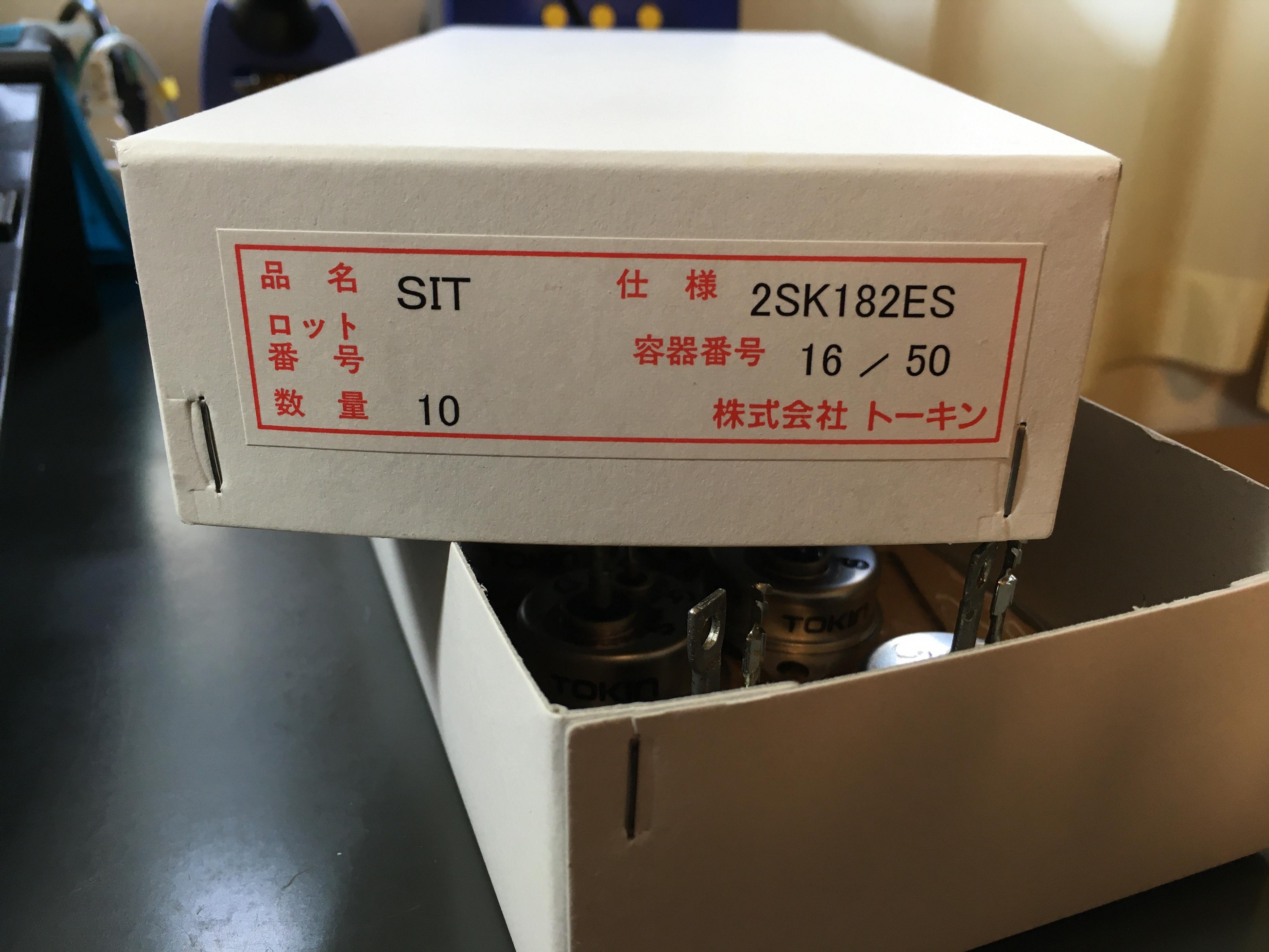

anyone reading Japanese, to check what's written on original box labels ......
Hi, from Japan
I also have 10 TOKINs in the original box.
All of these have sequential numbers(1Z1612 - 1Z1621).
The label on the box says:
Specifications: 2SK182ES
Lot number: -blank-
Container number: 16/50
Quantity: 10
TOKIN Corporation
I haven't tested these yet, so I'm not sure about matching.

Your mobile phone ....“Translator” application or Google’s application. .... even picture from your PC screen.
Several hoop-jumps later:
From on-PC picture in post #630:
Product name SIT Specifications 2SK182ES
Container number 16/50
Lot number
Quantity 10
Tokin Corporation
Just as yoshida says.
