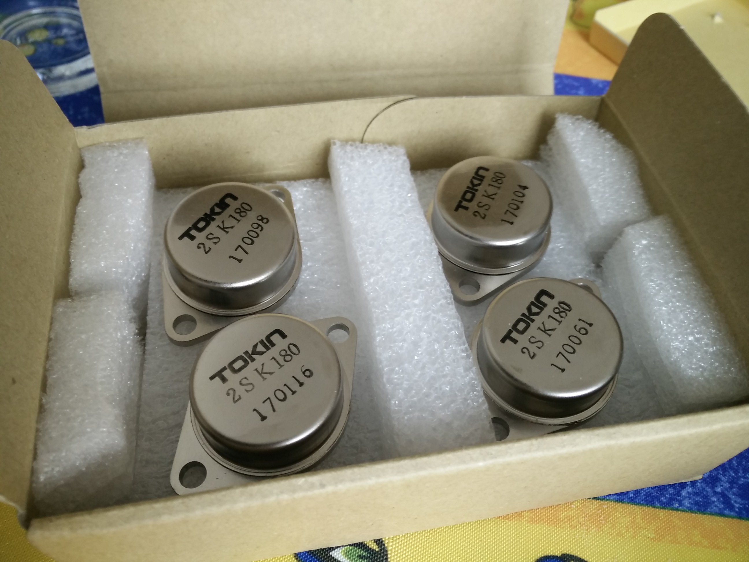

I am curious if the recent quads I got from watanabetomoaki are anything like other 2SK180s I have, which are really close to the 2SK77s. Might have to dust of the old Tex curve tracer....
watanabetomoaki references the 2sk77s in his listings. I did ask if the 2sk180s he is selling as precisely matched quads are suitable replacements for the 2sk77s and I did not get a response, so I am prepared for the worse....
It would be expected that you can see better matches with Vgs for parts with same lot codes.
Just got from Tomo as "rough matched quad (without data)". When I asked he said that it means "similar Vgs at Vds = 50V, Id = 0.5A".
Looking forward to test them by myself when I am back at the desk in few weeks.

I was told he can not guarantee how precisely matched because "preciseness" is not really quantitative. Then I got eight pcs of "matched" 182ES from him last year. I have not fully traced them, but all of them are very well matched (for me) at several different voltage / current points measured.
So how important is matching for any of the designs. I was looking at the price differential between matched and unmatched. If matching it’s a big deal then I will just get some of the unmatched ones. I was looking at the Tokin ones from Japan.

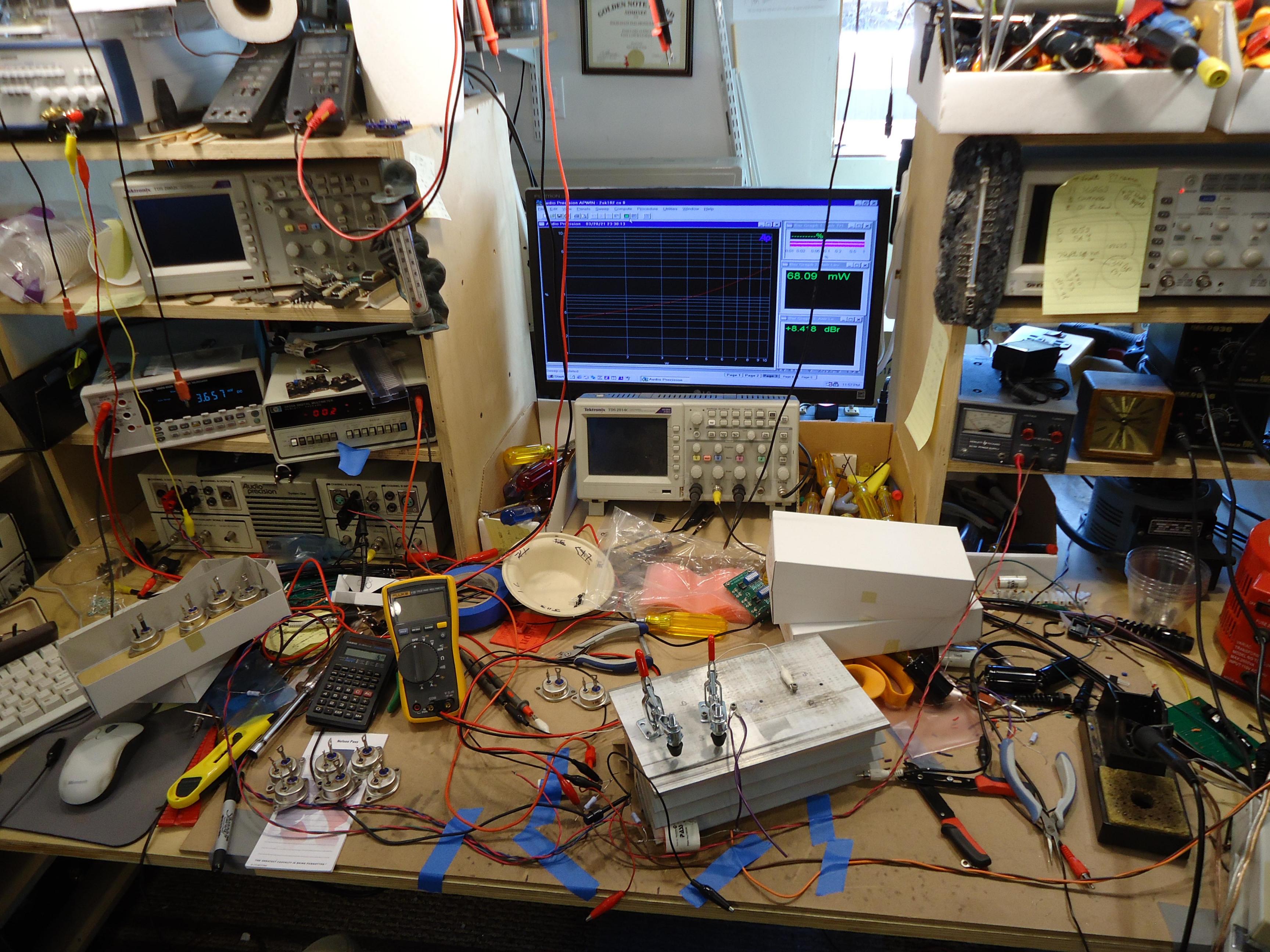

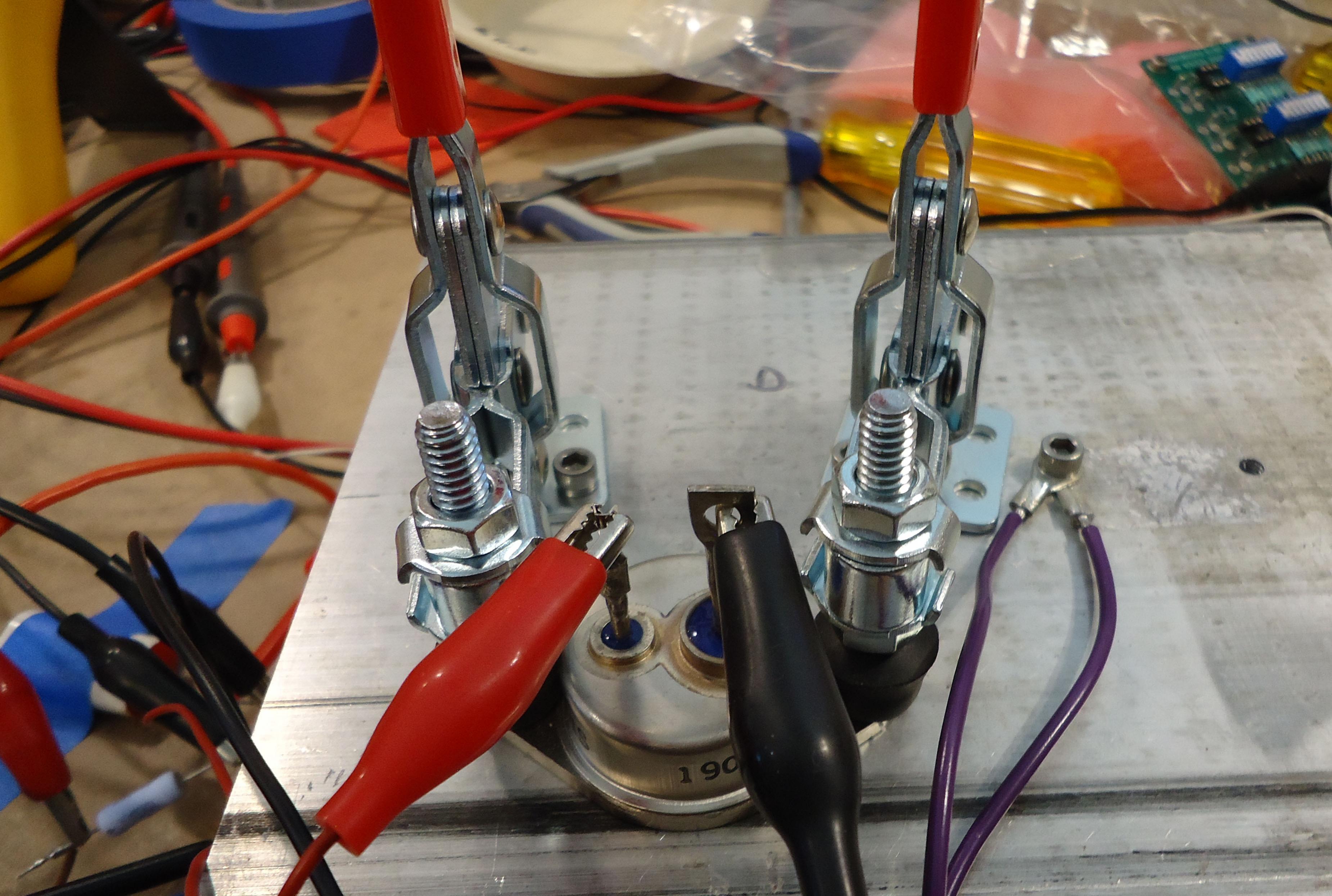

So I spent most of today testing a population of 2SK182es and THF51s,
in a setup which was Common Source mode (Grounded Source, input on
Gate, Output from Drain) loaded into 8 ohms which is then attached to
a +50V supply. It is run without feedback, the Gate is driven directly by
the AP analyzer with a variable DC bias.
This would be an arrangement designed to magnify the differences
in gain and distortion.
Two lot codes of each were tested with sequential serial numbers.
The bias was adjusted for the lowest THD at 1 watt, which is the point
where the 2nd harmonic is nulled, and data and a distortion curve from
1 watt to 10 watts was taken at that bias point.
For THF51s the Vgs values ranged from -4.7 to -2.8V and Vds point was
36 to 40V. Distortion figures for 1w were from .15% to .25% and 10 watt
from 1.7% to .25%
For 2SK182es the Vgs values ranged from -5.4 to -3.3V and the Vds was
from 32 to 43V. Distortion figures for 1w were from .3% to .5% and 10
watt from 2% to 4.3%
The result is that there is a reasonable correlation between Vgs and
performance within a lot code, and not so much outside, but this is the
worst case scenario - Common Source without degeneration.
All the parts were good, and the Gate leakage was about 5 uA.
For those of you who have matched parts or sequential serial #'s on
the parts, you are probably in good shape. If not, don't get excited,
because everyone will have to make some adjustments for optimal
performance in any case (once you decide what that means...)
I know you like some porn with your posts, so here's a photo of the
bench today and the test rig.
:snail:
Reactions: Mikerodrig27
