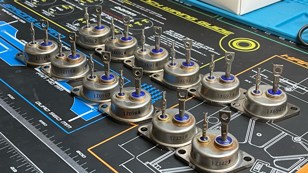

On my Tokin THF-51S devices I can find the following numbers:
  • 1X5906
  • 1X5914
  • 1X5946
  • 1X5971
I am just curios as I did not find any information on this in the data sheets or in the web. Does anybody know if this is a lot code (maybe related to the production run or date) or a individual serial number?
Looks really like individual serial numbers (not the lot code as I posted before), I have running numbers 1x59xx too. One could hope that they are from the same chip, even from the same area on the chip ...
AlexRivera curve traced six THF-51S, purchased as unmatched, and got one perfectly matched quad and well matched pair.
https://www.diyaudio.com/forums/pass-labs/368651-while-they-last-42.html#post6588207
You can notice that serial numbers are very close (1X69xx):
https://www.diyaudio.com/forums/attachments/pass-labs/935931d1616775192-while-they-last-img_0890-jpg
nice!
I wish I knew they would be that close. I took the hit ($$$$) on a couple of already matched quads.

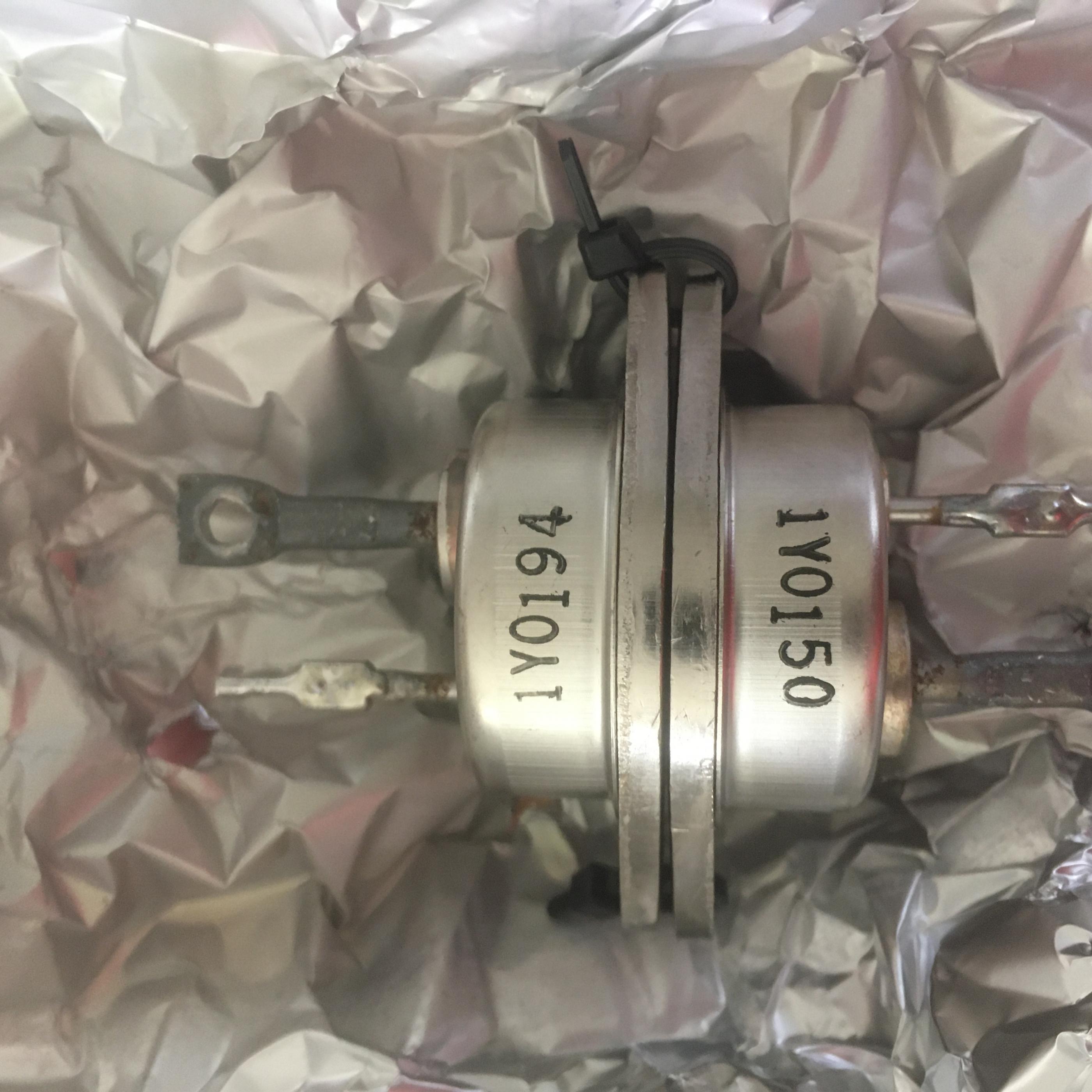

I have not built a NP design or SIT amp, but I was very curious before the VFET lottery was announced, was excited to hear of it and joined but was not one of the chosen. I bought a "roughly matched" quad of THF-51S that I will stow away until this mystery project is announced. If it doesn't come to Pass (no pun intended) I will start from scratch. Thought I would make the investment while I still can, not cheap but surely less than I have paid for NOS tubes.
Thanks for the tip, Mr. Pass.
My roughly matched pair

nice!
The pair that I got years ago are very nicely matched as are the K180 quad I got back then which is why more recently I bought a box for 20 more; out of that 20 I found 6 that barely met Tokin's K180 data sheet unlike my earlier quad which could easily be sub'ed for K77's in a B-1.
