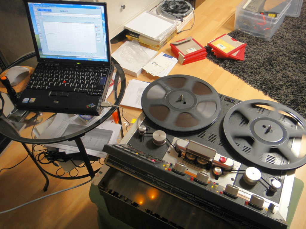

Schmitz77: "There is some tooling thats missing actually, for example in the Studer manual they show a tool for quick alignment of the complete headblock and such a tool I have to go for manufacturing one,"
Are you referring to the "tape path alignment gauge" (part # 10.010.001.16) as shown in the manual in Section 3/35? I would certainly like to have one of these--are they still available? I can't see how you could manufacture one unless you had an original to copy; even then tolerances would have to be really tight.
I was refering to the clay head gauge (part # xxxxxxxxx.17) on section 3/34. This is necessary for the adjustment of perpendicular play and record heads and adjusting of their correct height. But the part # xxxxxxx.16 tool will be of good use, too.
I'm no Studer expert, just an amateur user. You should ask Studer service center for availability of those gauges. But I would expect them to be expensive.
I have the perfectly aligned Studer headblock so I can measure the height and dimensions for heads- tool contact area. Otherwise its just a question of a newly manufactured tool with tight tolerances. The tolerances of the tool would have to be the same as with the compact cassette alignment gauges. I would say thats the reference for tolerance. And a good metal workshop will be able to manufacture such a unit without question. Show them the reference pic, give them dimensions and tolerances and they will do. I expect the original Studer tooling to be long out of production and supply.

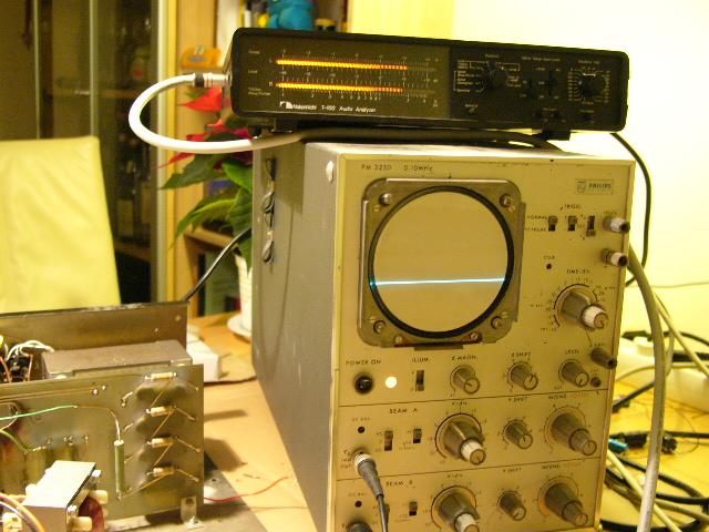

I wonder whats that for a type and model of audio analyzer laying on the carpet though.
Still have my old Nak T-100...
