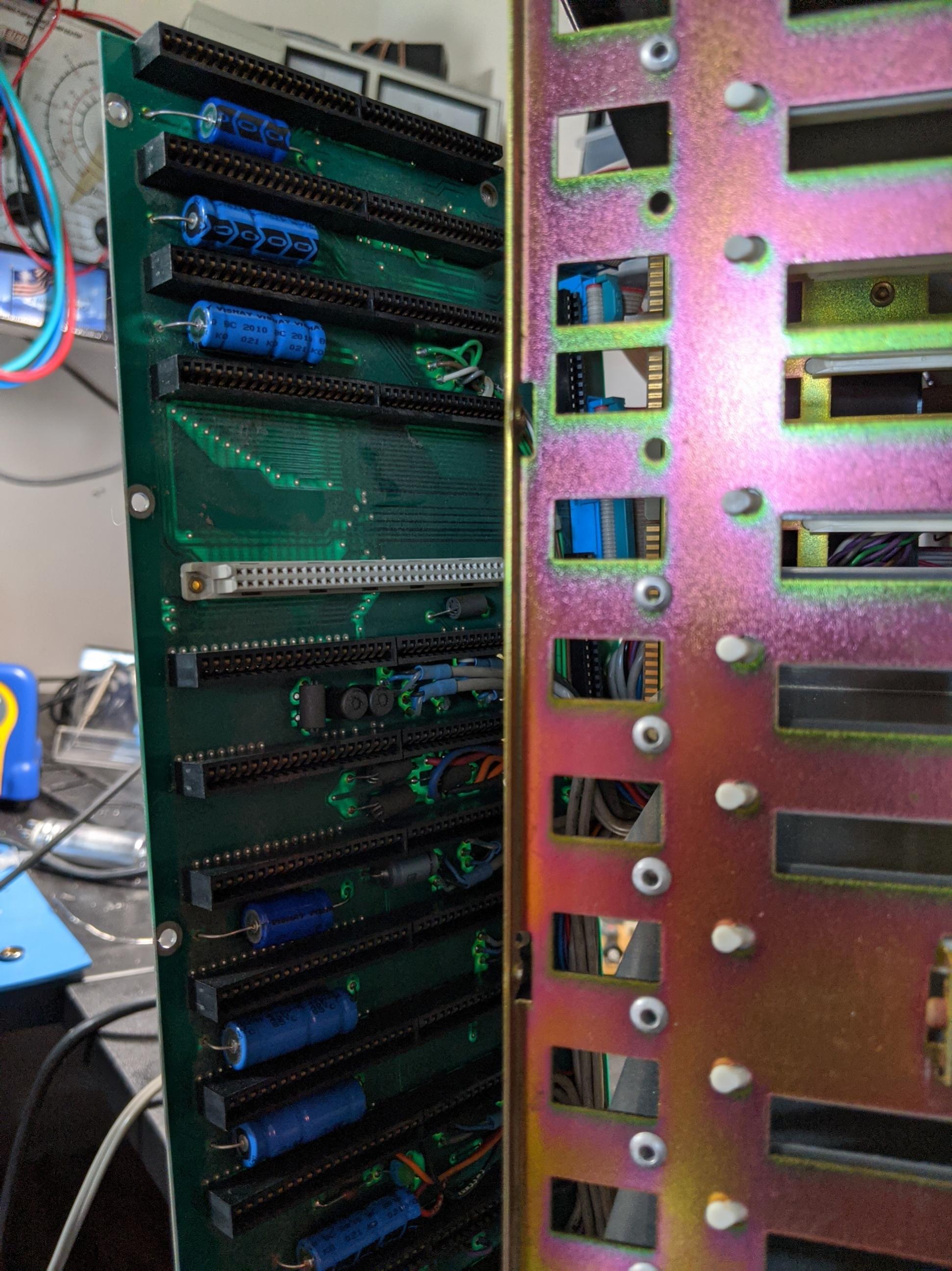

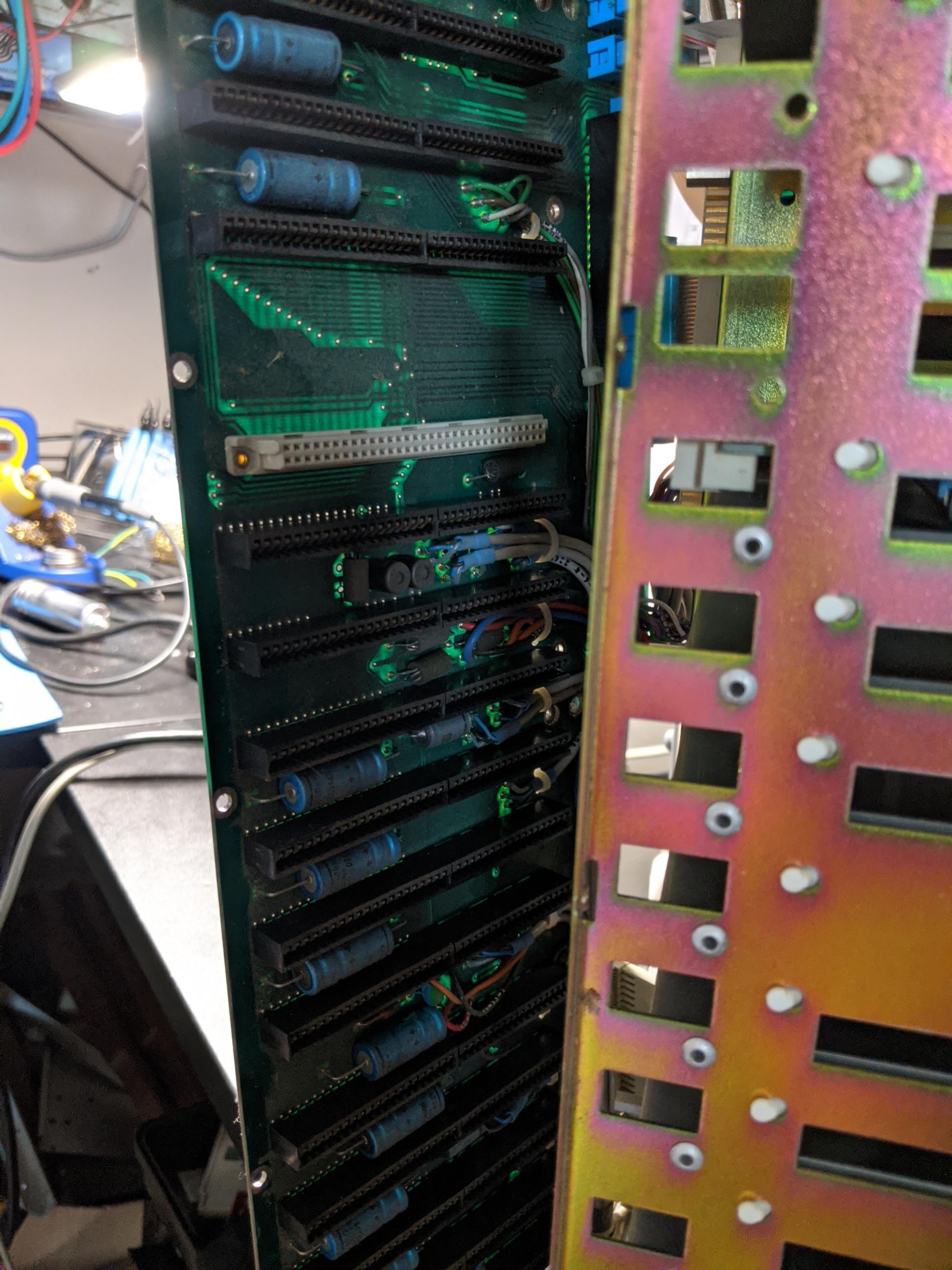

Why are you wanting to change the basis board? The only issue that it ever causes is from the caps going bad on it and short/drag a rail down with it. Change out the 13 axial electrolytic caps and it will be fine.

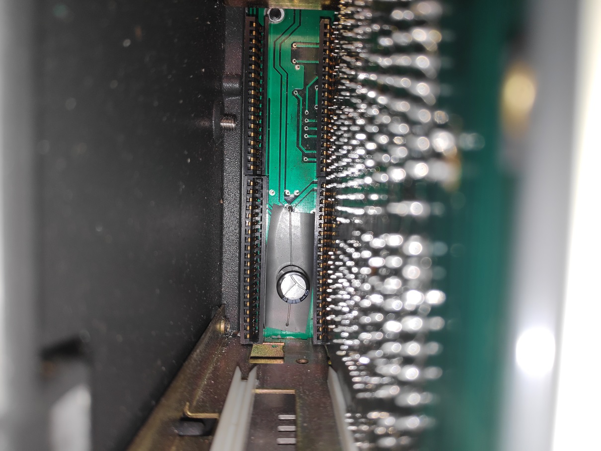

Caps on that board were changed to radial ones and I don't like that, because it was done in a non professional way and I like my machine to be in original condition with original parts.
Boards changed in 1984, my original one is 1983 version. There are minor changes in parts, so the boards aren't interchangeable I think.
Have to change motor and PSU caps first, they aren't bad but one is Frako and its good to have a completely new recapped deck. And spooling is too slow.
If the radials bother you change them out to axial. For recapping first do the transport cards as there are RIFA and Frakos on the spooling and capstan boards. There are a couple on the stabilizer board also. If you are looking to keep everything original looking Kemet makes original style motor and PS filter caps that are stud mounted. Not cheap though. Get the transport working perfectly then move on to the audio cards.

This deck has a recap already and I paid substantial money for that.
I knew that someone will tell that its totally uninterestingly how something has been repaired, but to that I have my own thinking.
Will change those to axials like its stated in the manual.

Yes, the machine did cost some heavily amount of money. Studers are so sought after and rare today. Love it.
And thats what it should look like, exactly.
