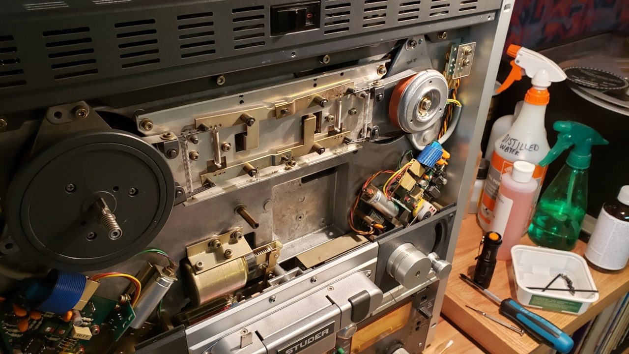

The machine had a new CPU backup battery and the last programm eproms 25/91 implanted (before it had the 13/83 software).
I have to search for what has been changed to non default values after the new parts have arrived and the machine is running again.
The things that went wrong with this "complete overhaul, repair and redone" job has proofed for me that I'm going to provide maintenance, overhaul and repair on this Studer A810 series machines from now on by myself. Good and trustworthy experts are rare, therefore expensive and most often not local available.
There is some tooling thats missing actually, for example in the Studer manual they show a tool for quick alignment of the complete headblock and such a tool I have to go for manufacturing one. The repairman had one and that was the main reason why I gave the machine for an overhaul to him. It was in need of new heads and in retrospective, this Studer was more dead than alive. From my Revox/ Studer tapedeck experiences I even was aware of the difference between a perfect deck and a nonperfect one. Because I wanted the Studer to perform on maximum, I let this job having done by an "expert" on this. Now that I'm aware of the know how to measure it perfectly, I'm going to do this myself.
From this perspective, it was worth the experience.
