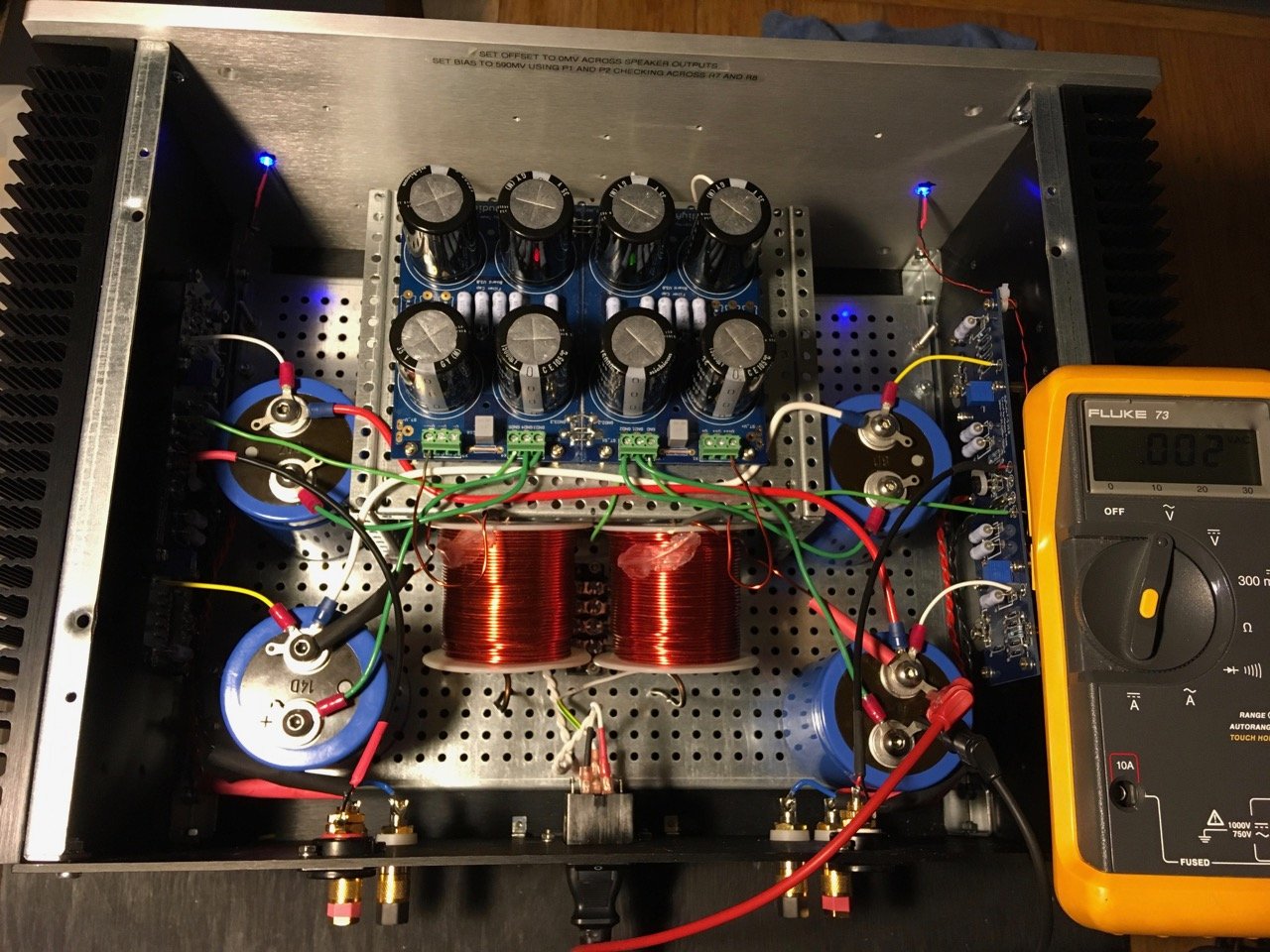

F5 with tons of caps and CLC to get the ripple to 2mV (and P3 adjusted for minimum distortion)
