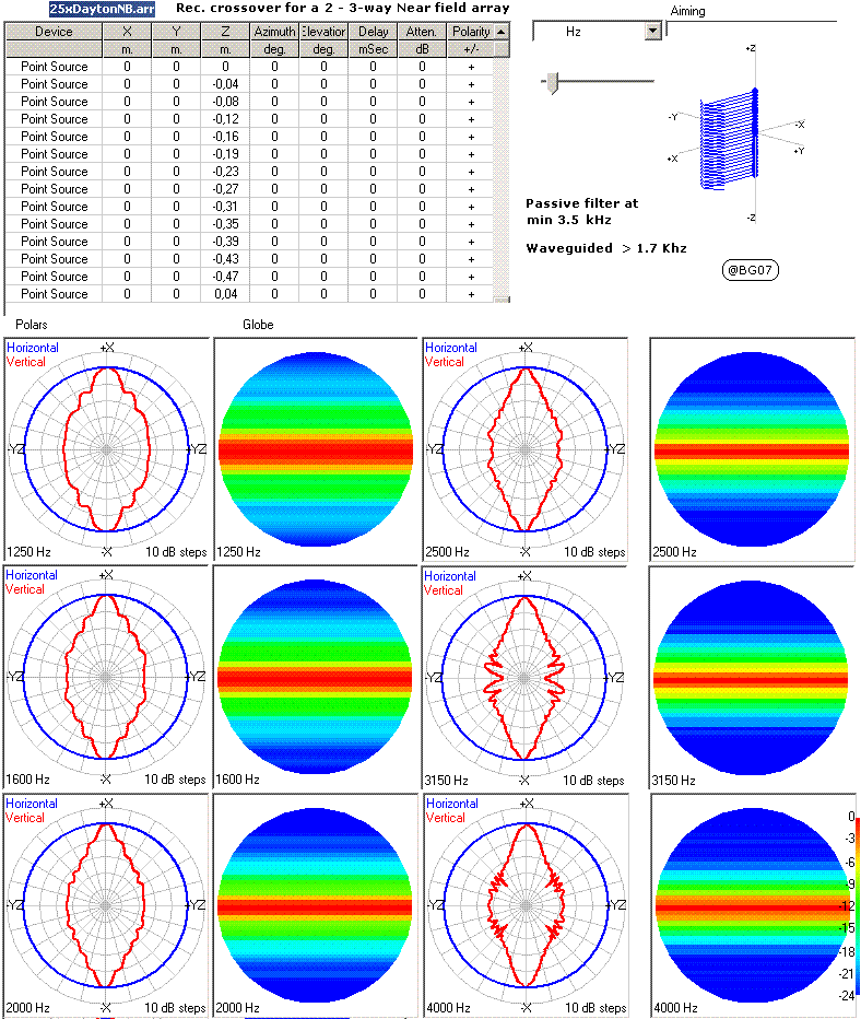

I have now made up my mind for a line array! (at least for now, or until someone gives me a better idea)
I will go for the RILA bass/mid drivers mentioned earlier, in sealed boxes, or perhaps aperiodic vented. I hope these with their rather low Fs (40Hz) will go deep enough to do without any subwoofer.
For tweeters, I'm determined to build a 1m long magnetostatic ribbon tweeter! (or perhaps take the easy way out and import "1m length" of the Dayton tweeters.)
with 130 mm C-C woofer distance, the crossover frequency should be kept below 2580 Hz, which shouldn't be any problem with the ribbon, might be a problem with the Dayton tweeters?
I'm going to give simple passive filters a try.
Any comments?

Magnus,
The first two drivers you brought up in your post #15 are members of the lowest quality scale of drivers you can find in Sweden.
The data given for those drivers are sold with the sole purpose to be incomplete (advertised year after year) and with non-consistent data when compared to the other sales information given, thus very misleading and in my opinion should be avoided.
You should be very suspicious when reading the catalogue specification for the Rila speakers as all the different types are advertised exactly 40,50,60 W, but one have a sensitivity of 89 dB/1m and the fs are exactly 40, 50, 60, 70, 80, or 90 Hz. and no other T/S data.
The only conclusion you should make is that all the specifications are faked.
My proof for this statement is by an example. Take Rila RW 4005 with the following catalogue minimized specification: 4” 40 W 6-Ohm paper cone bass driver with sensitivity of 89 dB/SPL and fs= 80 Hz. and compare with picture at:
http://www.diyaudio.com/forums/attachment.php?postid=1102554&stamp=1168387560
I found no numbers to be correct besides the 6-Ohm nominal impedance value!
The Rila 5048’s could work as W-drivers in an OB array but I suspect a closed box about >= 10 L/driver is needed even for an aperiodic type with a LF cut-off near 100 Hz.

Since I would like to (at least at first) get away with a 2-way array without subwoofer, I am looking at 5,25" drivers. The problem gets quite clear when reading James R. Griffin's excellent paper; With a woofer spacing of 130 mm, maximum crossover frequency should be 2580 Hz to avoid cancellations. To get up to 3000 Hz my calculations say max. 112 mm woofer spacing... (hard to obtain with 5,25" drivers)
So, what do you think. What would be worse? Using a crossover frequency well below 3000, or using a 130 mm woofer distance with 3000 Hz crossover frequency? I am aware that neither would be optimal, but perhaps acceptable?

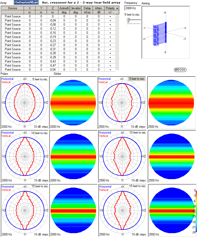

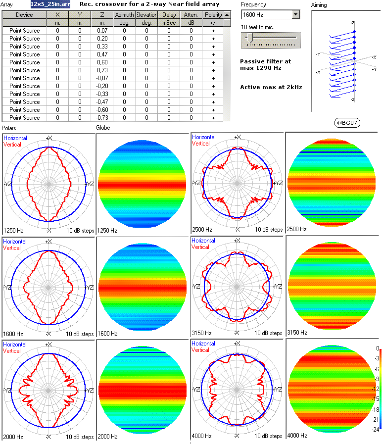

The size of this driver is 13.5 cm# and you mentioned to use it up to 2580 Hz.
Using Jim Griffins paper and the rec. c-c= lambda/2 criteria for this driver you get: 344/(2x0.135) =1274 Hz to crossover to a tweeter line with ordinary 12 dB filters.
Look the first submitted picture1(8), no filter can suppress the severe loobing at twice the frequency, about 2548 Hz.
But if you can live with severe off axis loobing/bad integration, huge crossover dips (even peaks) by using T drivers cutting off higher than 3 kHz you could of course try the same crossover at 2x 1274 = 2548 Hz with or just ignore any W crossover and superimpose the T dispersion on the W driver as it would be of a flat performing FR of WR type without any filter and hope for the best, even if the main lobe now are loobing at random and pointing at an angle not perpendicular to the baffle.
If this Nearfield line array consists of 2.4 m x 70% / 0.135=12.44 = 12 W-drivers, the possible in room low cut-off frequency will be at about f = 1 / (9 x 2.4x70%) = 66 Hz but only if the array is equipped with mid bass drivers that in the reality can exceed this frequency in an enclosure, not an upper bass driver like the Rila 5048 driver resembles at most.
Again, if you still hope for the best and ignore the side effects like the deep lower-mid-bass LF dip that comes with placing the arrays close to the room corners, now a necessity if you still believe the Rila 5048 could somewhat extend to the low bass octave beginning at 40 Hz but this wont happen as the line array guaranteed cut-off frequency is at 3x66 Hz = 198 Hz and 66 Hz with help from the mirrored room effect.
What you will gain with this set-up is some lower upper bass (160 down to 80 Hz), maybe some weak mid bass (40-80 Hz) but never the room filling low bass (20-40Hz) replacing the impression of a sub.
….For tweeters, I'm determined to build a 1m long magnetostatic ribbon tweeter! (or perhaps take the easy way out and import "1m length" of the Dayton tweeters.)
with 130 mm C-C woofer distance, the crossover frequency should be kept below 2580 Hz, which shouldn't be any problem with the ribbon, might be a problem with the Dayton tweeters? I'm going to give simple passive filters a try. Any comments?
A Dayton ND20FB with a simple 90-degree wave-guide that will work fine down and even below 2000 Hz.
See picture 8(8) or:
http://www.diyaudio.com/forums/attachment.php?postid=1194160&stamp=1177617133
No simple passive filter at 2548 Hz will suffice if using the Rila 5.25” driver as W+ M driver in a Near field line array, only a 3”driver would integrate easily with a horizontally wave guided Dayton ND20FB driver.
