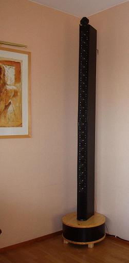

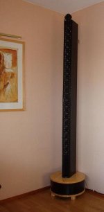

If anyone still remember my line arry project, here's some news! The "bass feet" are finished and installed!
As you can see in the pictures, I still use a single dome tweeter, temporarily mounted in the top of the array (not the best placement, I know).
The sealed bass cabinets are made out of very heavy duty glass fibre/epoxy tubes and pine woodboards. The 8" MGR woofers (MGR F-2008W) face downwards.
The speakers are "tri-amped", and a dcx2496 is used for filtering and level adjustments.
Despite all their questionable design solutions, I must say I'm very very satisfied with their sound so far!
Next stage will be the tweeters. Either DIY magnetostatic ribbons, or arrays of dome tweeters. I haven't decided... 🙄
