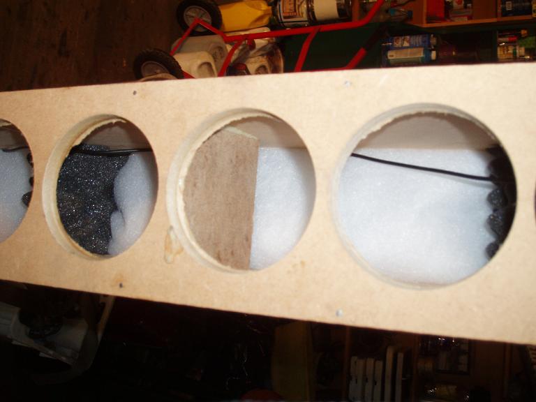

stuffing

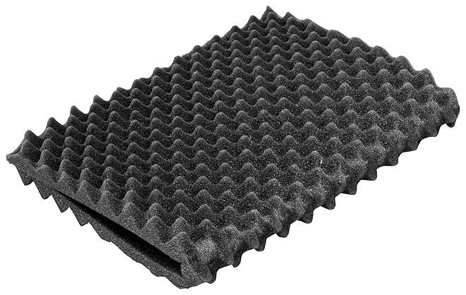

I glued the last sides of the cabinets today.
For dampening I have used a layer of "wavy" foam material (see pic) on the rear wall and one layer of 300g/m2 polyester wool in front of that. This leaves the backside of the front baffle and the front part of the side walls bare. Is this a bad thing?
I can still add a thin "carpet" to the side wall surfaces through he driver holes if necessary. (for instance pieces of IKEA's "Barrit" as Bjorno suggested)
Comments?
Comments?

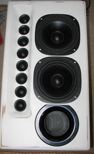

However, I just suggested that you could start with a small row of Dayton ND20 T drivers, Bessel aligned or not = straight, until you can afford to buy more of them instead of one large T driver that later have to be removed leaving a hole with the wrong dimensions.
A larger 4” T-driver narrows the important horizontal dispersion and adding stronger secondary lobes due to larger horizontal c-c distance when compared to my rec. of using 1.5” T-drivers.
(The main drawback when using a single T driver to mate an M array at a certain listening distance is the vertical off axis mismatch that only improves if an adequate wave-guide or a T-driver with restricted vertical dispersion is in use.)

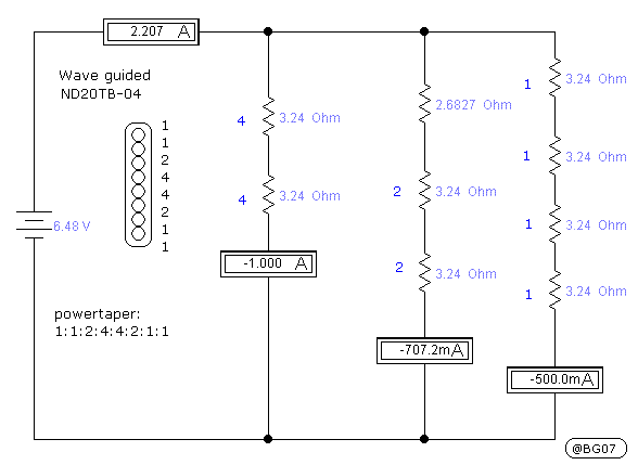

You could also choose a row of eight Dayton ND20: s power tapered or not, maybe in a wave guide similar to the new ‘presence speaker’ I just finish building for a friend of mine that is intended to be placed on each side between the mains and a center speaker:
http://www.diyaudio.com/forums/attachment.php?postid=1194269&stamp=1177625327&

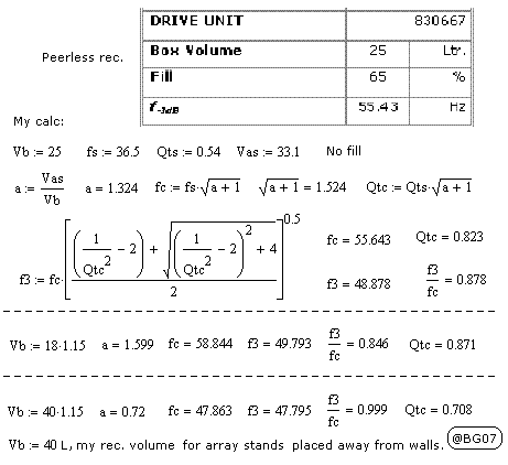

Presence speaker: 1(5): precence.jpg and the wiring schematic for tapering 2(5): 8xtaper-ND20.jpg.
See picture 3(5): Peerless_SLS 830667.GIF

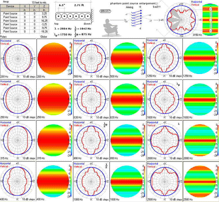

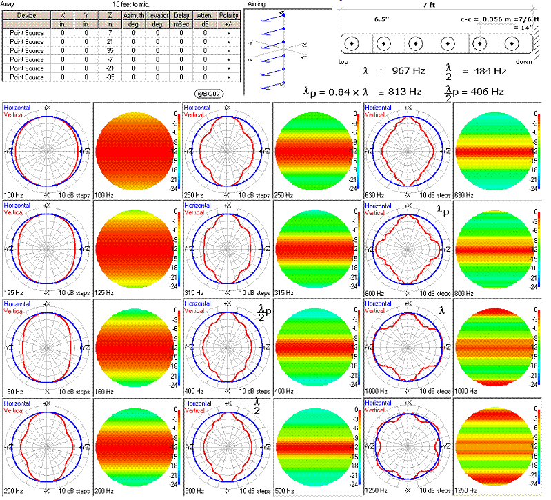

See pictures 4(5)-5(5) where dispersion plots of 7 6.5” drivers is shown as a consequence of inter driver c-c distances using the information given at:
http://www.diyaudio.com/forums/showthread.php?postid=1215500#post1215500
Opinions: Good array (2-way) performance can only be expected using the shown 2.71 ft array (or 12- 13 drivers for a 7 ft array) and a T line that is crossed over at 1 kHz 12 dB/octave or about 1.5 kHz 24 dB/octave.

Stuffing…I glued the last sides of the cabinets today. For dampening I have used a layer of "wavy" foam material (see pic) on the rear wall and one layer of 300g/m2 polyester wool in front of that. This leaves the backside of the front baffle and the front part of the side walls bare. Is this a bad thing?

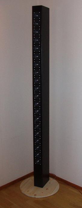

stage 1 finished
With all it's flaws, stage 1 is what I can call complete!
What surprises me is the stereo image and the detail of the sound. I am also positively surprised by both bass and treble extension.
I'm afraid I can't really hear any of the theoretical comb filtering which should take place from about 2500 Hz or something and up... Is there anything special to listen for?
Of course I will still try stage 2 and 3, a bass unit and either tweeter arrays or long band tweeters. Which one will be stage 2 and 3 respectively? I haven't decided...

The drivers are 20 in each speker, 3" Aurasound NS3 194 8E. More info about them can be found here:
http://www.madisound.com/catalog/product_info.php?products_id=729
They seem to be sold out for the moment...
The sealed enclosures are made out of 12mm MDF board, glued and nailed together, and are 2000x110x200 mm on the outside, giving an internal volume of 30 l.
The holes for the drivers were cut with a "hole-saw" giving exactly the right hole diameter for the drivers!
The drivers are placed with an 83mm c-c distance.
Despite all the good advice from people here, I did not part the enclosures into several smaller sealed units... There are dividing baffles though, (one between every two drivers) reaching a little past half way through the box. Every other sealed to the front baffle reaching back, and every other sealed to the rear baffle reaching towards the front baffle. (see the attached picture)
Some dampening material is placed against the rear baffle, both a wavy foam and a polyester wool.
In the end the enclosures were painted in semi-gloss black paint. Not very pretty I'm afraid. I sometimes overestimate my own skills in woodworking and painting...
I wired the drivers "straight". groups of 5 drivers are wired in parallell giving four 1.6 Ohm groups, which are wired in series into a total of 6.4 Ohm.
As I said I am impressed by their sound! But after todays listening I do think they can be improved by eliminating the "comb filtering", even if I really can't point my finger at what sounds "wrong".
