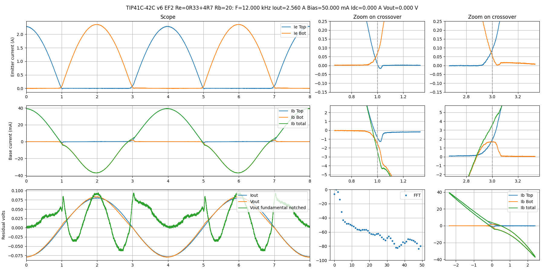

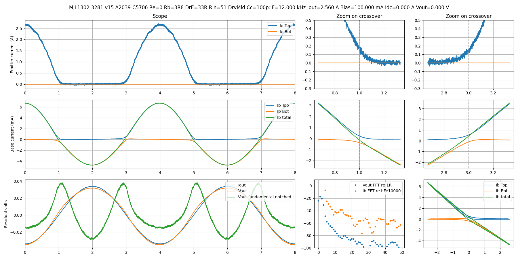

I dug into my plots. Here's an example worst case, TIP41C-42C.
ok... this will probably be hard to read, the labels are on the plots so look for them... but I just want to point to the middle row of plots which is the base current. At each crossover you can see a bump, that's the drivers trying to pull charge from the base of the power devices. The two small plots on the right are a zoom on both crossovers. The legends are missing, but they're the same as the plot on the left, base current of both transistors (orange,blue) and total base current (green).
Now compare with one of the best cases, which is the famous MJL transistors, with higher bias, no emitter resistors, etc. During the crossover, base current is very smooth, there is no spike, the drivers don't fight it trying to turn it off:
The residual is also much smoother. Second graph on the bottom row is the FFT of the output voltage, you can compare the harmonic spread between the two (in blue), the difference is quite striking.
This is not just the transistors being better, it's also the fast drivers, and the lack of emitter resistors means the class-A region is much wider at the same bias, so this gives the transistor much more time to turn off. Basically it turns off at a lower di/dt, much lower than its maximum, so it is smooth.
Another important feature is shown in the last plot on the bottom right. X axis is the output current, and Y axis is the base current for both transistors. Due to capacitance creating phase shift between voltage and current, the IV curves on a XY plot "open" like a Lissajous curve, with more capacitance they look more like an ellipse. No capacitance would be a straight line. The slope is 1/hFe. Blue is top transistor, orange is bottom transistor, so if you see a bend ini the curve it means their hFe don't match. What's important to notice here is the MJLs have the same input capacitance whether they're on or off, and it is well matched between the two devices. But the TIPs do not, when one transistor is off, its capacitance disappears, and when it is on, it is much higher than the MJLs. So at crossover, there is a big change in hFe between the two transistors, and also a big change in input capacitance.
The SanKens 3519/1386 look similar to the MJLs, but they're a bit faster on fT, so you can get some extra open loop bandwidth for more feedback. That's the main difference. Otherwise they're both excellent devices.
One interesting thing was the OnSemi vs Toshiba A1942/C5200. The OnSemi's were much worse, more charge storage, and nonlinear hFe with current. Toshibas were much cleaner. Also cheap. Good choice if you need a lot of them.
Now if you want "low bias class AB output stage with no or little crossover distortion" that depends what you mean by "low". Because at low bias current, you still get the drop in gm at zero output current, so you still get static crossover distortion. Without emitter resistors, crossover distortion becomes very low at 100mA bias and it completely ceases to exist at 200mA bias, which is definitely not "low" but still not a class A space heater by any means.

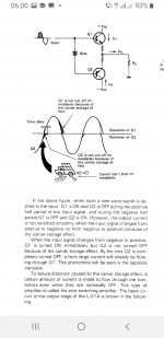

I usually use as linear and good transistors as 2SA1942 and 2SC5200 but they still have around 0,05% crossover distortion on all harmonics when they turn off.
That's about how they perform without feedback.
That is not what I would say free from crossover distortion.
0,05% is very much audible for harmonics of the 7th order and higher.
So I assume there are no transistors better than that for output stages.
In my case anyway since I do not like or use global feedback when cross over distortion is present at the output stage.

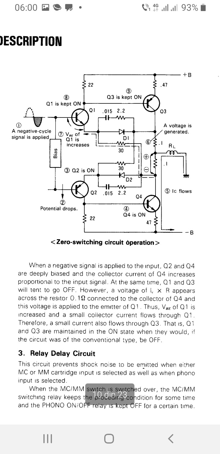

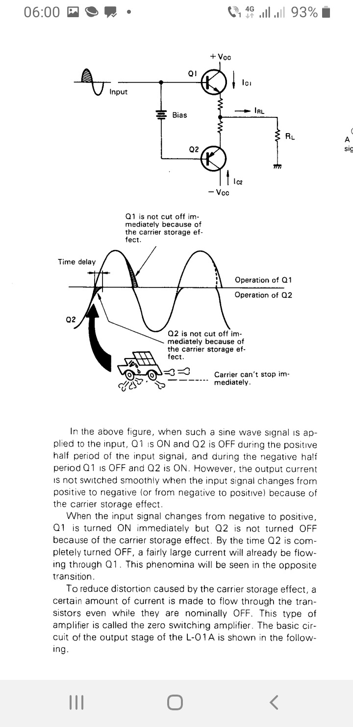

I had some hope that you had found something very special and unique that basically have no or very little crossover distortion without using high bias class A.
You are most likely right.Or perhaps it's the layout, as he says "the layout was the limiting factor".
"By the form of the oscillograms of the residual signal for both transistors, the breadboard resonances dominate, the difference is small, and is determined mainly by the difference in the capacitances of the transistors. A really high-quality output stage should not have "ringing", especially for several periods, transients when switching arms , there should be just small bumps against the background of "smooth" non-linearity, noticeable only under maximum load."
Ah, no it is not possible. At least 100mA bias is necessary to mostly get rid of it.I had some hope that you had found something very special and unique that basically have no or very little crossover distortion without using high bias class A.

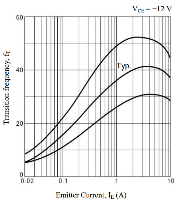

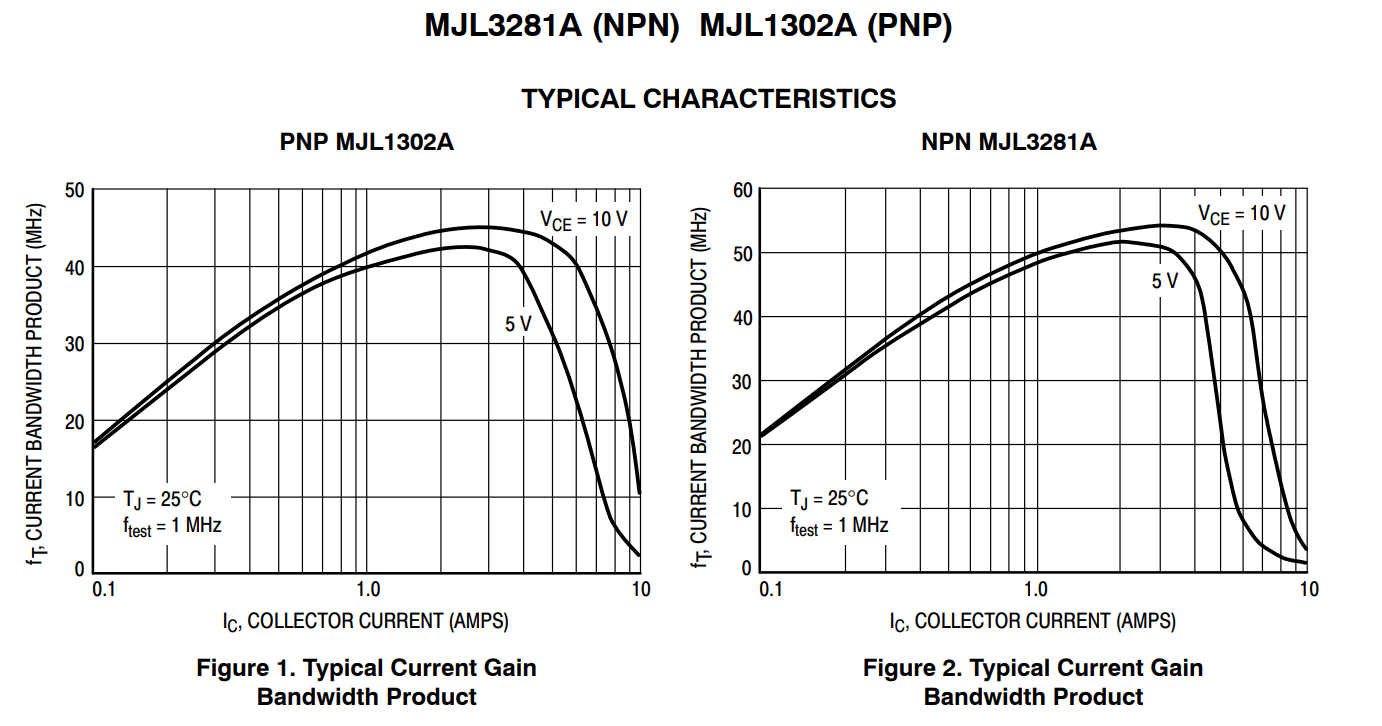

Now OP asked about "fastest transistors", it is necessary to look at the point where the transition frequency is lowest, so the amplifier can be made stable in the worst case. Usually this is at low Vce and high Ic.
Versus A1386

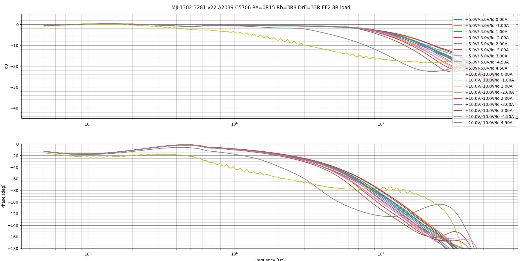

But SanKen measures at Vce=12V, they're cheating. It is too easy at 12V. We need the output to get much closer to the rail to not waste volts. 5V would be nice.
Last year I programmed it to step Vce and current and do network analyzer sweeps. Load is a resistor, there is an output inductor and a Zobel network in the output. 50R VNA output to drivers input.
Result: at Vce=5V, SanKen beats MJL.

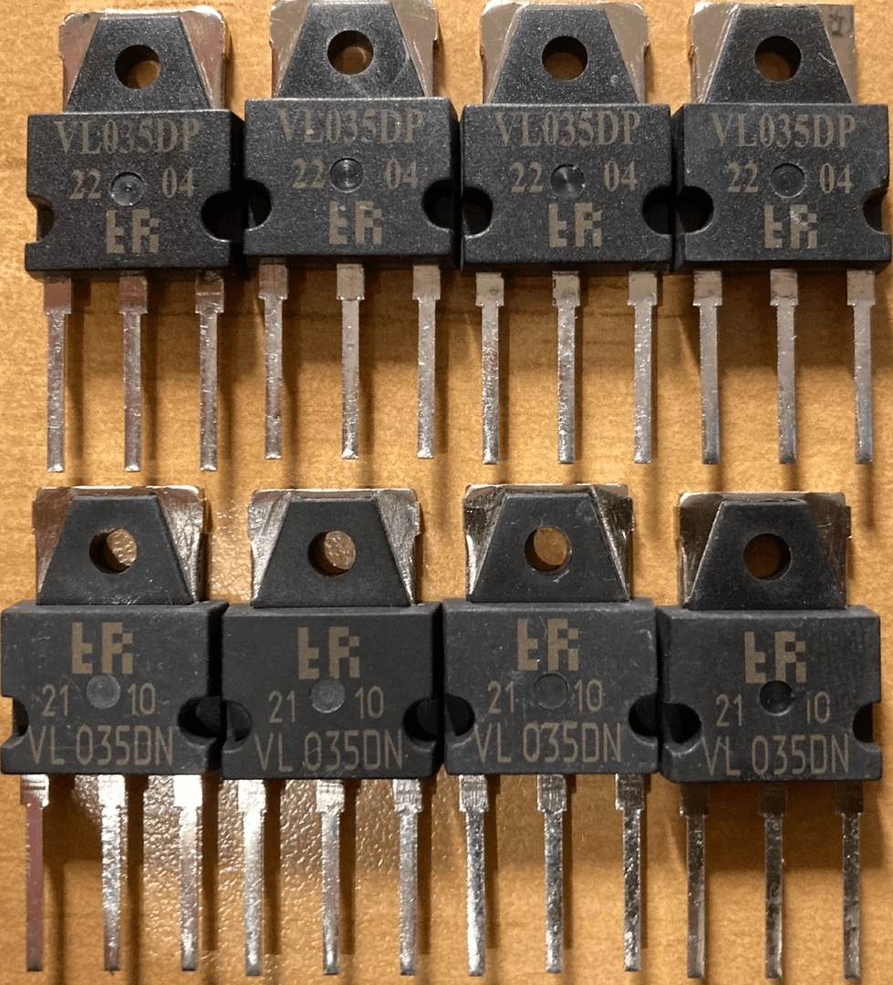

The Russians don't appear to think it is a Russian part... And in any case even if it's a fake there doesn't appear to be anywhere to buy it.
https://vk.com/wall-133622382_136200?lang=en

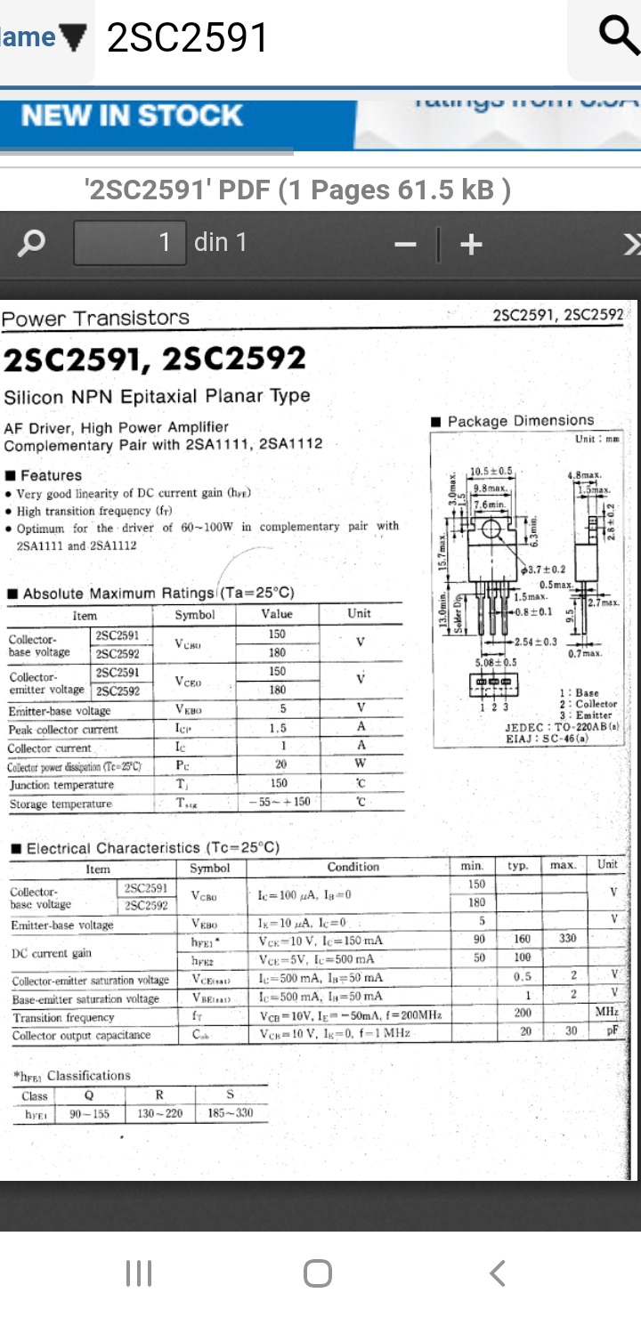

200mhz driver, 60mhz final, the fastest Szikai pair in the Universe 🙂Ah, no it is not possible. At least 100mA bias is necessary to mostly get rid of it.

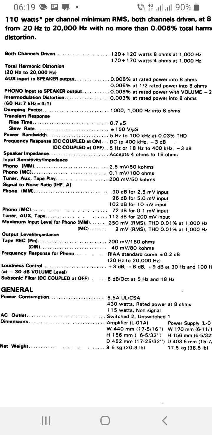

Nice data, thank you. Is IO positive the NPN and IO negative the PNP?Ah, no it is not possible. At least 100mA bias is necessary to mostly get rid of it.
Unfortunately that link only allows me to read a bit before being begged to register. Is the supposed manufacturer called LEFI? No hits on google for that being an actual company. Someone went to the trouble of making fake datasheets and fake physical parts? Pretty good mystery.
Just noticed that before translating, the original poster announcing the parts is "lefi" https://electronix.ru/forum/index.php?app=forums&module=forums&controller=topic&id=167670
Could be a trap, to mine your data.
Could be Chinese posing as Russians, which is going into mystery novel territory.

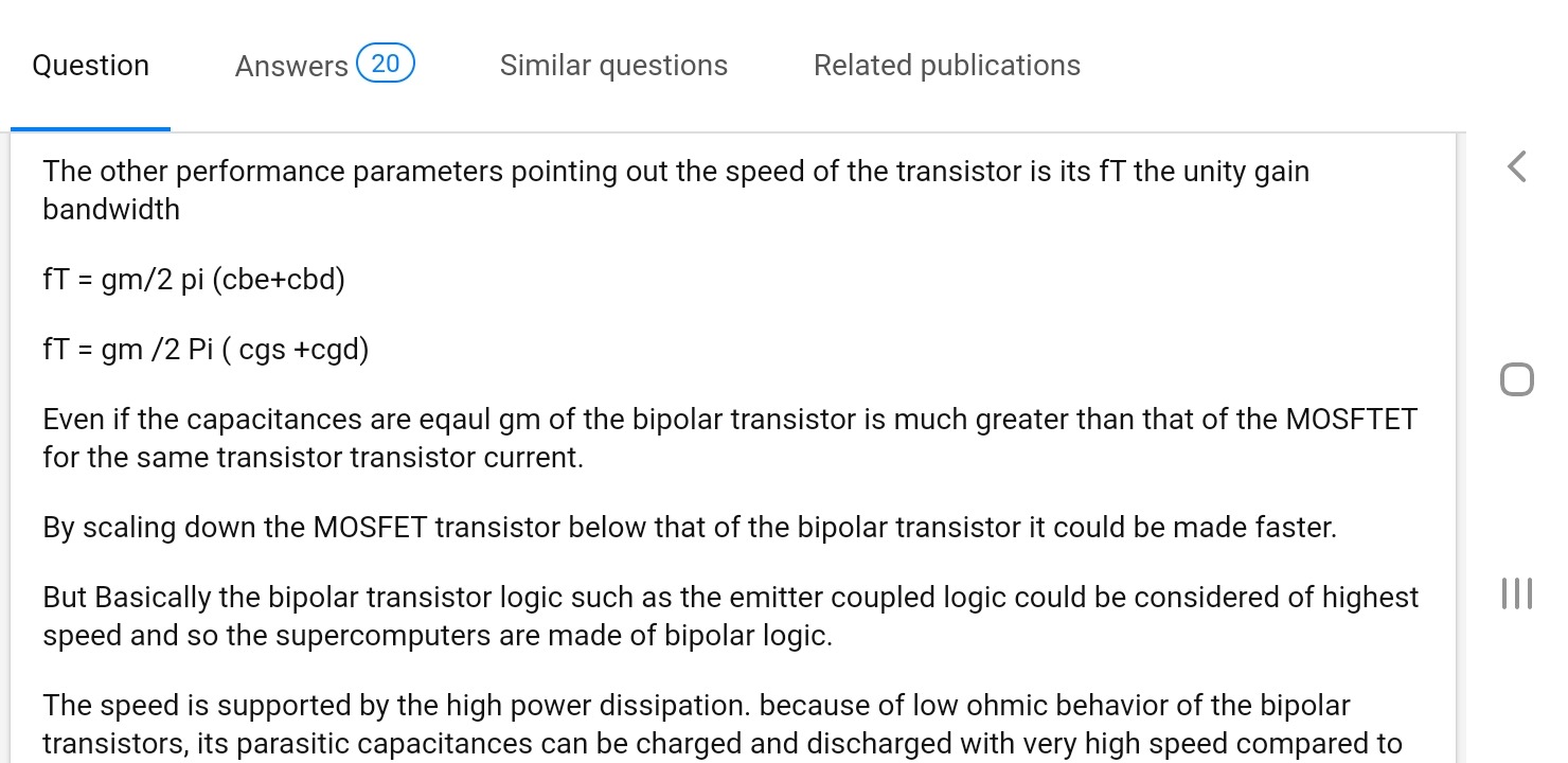

EOL 🙁Search to 2SC6145/2SA2223 ( Digikey ) like a Dan D'Agostino !

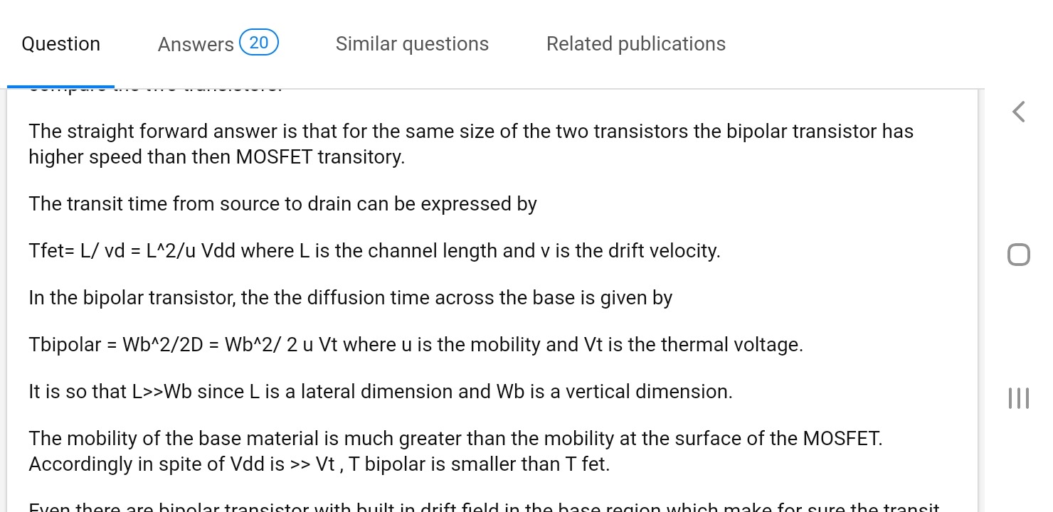

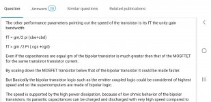

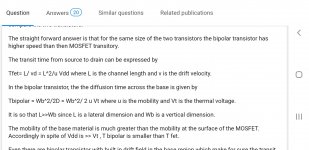

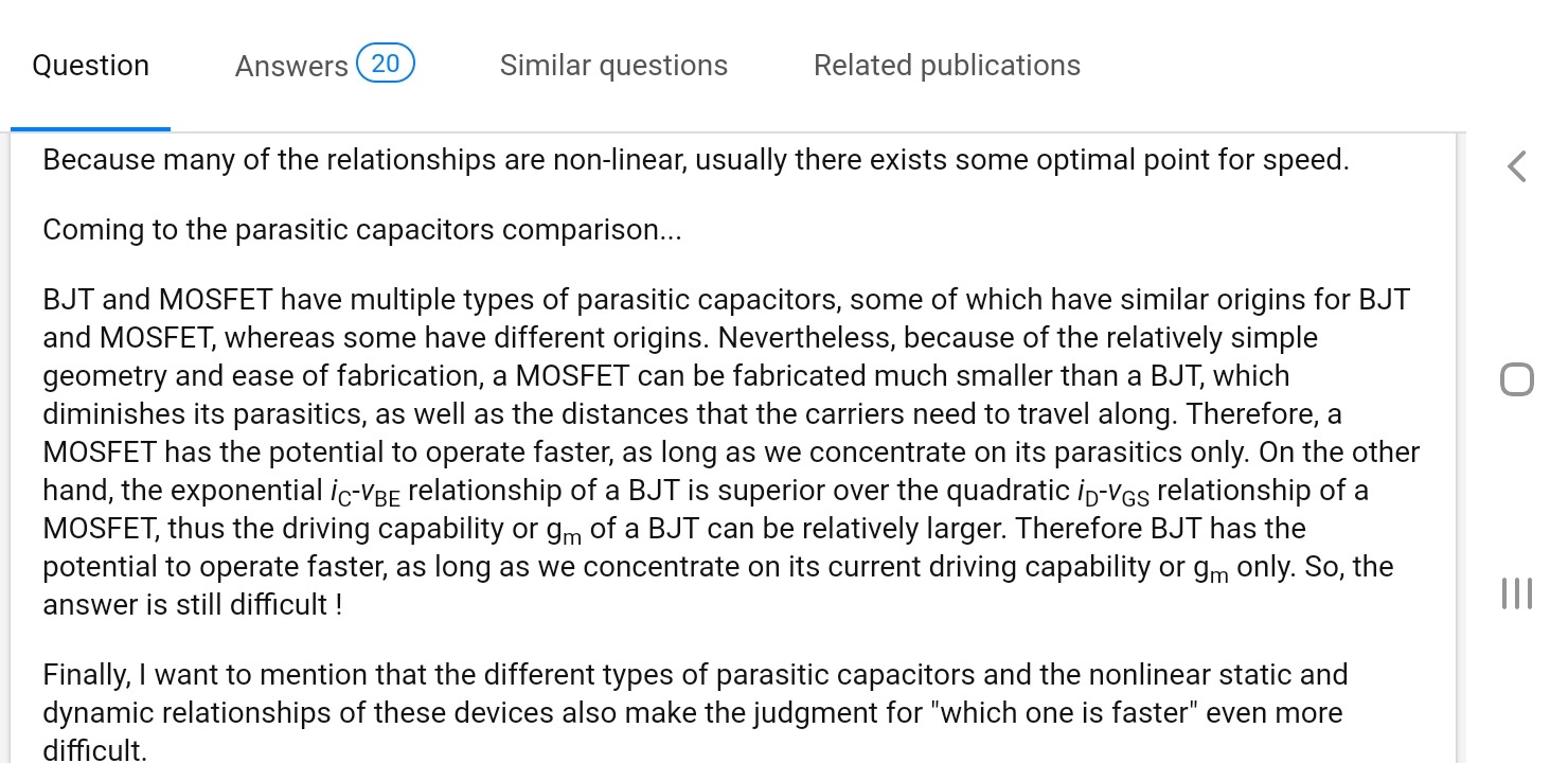

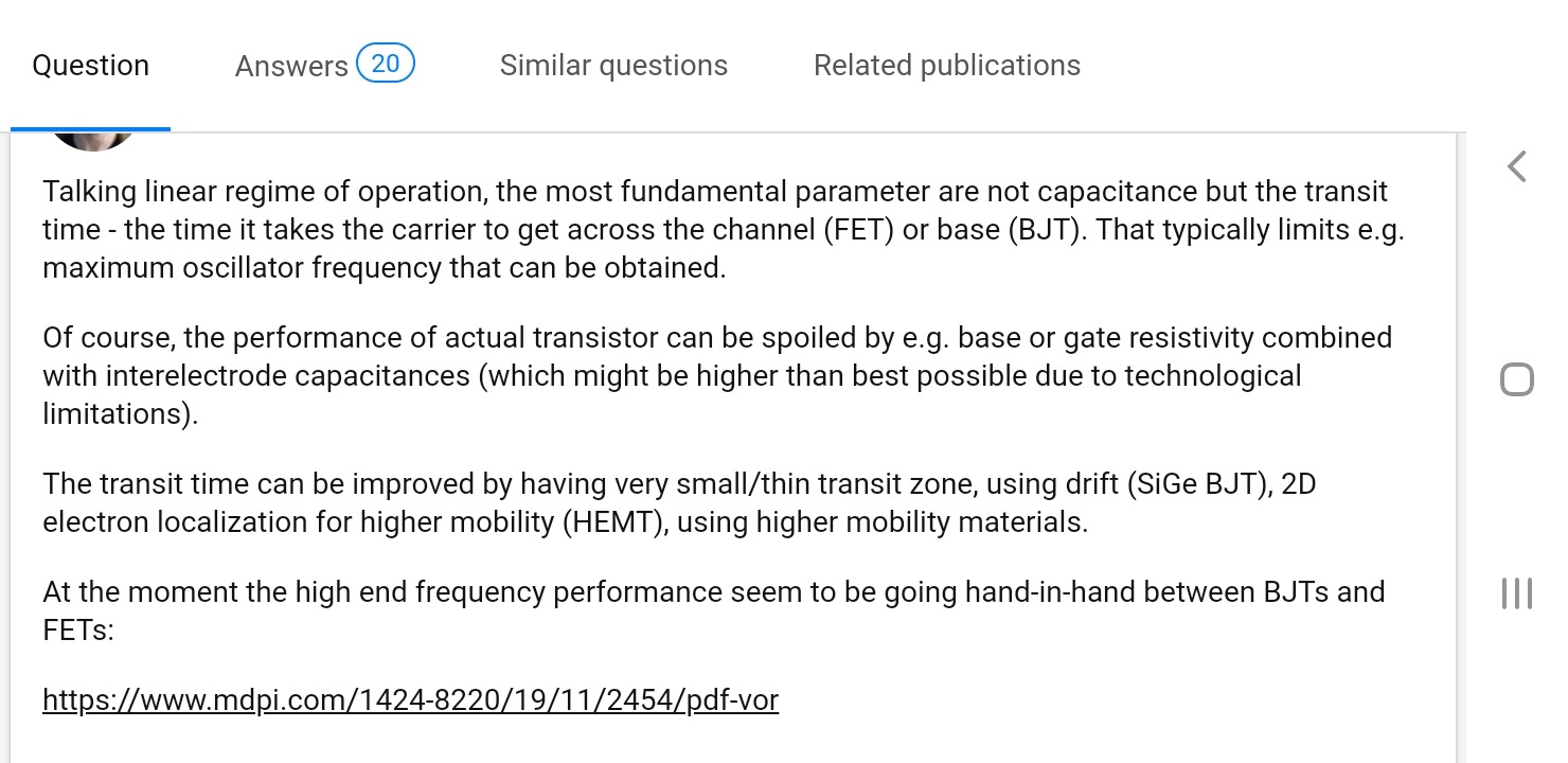

MOSFETs are faster. BJT is not particularly fast.
And the speed of the BJT is inversely proportional to the power.
Really?! At what?MOSFETs are faster. BJT is not particularly fast.
You ca use Google for any question, trust me!
https://www.researchgate.net/post/Which_is_faster-BJT_or_MOSFET_and_why
