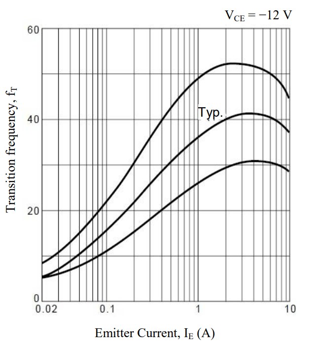

Versus A1386
But SanKen measures at Vce=12V, they're cheating. It is too easy at 12V. We need the output to get much closer to the rail to not waste volts. 5V would be nice.

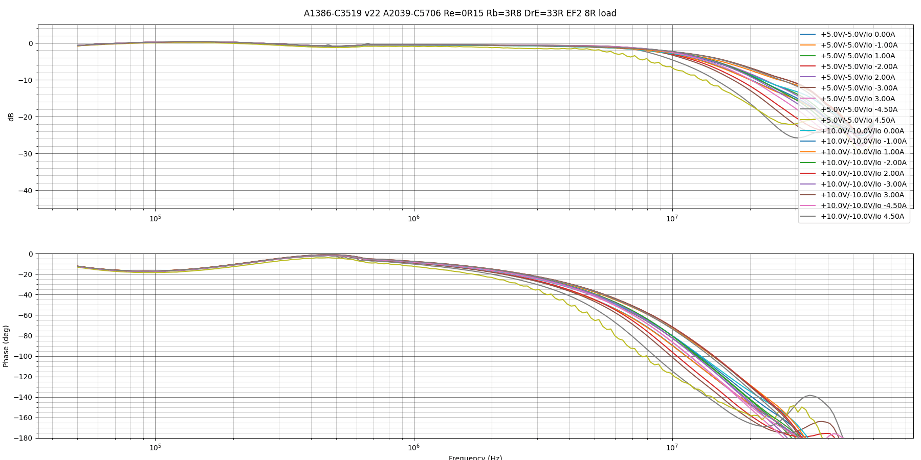

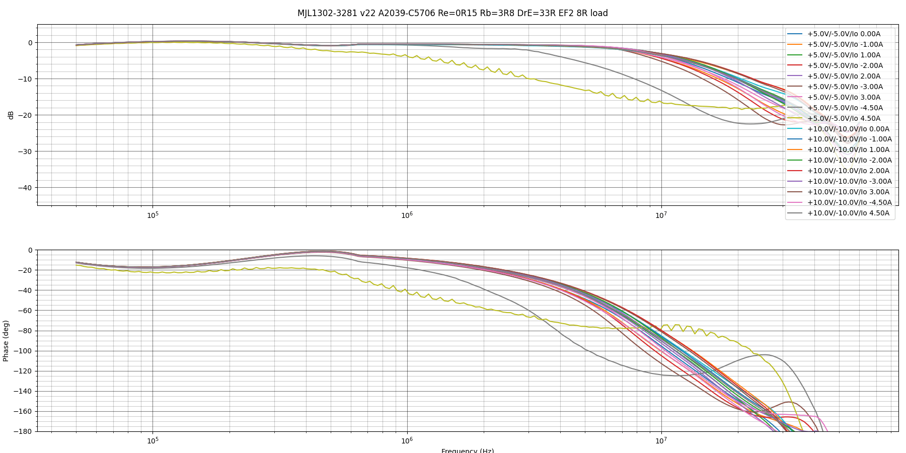

Last year I programmed it to step Vce and current and do network analyzer sweeps. Load is a resistor, there is an output inductor and a Zobel network in the output. 50R VNA output to drivers input.
Result: at Vce=5V, SanKen beats MJL.

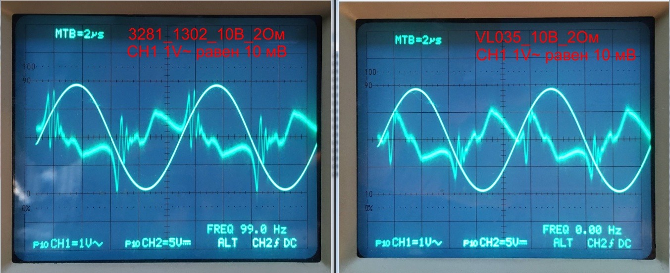

There is a comparison of MJW3281D+MJW1302D with VL035DN+VL035DP in terms of switching distortion.
http://forum.vegalab.ru/showthread.php?t=12016&page=53&p=3043881&viewfull=1#post3043881

How can we see on the oscilloscope switching distortion like in this image ?
It's the residual from a distortion analyzer, with the input fundamental removed.

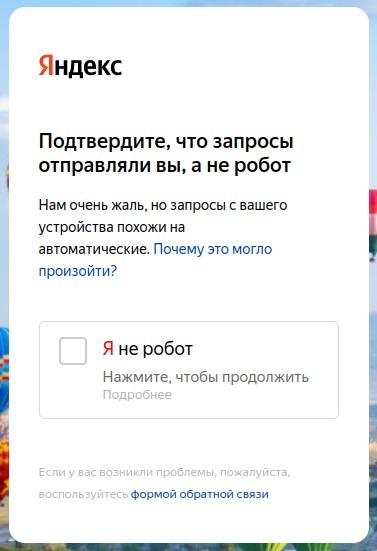

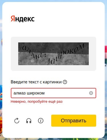

...and the captcha is in cyrillic 🤣
hah you are right, actually I got the robot challenge pop-up when I reload the web page, but on Firefox I only had to tick the box left to the Я не робот and it let me by, on Brave it would in addition ask for typing in Cyrillic, I have installed Cyrillic on my Linux machine but it never worked in the past... until now I just discovered it actually works.
But for the rest, you can copy and paste one by one the corresponding Cyrillic character. :D
А Б В Г Д Е Ё Ж З И Й К Л М Н О П Р С Т У Ф Х Ц Ч Ш Щ Ъ Ы Ь Э Ю Я
а б в г д е ё ж з и й к л м н о п р с т у ф х ц ч ш щ ъ ы ь э ю я
алмаз широком )

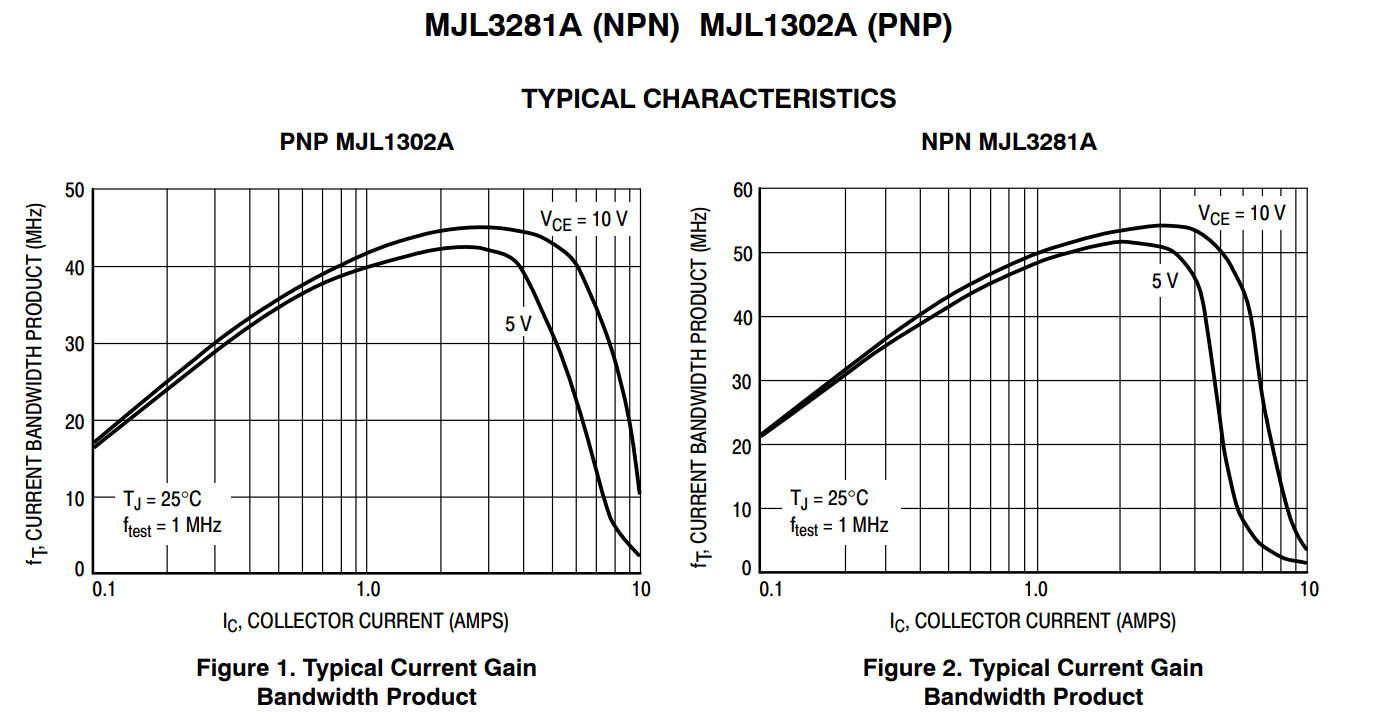

peufeu, I had to look a second time where the gain bandwidth ft curves you mentioned are because they are not visible in my version of the datasheet dated 2022-07-25, then I see in post #7 a slight difference for only the VL035DN datasheet which has a ft curve, yes I agree, being a 150 Watt device it falls earlier at higher currents comparison to some other, but I see those other transistor ft curves you added in an earlier post #26 are on the other hand "very poor" in comparison at very low currents, at 100 mA they are down to some 20 MHz, while these specialties are still hovering around some respectable 90 MHz, at least the NPN version for now as the PNP datasheet says nothing except for the fixed data at Vce 10, Ic 1A, a difference to keep in mind too.
I am thinking like Mr Pass, the first Watt is what counts, then if an amplifier from there on degrades at higher wattage is less important (maybe I'm making wrong assumption here?) as listening to high sound pressure the fidelity of the music is anyway becoming naturally distorted/altered by other factors such as our ears due to its involuntary muscle contraption that start to tense on the ear drum and change the perception etc., and not the least it's also unpleasant too. :)
Well, one can argue for and against which is more preferable, having high ft down to the lowest currents (which may be important for lower crossover distortion?), or at the other side of the spectrum, for what it's worth these mysterious transistors (NPN) are pushing well enough up to at least couple and a half of Amps which should be good for some 50 Watts output which is plenty for many listeners.
