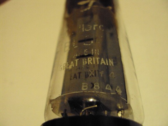

richwalters said:All the Mullard tubes manufactured in GB had a stamp code
Yes. The pic is posted up above. I hadn't previously noticed my stamp code is printed upside down! This one reads Xf3 B5H2, or maybe it's Xf3 B5HZ. Guess it's a Blackburn after all.

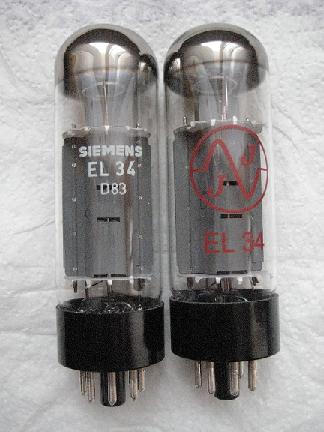

Hello everybody,
I've just bought a quartet of Siemens EL 34, I was told it was a NOS, but now I can't believe it, the tubes look the same like JJ current production including shape and even colors of the materials. Does anybody know whether it's a NOS or not 🙂
thank you
Tomek

Does anybody know whether it's a NOS or not.
It's not. You bought something else unfortunately.There should be a dimple on the top, not shown in the pic. Notice the 4 square holes down each side where the plates join and the big fins on top.
Wow...yeah that's a JJ alright. They have that unmistakable envelope shape. Very typical for China, but I am surprised to see a JJ rebrand. I have had a few JJs that had no stamp on them at all.
on the other hand I found this post searching by google but the site itself does not exist .....
"But Siemens NEVER sourced EL34 from JJ. This Siemens label "D83" indicates them as being manufactured in 1983... in 1983 no one even dreamed of JJ. ...

I speak French well enough to understand the contents of those posts; basically that Siemens never made it's own EL34 and that in the old days they rebranded tubes primarily made by Valvo Hambourg or Telefunken through sometime into the 1970s, and somewhat later those made by the other various Philips group of companies like Mullard, Mini-watt, RT, Dario, etc.. He also said that Siemens from the 1980s onwards rebranded RFT, Tesla, Svetlana and others. So it is quite possible that these are early 1980s Tesla production. (I have had vintage Tesla that looked exactly like these, bought by me in that time period.)
I think it was somewhat disingenuous of the seller to pass them off as what most of us think of as the Siemens EL34 (Valvo rebranded) but technically he is probably within the letter of the law. I too have been burned this way as well - you need to ask for proof that they are the vintage and construction you are expecting before you bid on them.
Based on their provenance I would say the purchaser in the auction cited above paid a bit more than what new production JJ would cost and got something comparable. These tubes in my experience sounded pretty good, but were not nearly as rugged nor long lived as Western European made EL34s. And sadly not in the same league at all with any of the Philips made tubes.
FWIW: I thought Siemens did make its own EL34 but had noted the similarity between vintage Siemens and the Valvo product. So while I suspect the French language post is definitive it might not be, and I have not checked anywhere else. So caveat emptor as the Romans say..

That makes a lot more sense. The look of a Tesla/JJ tube is so distinctive. A poor choice to relabel for profit as is so common with Chinese tubes.
I think so too.I don't know if older Tesla's were any better than current JJ's,but they can't be bad either.
siemens never made EL34 and many others. they simply sourced them, most from the philips group like: Ei, Tesla ( not JJ), and ofcourss mullard, valvo, etc. later, when all tube manufacturing went down, 70s..80s, from RFT, and the companies all joined buying from RFT when their own tube manufacturing was closed. Some even let the 6CA7, 6L6 make in Shuguang, China ( for the US), Telefunken let the EL156 make in Luizhou ( china.) many shipped the tooling to here, some knowledge as well, and thats were the fun started for the chinese. before that, they got tooling and knowledge from the russians, which just copied american and european tubes.

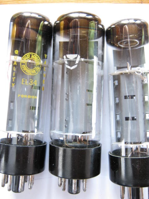

A trio of 3 types of EL34. All well handled with near faded logo. The original Mullard is in centre
The LHs is a Bentley Vendor, the RHs is a Siemens Vendor. Note the anode slits of the Mullard are much smaller and has 3 rivetted in the anode plates. The mica is also different as is the base which has pin 6 omitted.
So with rebranding the name of the game, who made the Siemens ? The Bentley version has a thicker anode plate than the Siemens. The Mullard is the only authentic version.
