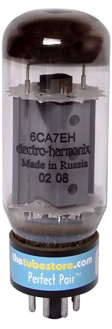

See above. Again, I'm pretty sure the Electro Harmonix 6CA7-EH is a beam tube. One reasonably accurate way to tell (besides peering inside through the plate holes, or looking for the telltale structure poking above the mica) is to measure the screen current. One key feature (perhaps even a requirement?) of beam tubes is the alignment of the G1 and G2 grids. Screen current is typically much lower on a beam tube than on a pentode of similar class.
edit: I found a good photo of the 6CA7EH. Look in the plate holes - you can see the beam formers inside. Count the grid support rods poking through the top of the mica. There are only two, not three.
I agree there...any Reflektor tube with round holes seems to be a beam tetrode. Also, if memory serves, beam tubes have larger plate structures in general because more space between G2 and the anode is needed to prevent too many wandering electrons that were not repelled back to the anode from reaching G2.

Very nice, Johan Potgieter! The EH6CA7's are built like pentodes then ...

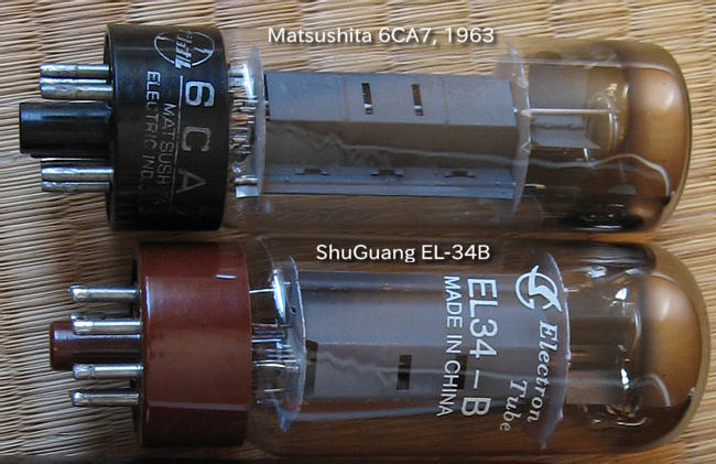

The attached photo compares 6CA7 made by Matsushita in 1963
and ShuGang's EL-34B made in the 21st century.
The constructions resemble each other and plate currents
are identical in my amplifier. At 1963 time frame, Matsushita
had a technical joint from Philips therefore its 6CA7 was
considered to be the same design with Philips's. 21st century's
EL-34B by ShuGang seems to take the original Philips' design.
I think this construction contributes to good sonic.

I guess we're on to something ... The whole 6CA7 beam-tetrode/pentode thing seems a bit "unclear" - as there's testimony to both tetrode and pentode construction ... I guess I will let the reader find out if this is something you want to investigate on your own. A new thread on this maybe?
Suffice to know that the tubes recommended in this threads list all are fine in an EL34 amplifier!!! Here's wishing everybody the very best sound for their money!

Logically thinking, 6CA7 should be a ray tetrode, while EL34 -- pentode. Why? Legal issues, patent right. 6CA7 was made using modified 6L6 technology and documentation developed by RCA engineers in 1930'th. Manufacturing development and setup in pre-CNC era was costly for production of a totally different tube.
So it seems that an aswer to the beam-tetrode/pentode question might be given here by Wavebourn ... it seems so plausible.

In my previous post I was not trying to 'polarize' matters regarding the 6CA7. It is obvious that they come both with G3 and without it - too much evidence of that.
To perhaps recap briefly (apologies to those in the know): The screen grid was added to a triode with a dual purpose: To shield the anode from the g1 because the position without it (triodes) became impossible in r.f. due to the high anode-g1 capacitance. The second purpose was to provide a constant current characteristic, so that the constancy of the electron 'stream' was not influenced by anode voltage (as in triode). It is this second feature that brought on the problem of secondary emission - electrons 'bombarded' off the anode by the arrival of high speed electrons all the way from the cathode. It was not a problem with triodes because they merely returned to the anode - the only positively charged element in the vicinity. But with an equally positive (or sometimes more so) g2 in the area, the screen current would increase abnormaly with the anode going lower in voltage than the screen during positive g1 swings.
Thus a g3 was introduced with little effect on the fast travelling electrons of the primary stream, but enough effect on the much slower travelling secondary electrons bounced/dislodged off the anode. (A g3 would be seen with much wider space between windings than other grids.)
The beam tube advantages came about when an alternative had to be found to a pentode as mentioned before (patent matters etc.) Here it was found that a space charge of electrons formed near the anode with the anode further away from the another electrodes than before. This was, with the right electrode distances, found to be sufficient to replace g3 action, with some advantage in efficiency. The beam forming electrodes were added to prevent stray electrons at the sides to find other ways of going around because the grid-anode geometry did not exist there because of mounting posts etc. It is stated in original notes that beam tubes may or may not also have G3s. The extra efficiency resulting from g2 lying 'in the shadow' of g1 windings (same pitch) is another feature, not really related to the space charge-g3 matter.
Thus (in the early days, anyway) such 'pentodes' could exist with/without beam forming electrodes, and independently, with/without G3. The common beam tube topology emerged historically as the preferred way; the point is that one could have, say, the 6CA7 with/without g3, or with/without beam confining electrodes.
As far as I know this is the only tube where this variation exists in practice. RCA Tube Manual lists the 6CA7 as equivalent to an EL34 with identical characteristics; they call it a pentode, thus with g3. I think it has been evident that, probably in the interests of economy, the Russians are now marketing more kinds of 'generic' structures. Thus the about 9% difference between KT66 and 6L6GC is ignored, and the identical structure is used in both tubes; some are even marked KT66/6L6GC. The ideal curved anode structure has also been dispensed with, apparently with little adverse effect. (Original KT66s had a flat anode, original 6L6s a curved one.)
Above basic notes come from RCA Tube Manual and other early works on tube development. Again apology for hopefully informing some of what must be old hat to others.
JohanB said:The mainly sounding and measuring difference is that the tetrodes have a much sharper clipping and more high order odd harmonics, than the soft clipping EL34 pentodes.
The percentage of the optimum screen-taps for ultralinear operation also differs. Normally 40-43% for tetrodes and 25 - 30% for pentodes.
Johan (namesake!)
This is basically so, but in practice depends on the circuit design. Clipping, yes; but hopefully one does not normally listen there; that is in overload! (excluding guitar amps where this characteristic may be used as part of the guitar sound). Distortion patterns before overload depends on circuit parameters.
Then similarly, one will find that the chosen % screen tappings also depend on design features. I am sure you are aware that EL34 (pentode) designs in fact largely use 43% taps. Outputs are slightly higher the lower the screen taps, but 'triode' typical characteristics appear somewhat more prominent with increased tap %. Very generally maximum outputs start to decline notably with taps >45%, so that UL advantage then begins to disappear. Again this is tube-specific; the above is general.
rknize said:I'm looking for more midrange from these KLF-10s. I'll give these EH 6CA7s tubes a spin next time I order parts from one of the vendors. I found the EH KT90 to have a more pronounced midrange as well.
Just wanted to check-in and say that I did pick-up those EH 6CA7s not long ago and have been listening to them. They sound great in the SSE! They pick-up enough of the bass that the EL34 lacks and have a nice midrange like the KT90s. I haven't done any "critical" listening with the SSE in a while, but I've been listening to lots of live Knopfler stuff while doing other work in the room (finally getting to some remodeling). I was using the TSE before, but it just can't fill the room and have good bass response at the same time with those 45s. The SSE is perfect and plays live rock music the way it should be. The 6CA7s sound really nice as triodes. I'll have to sit down "in the spot" with some female vocals to see how they really compare.
