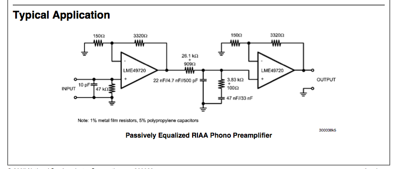

Thanks to DIYaudio in general and Helmuth in particular! I built the phono pre per the National Semiconductor LME49720 datasheet. It sounds very nice on it's first album! It is clear and detailed. Better than the modded AT PEQ3.
Two op amps with left and right running thru each chip. Panasonic polyprop caps when I could find them in the right value. Simple is a good thing! Two more 9v batteries and I can run it +18v/-18v.

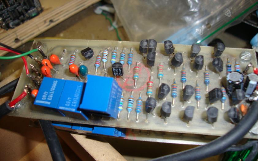

Schematic and poor phone pic of the running, bare Rat Shack board.

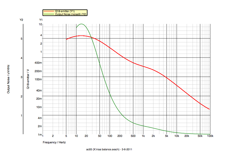

For people how like to simulate the amplifier here a zip with the data for simetrix. Simetrix is freeware version (and also professional comercial available).

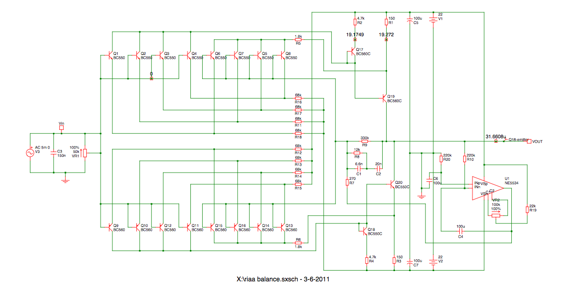

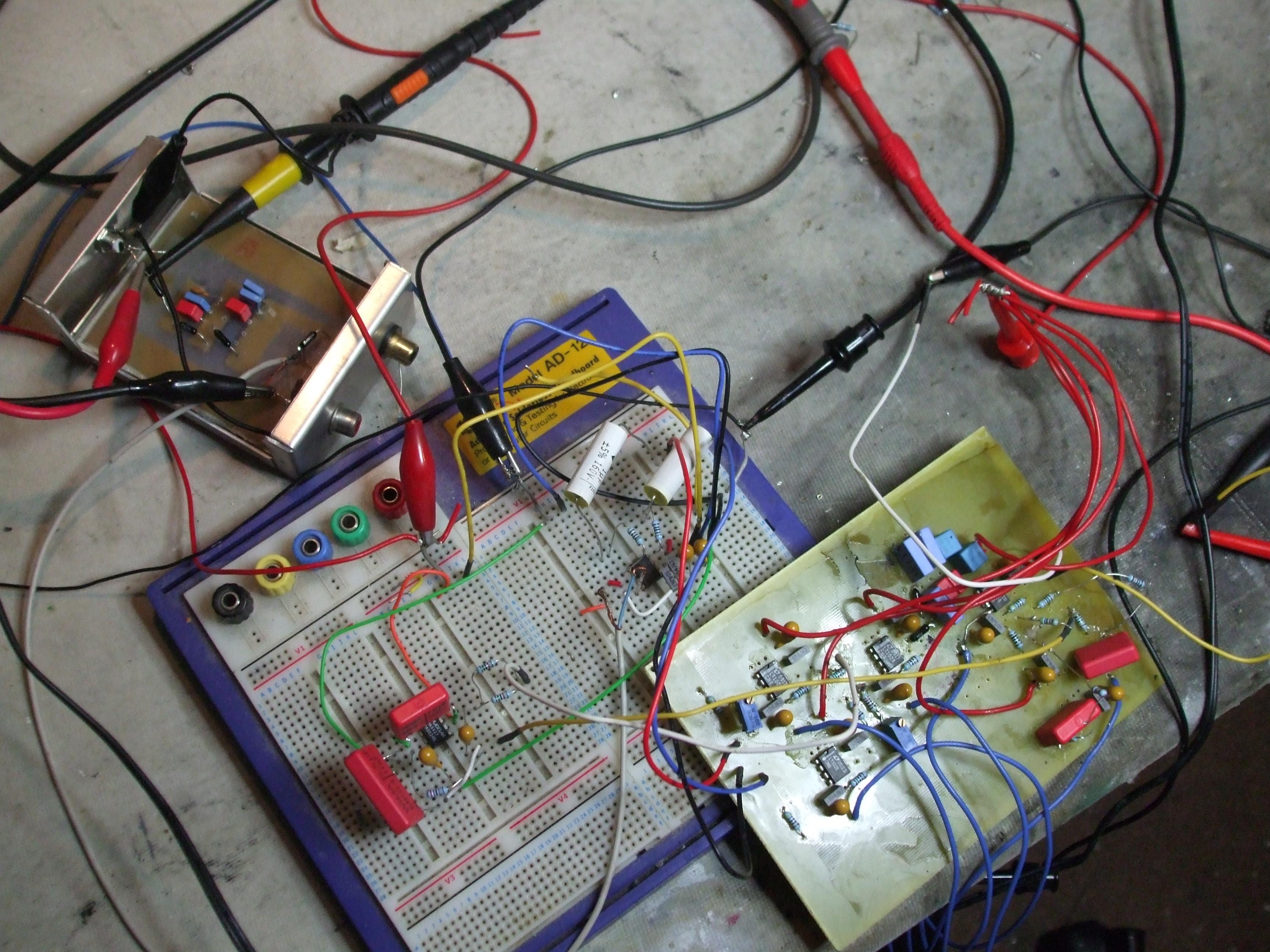

I had a split passive MC (60dB) balanced in that I have cooked myself following reading up the great Douglas and following advice from Joachim Gerhard, (most Nice and helpfull Human)
It was nothing special (I have no pretence to be a designer) but worked / sounded better than what I had from the shop.
After 3 years of trouble free operation (Is powered by rechargeable batteries)
I think it may be worth a litle for somebody that like to cook it's own.
Then decided to see if I could improve things a bit
So there you have it.

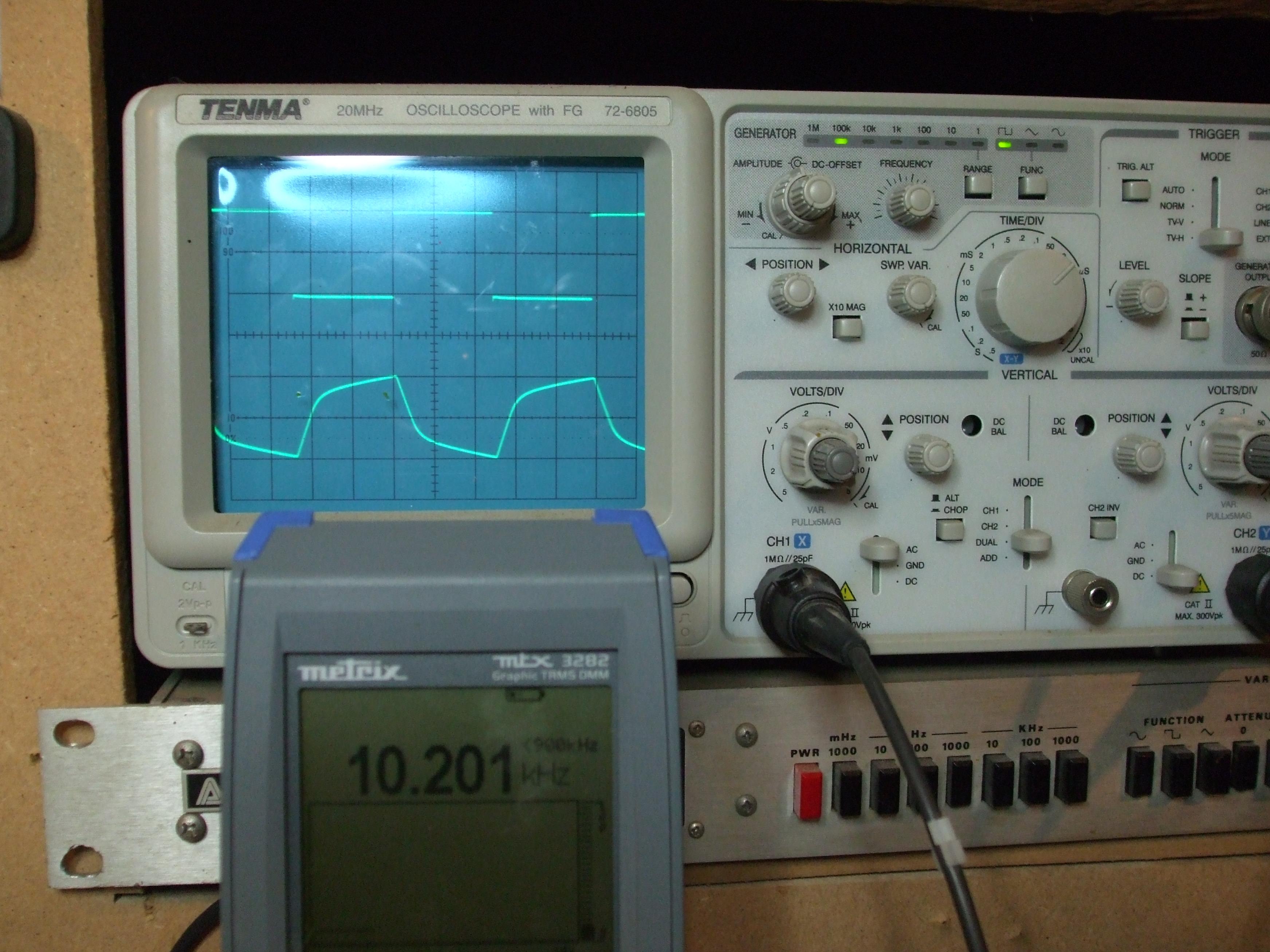

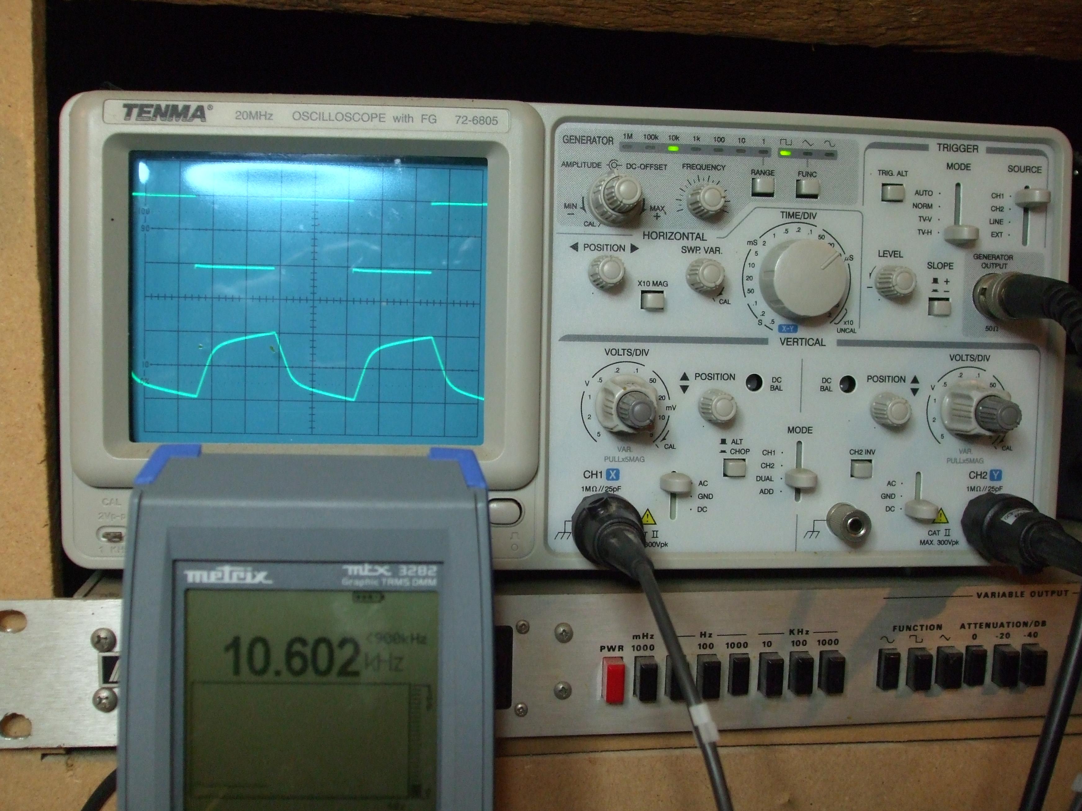

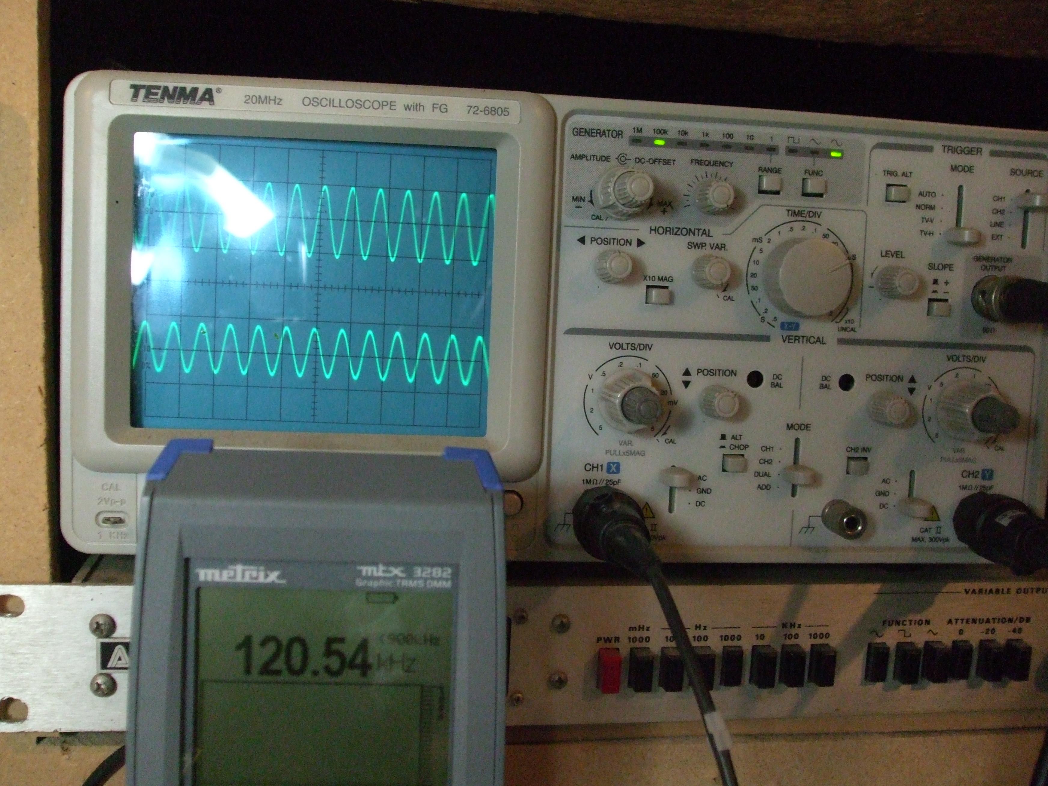

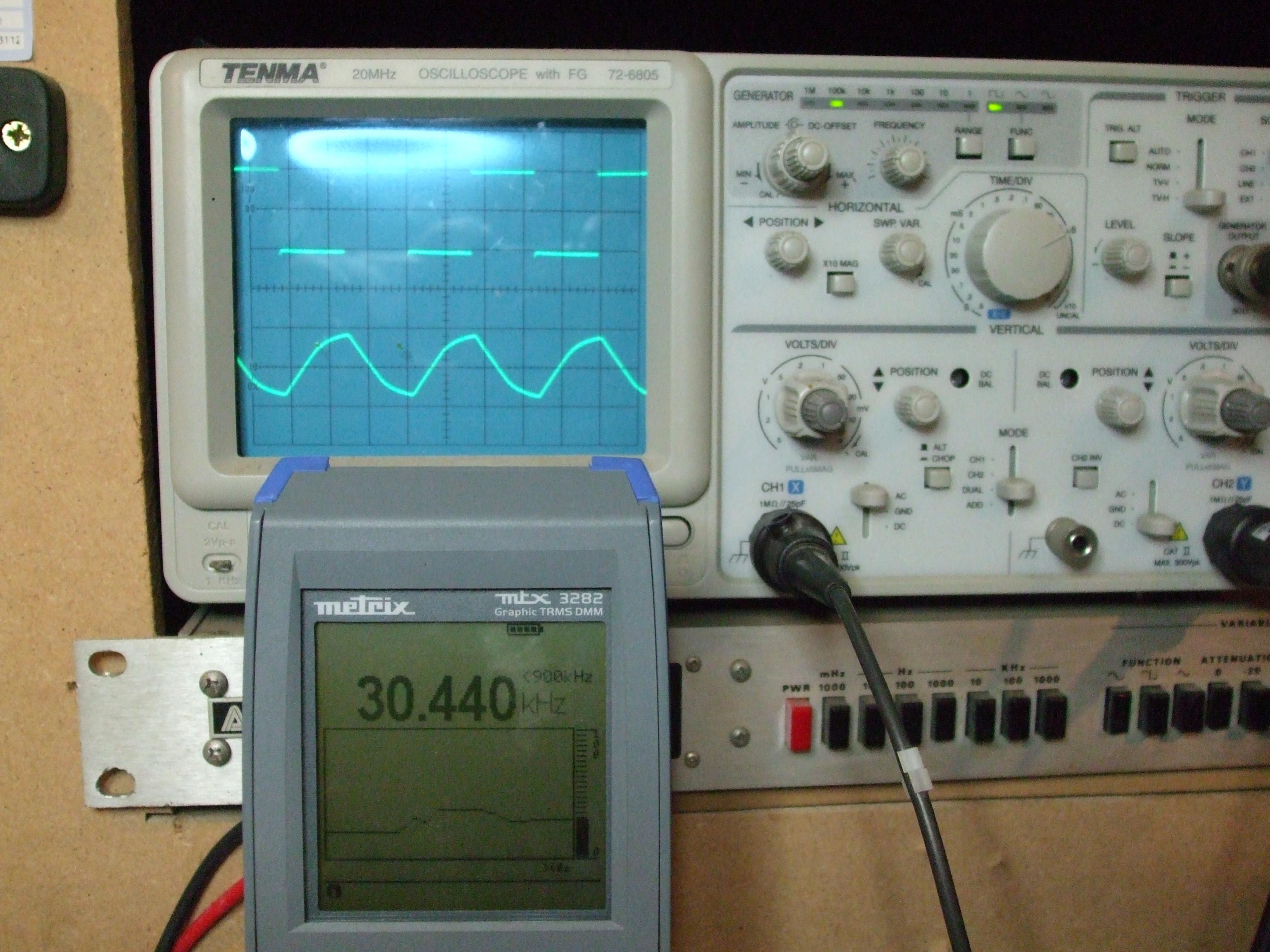

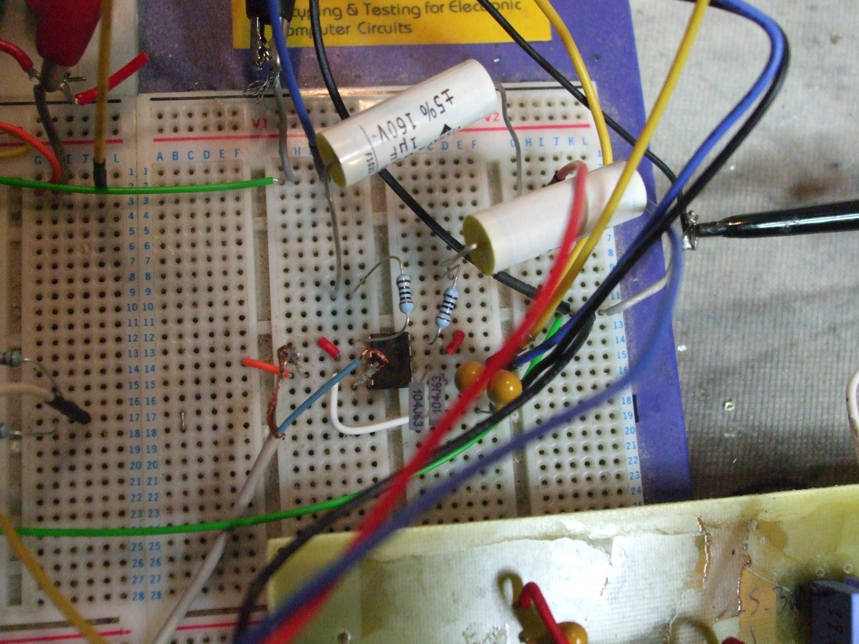

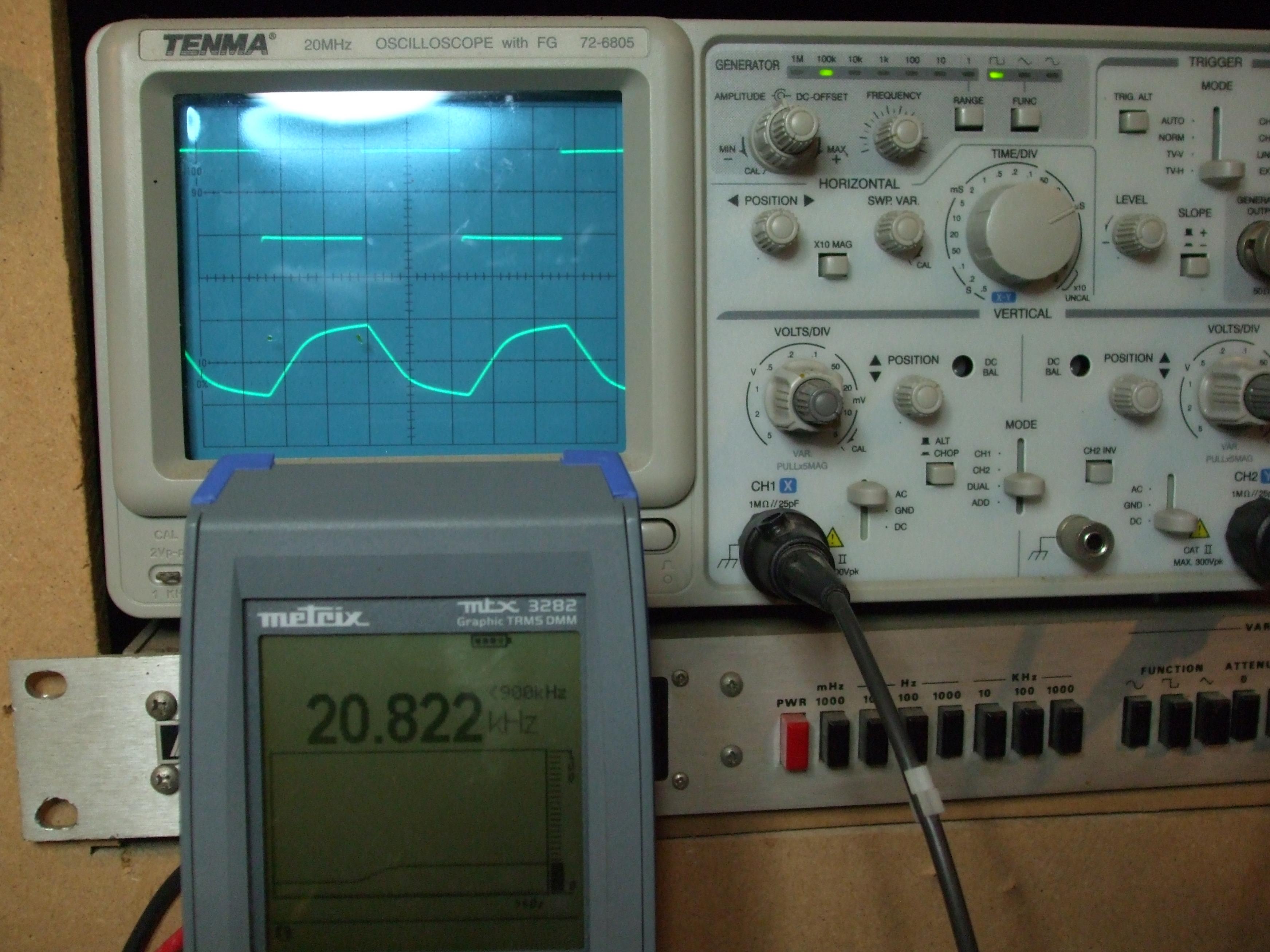

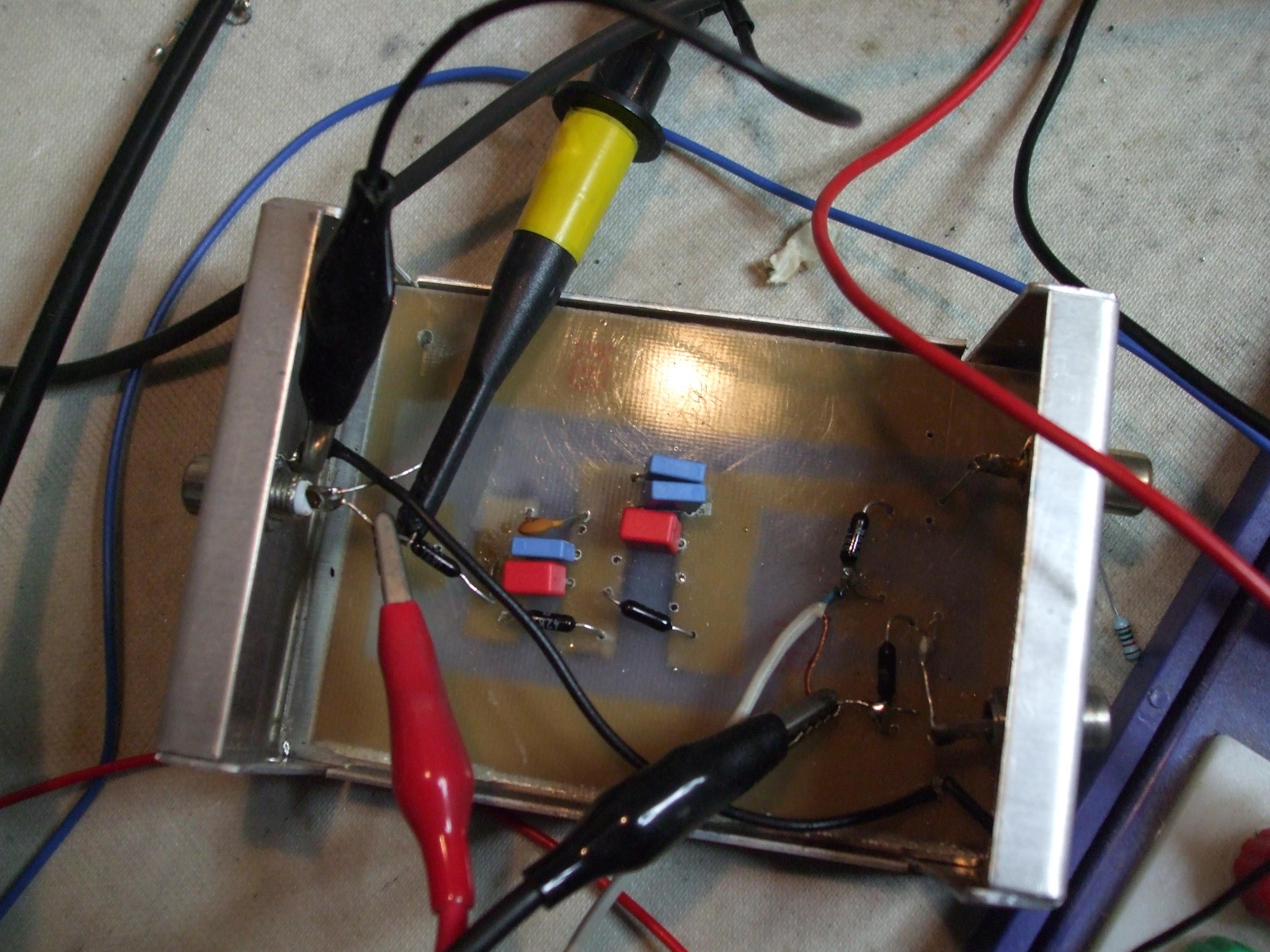

LT1028 balanced in, single shoot passive RIAA MC Phono pre.
I am going to make final PCB this morning in the mean time get a peck
On the bread board a THAT 1646 to make the output from inverse RIAA balanced and the DC servo DC is at less than 1 mV at output.

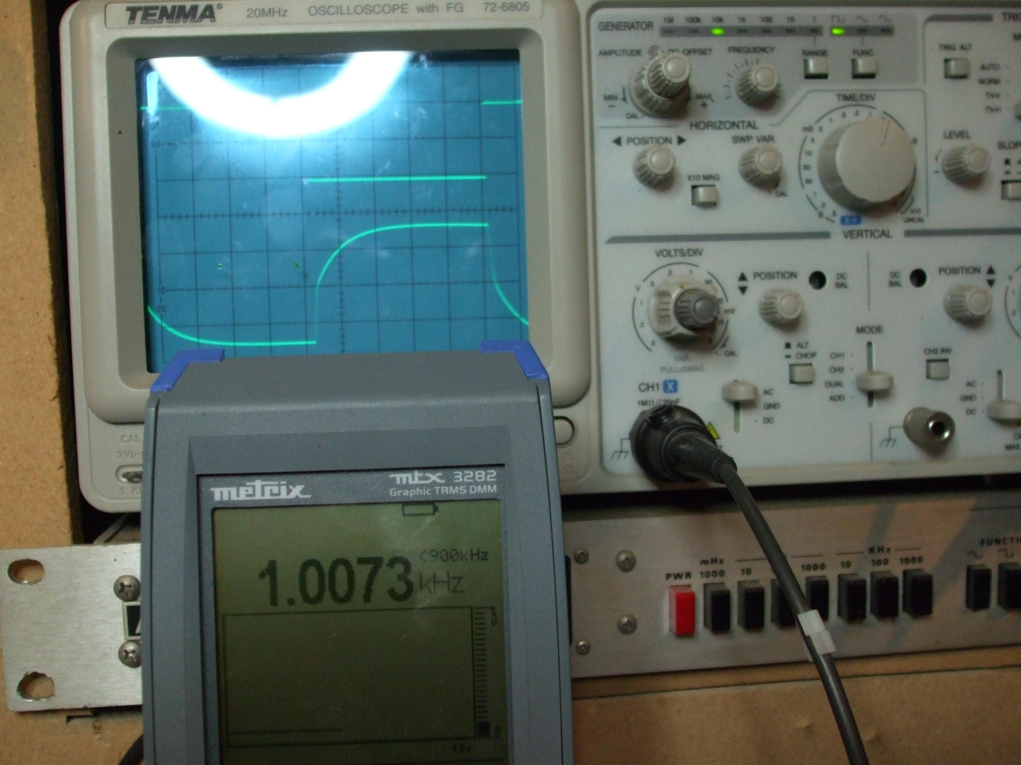

I supose you could have a good look at my Knobs on the scope top is the imput to the passive RIAA botom is the output DC coupled from the pre.
Yess 5 volts division on a 12 Volts rails suply
IMO less than Ideal set up with all those vires and on the open so I should expect better once in the box.
Really all I would like to say is get building...
