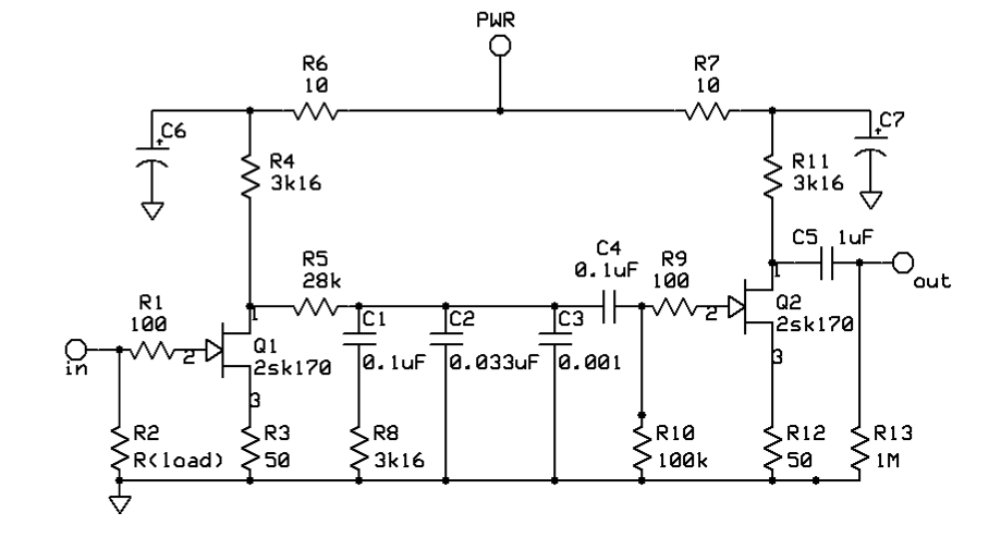

Thanks to DIYaudio in general and Helmuth in particular! I built the phono pre per the National Semiconductor LME49720 datasheet. It sounds very nice on it's first album! It is clear and detailed. Better than the modded AT PEQ3.
Two op amps with left and right running thru each chip. Panasonic polyprop caps when I could find them in the right value. Simple is a good thing! Two more 9v batteries and I can run it +18v/-18v.
Schematic and poor phone pic of the running, bare Rat Shack board. :up:

That’s exactly what I did. First build the lme49710 application note version, and it sounded real good (even with the ne5534’s that I used). Next thing I did was try to improve it, made it balanced in, and added a hefty power supply. It sound truly wonderful, the big eared friends are very happy 🙂

Hi Frans,
You really made a lot of work of your phono stage. Did it work to make it humm free with the transformer in the same enclosure.
And very nice finish on the front of your enclosure. What is that CNC.
Helmut,
For as far as I can measure and hear it is absolutely free of hum(m) or any other power supply related noise. The power supplies are in u-metal encasings, the other electronics is in copper cases (2mm thick). I have build 2 pre amplifiers, one for my MM (a Shure V15xMR) and one for MC (in use by a friend of me). We are both very happy with the result. The front plate has been machined, cnc, by Hi-Fi 2000 contenitori per l'elettronica, case modding HTPC, Galaxy, rack, DIYaudio, computer cases, front panel express, knobs,milled Handles, milled fronts, hi-end, in Italy.
Frans.
P.s. all boxes inside the frame are fully isolated from each other (except for one common ground connection).

Hi Jacco,
I just opened the postbox and found the capacitors you send me. Guess what direct got the welder and put them on the circuit board they are about 15 times the size of the MKT but it wasn't that difficult to place them.
I hear a more refined high frequency and smoother sound definitely the best I had in the preamp. It appears to me even the soundstage improved in width.
Jacco thanks for helping this poor vinyl-lover to improve his preamp.

Now I added a DC servo to it Like in the design of Frans. I am just pimping the design a bit.
