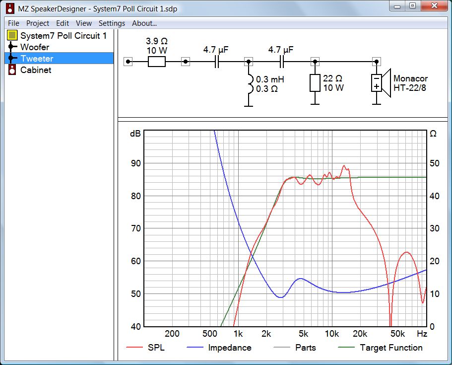

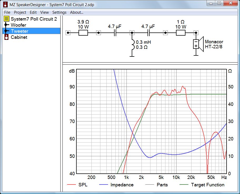

Which crossover sounds better?
Which circuit sounds better?
  • Circuit 1.
    Votes: 8 38.1%
  • Circuit 2.
    Votes: 5 23.8%
  • Exactly the same.
    Votes: 3 14.3%
  • Mate, buy some decent tweeters!
    Votes: 5 23.8%

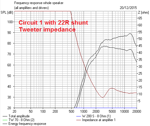

You hve the impednce plot in the first post.
No, in the first post there are impedance plots of the whole systems only. More revealing are the impedance plots of the tweeter+(high-pass)filter alone - which is why I requested them.

Yes, but total impedance alone may put veil on some important clues. On the other hand, total impedance together with total phase vs frequency can reveal some important flaws.
System7, please post the total impedance/phase graphs for both circuits.

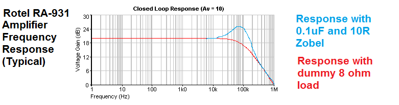

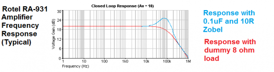

High speed amplifiers for audio
You need to know that regular transistor amplifiers have actually run out of gain completely by say, 20kHz. So there is virtually NO feedback to reduce distortion. This is why amplifiers are very load dependent at high frequency and their stability matters. At 100kHz distortion is enormous into open circuit.
Rotel have added that little 10R and 0.1uF Zobel to keep it just stable into open circuit. But really, it's designed for 8 ohm dummy load.

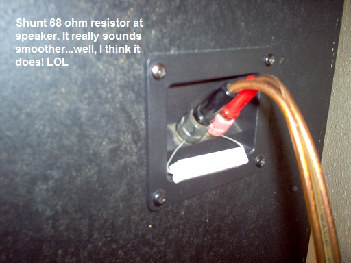

Maybe we now understand why that 68R resistor across the speaker terminals actually does do something! 😎

Time for the answer, which only 30% of us got. This test was with the Rotel RA-931 amplifier, a cheap but mature and solid Class AB design. 🙂
Circuit 1 with the 22R is the better sounding circuit. It is very detailed at the top end and goes loud comfortably. Any limitations in dispersion and HF are measurably down to the cone tweeter IMO.
Circuit 2 with the 1R series sounds bright and lively at the top end, but has an uncomfortable fuzzy distorted sound. All too common and familiar in irritating sounding speakers. And we've all had a few of those.

Circuit 2 ... has an uncomfortable fuzzy distorted sound.
Probably HF oscillations of the amp. A peak of 5 dB means the phase margin of the Rotel amp simply is too low. The step response without load must look terrific.
Don't blame circuit 2, properly designed it could be fairly equal to circuit 1. However, your version 2 isn't, the attached simulations show it's actually brighter than version 1.
