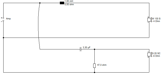

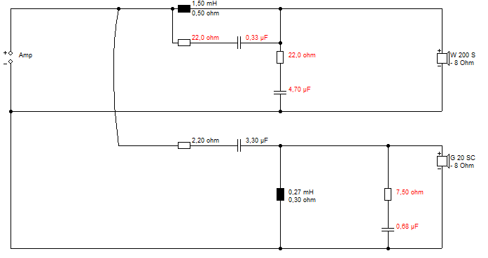

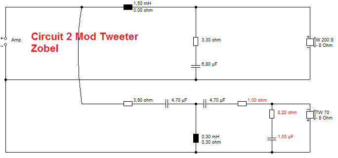

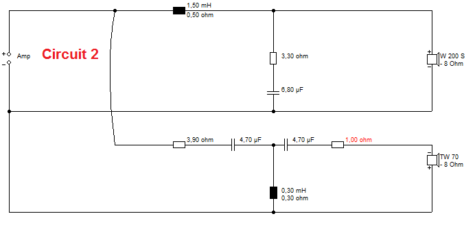

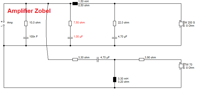

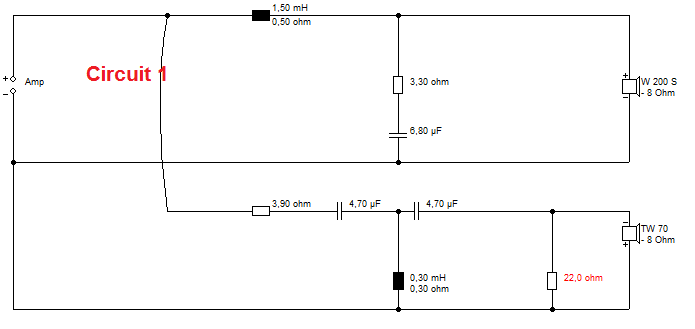

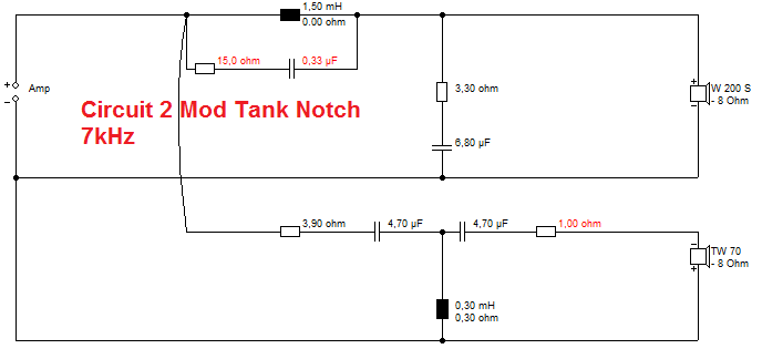

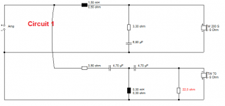

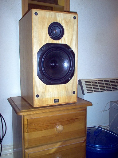

Here's two circuits I used recently on my speakers. Both BW3. Which one do you think sounded smoother and better?
I enclose the equipment on test. Usual Rotel SS amp and CD.
You are a very silly person. I like that. Here's my answers.

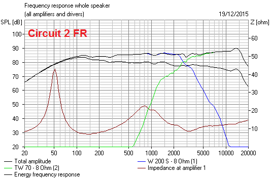

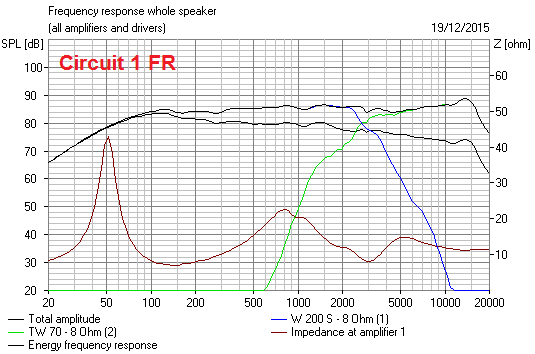

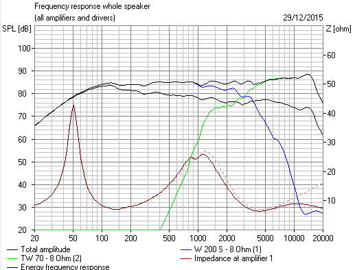

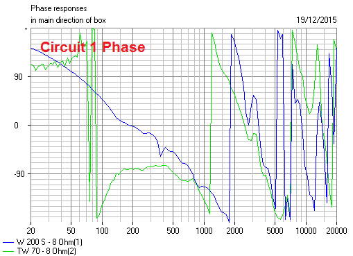

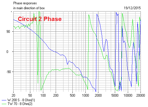

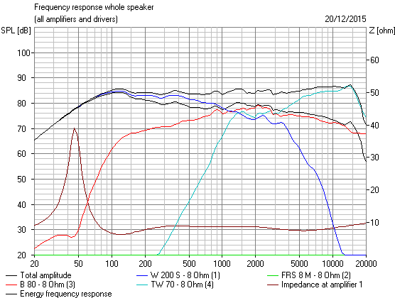

Circuit 2 may have more output especially between 2kHz and 5kHz, and the higher impedance overall but it also has the most severe impedance phase (40ish vs. 65ish) angle in the tweeter range. I'd be really curious actually to see if the amps pictured would have a difficult time with that or not.
Note the acoustical phase angle of the tweeter will be pretty close, with the biggest deviation being less than 10 degrees, but almost equal at the zero crossing, so that was a red herring. 🙂

The issue I have described here is a purely practical one based on listening tests, which is what it's all about in the end. I've built dozens of crossovers along these lines.
This is not a tonal problem. I can correct that with a resistor change or the treble control of the amplifier. It seems to be, as I stated, the amplifier is, for whatever reason, sensitive to the load at supersonic frequency.

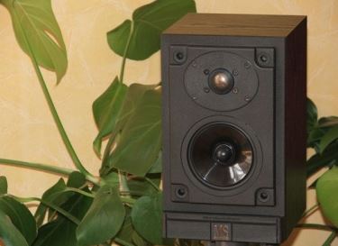

For interest, here is the filter of the famous old Mordaunt-Short MS10i designed by Robin Marshall AFAIK.
That little 2W 47R resistor always baffled me. Why was it there? 🙂

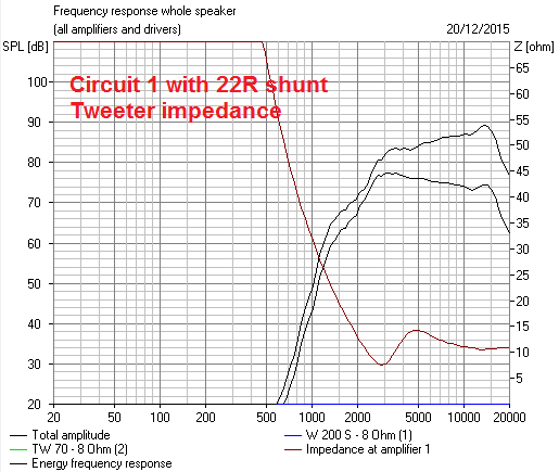

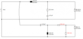

Your answer to the 47R resistor is in post #20. Can also help to knock down the resonance impedance peak a tad if it's a minor problem without having to go the full LCR.

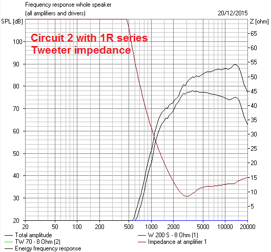

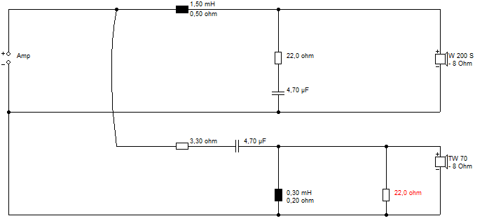

You really need a circuit 3 with the 1R given the flick and the 3R9 increased to 5R6 or whatever to bring the top end down to the level of circuit 1. With that change the rest of the filter should be recalculated to address the different method of padding and that should apply to circuit 2 as well.
I can see where the 22R could be handy with a cone tweeter (BTW, got a high Le=0.16mH..... I have mid woofers with lower Le).
The series xo in post #17 needs some work as the tweeter is only a few dB down at Fs. I know it's only there to show an impedance plot. For series xo's, the inductors need much lower DCR for tweeter protection (plenty of info about that online). An AR series xo would have been easier, less components but maybe not as much fun or challenge.
Really, rabbitz, I was just sharing an observation about supersonic electrical amplifier load to my good friends here at diyaudio.
Naturally I know how to adjust tweeter level, but my observation was really that the 22R shunt IMPROVES the sound with my particular amplifier. People using attenuators on the tweeter will have this built-in.

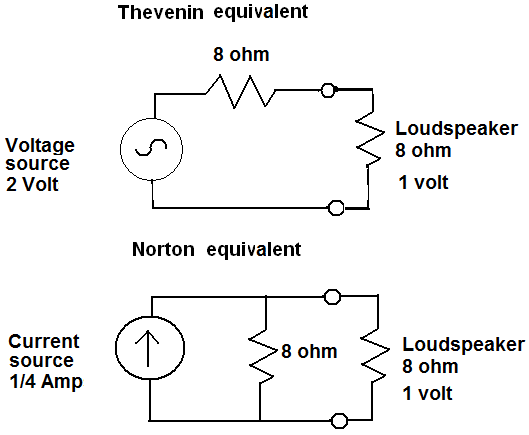

Information Theory says the information that a channel can convey depends solely on the bandwidth and signal to noise ratio, for instance. You actually don't give a hoot if it's a radio system or a hifi speaker and amp.
Modern audio designers pay little attention to signal to noise, and rarely measures it for, say, a soft dome tweeter. The fashion is THD. They should. White noise testing is very revealing in radio frequency channels.
That model of an amp with load is a simplification, of course, but I think explains the load and stabililty and noise problem. If all is well, cables and shunt resistors and HF quality won't matter. But sometimes it might, which is what AllenB is talking about.
So this little 68R resistor, or 7.5R + 1uF Zobel for all I care, does make a difference, but not always. Depends how the amp is designed.
The red elements in the circuit below improve the sound with cheap amps IMO. Because they create a lowish resistance path to ground at HF.

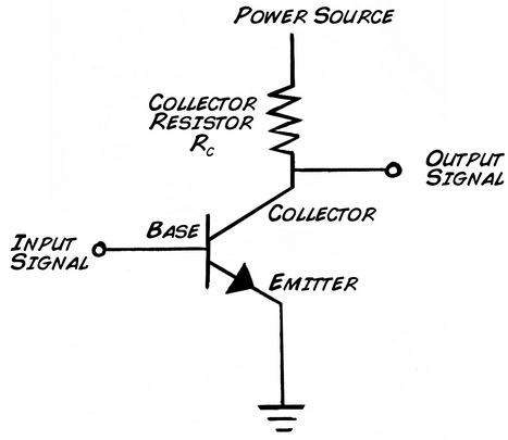

I'd be a bit wary of shorting the HF with a simple cap, AllenB. Voltage amplifiers simply don't like driving short-circuit. Tends to strip the emitter disastrously. It'd be fine with a current drive valve amp, of course. Valve amps, by contrast, don't like driving open circuit.
TBH, I really don't see much difference between a fast valve current amp and a fast MOSFET voltage semiconductor amp. I have become convinced by the mathematical Thevenin-Norton equivalents that they end up in the same place. I built a current-drive collector follower bipolar amp back in the day, but it tended to fry tweeters when they went high impedance, because feedback made it push more and more voltage to get the current up.
Regular transistor Class AB is voltage drive emitter follower.

Let me reiterate that you folks with straight tweeter attenuators (the last image) really don't need to worry about this. HF Impedance remains fairly flat with a tweeter attenuator. 🙂
