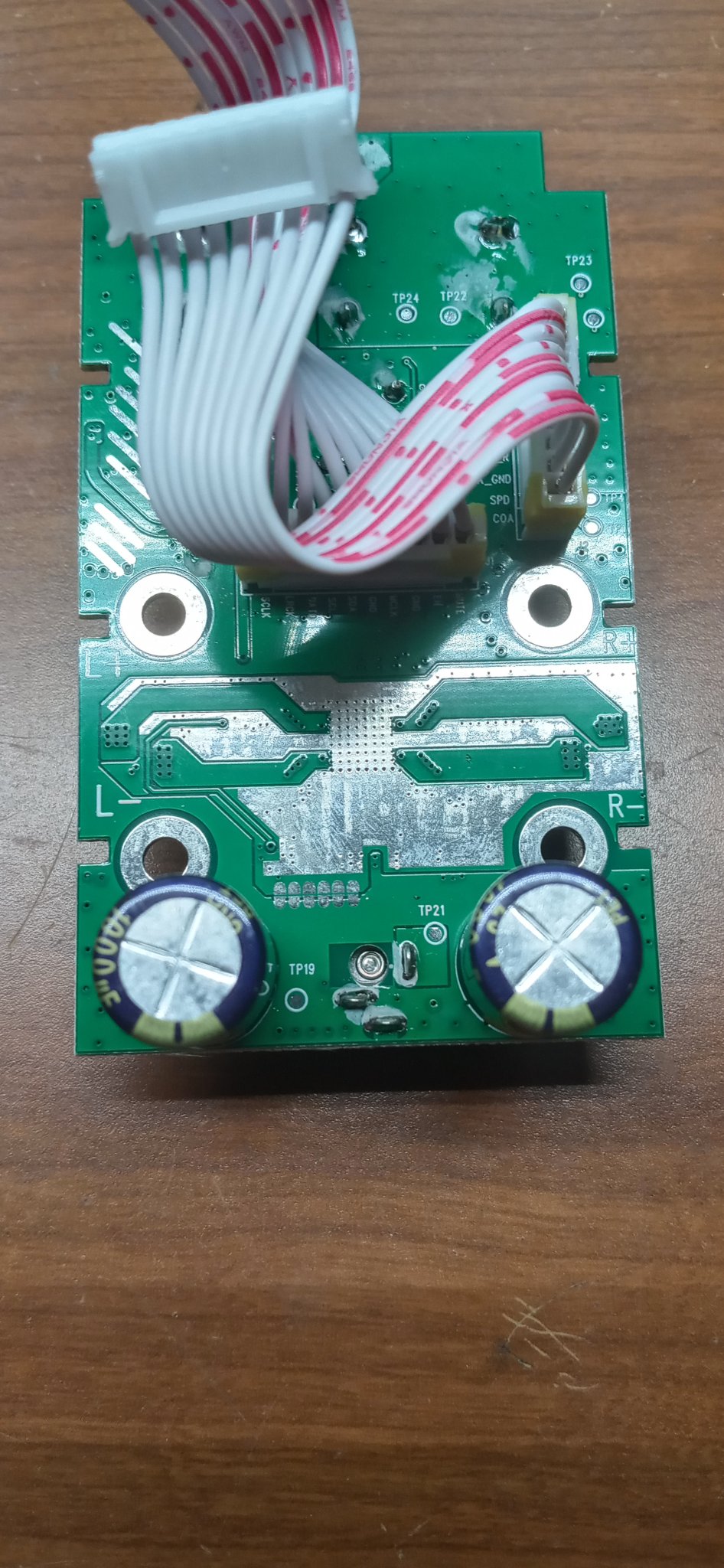

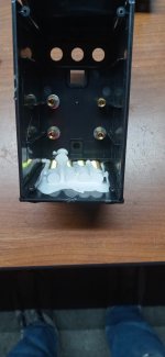

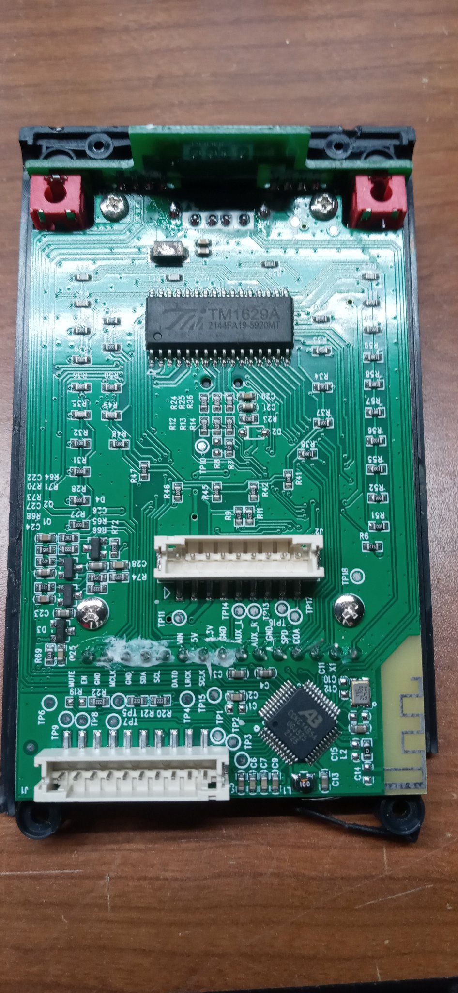

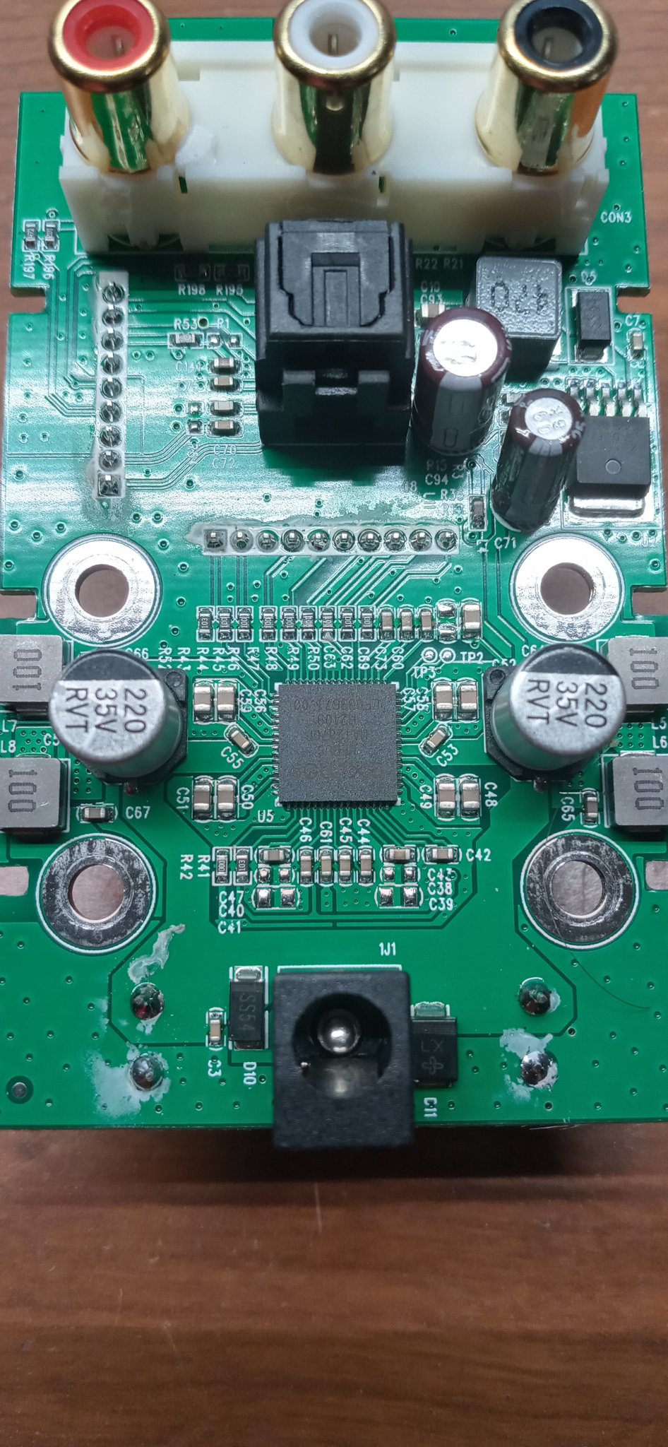

I disassembled mine. It consists of two boards connected by a ribbon cable. The main board is basically the amp with inputs and power connectors. The speaker connections are the four large holes in the board - these connect to the speaker terminals when the board is mounted into the housing. The 2nd board has the LED driver and bluetooth chips. The housing has the four speaker terminals and some threaded bolts glued to the bottom to give it some weight. 🙂 Lots of electronics for the price! I haven't done any testing/listening as I'm deep into a speaker project.

There are worse layouts out there. Thermal stitches seem OK too. Also it has output filtering not found in more expensive amplifiers. The costcutting already started by leaving out some decoupling caps. Low cost and high modding potential.
Maybe the more noisy MA12070P is more quiet in reality when compared with devices that use MA12070 without any filtering….
