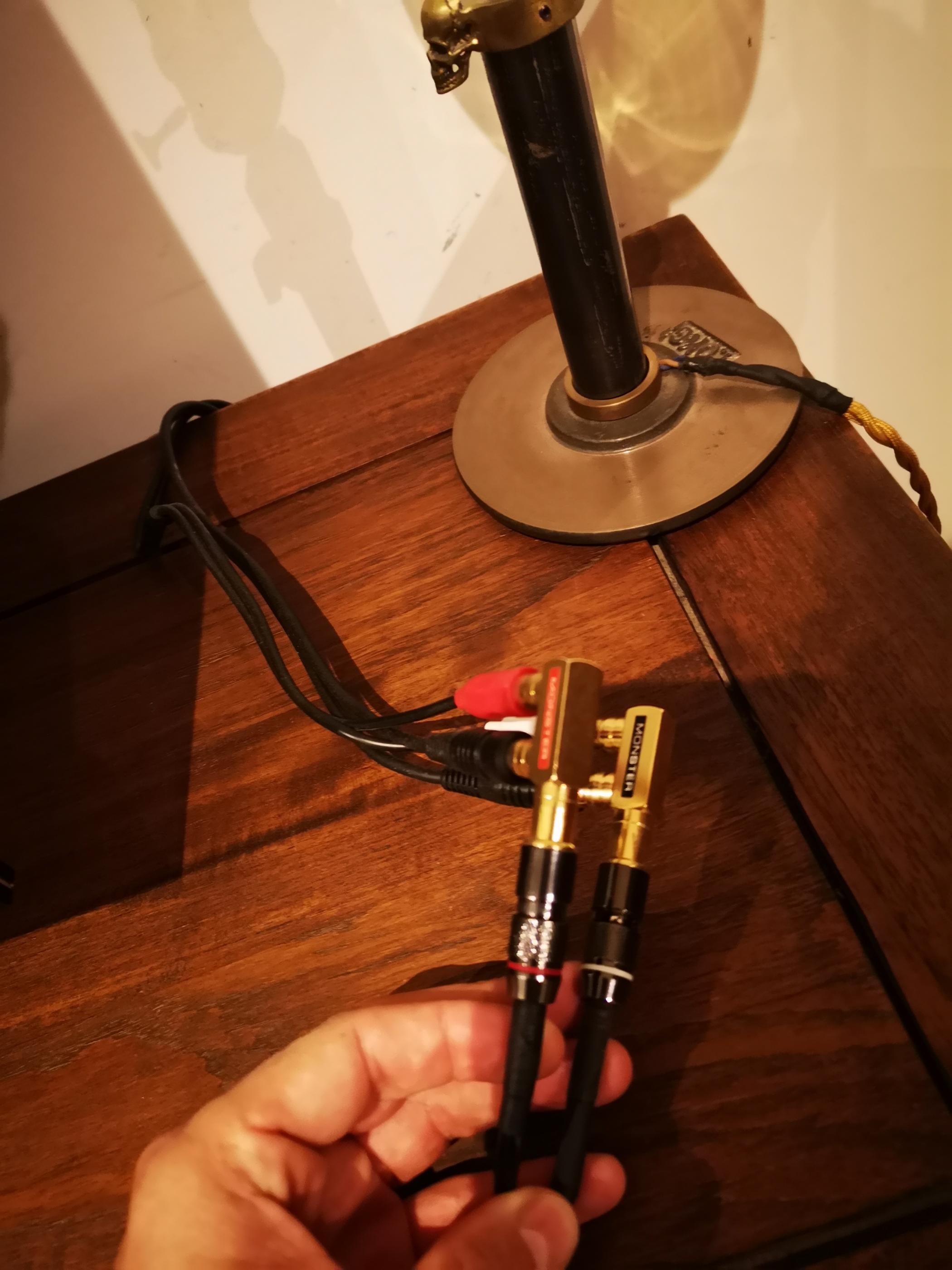

As Dnic said. You need power to move a sub. I have an customized aiyima and before it a splitter to divide the signal. Then a 1000 w inuke dsp and a diy jbl gto 12" and I'm very pleased with the sound. Whaferdale linton are my speakers.
So you mean that I can buy some Y RCA splitter and connect two outputs = my tpa3255 amp with 2.0 speakers + active subwoofer to second RCA
sth like that --> eSYNiC 2 X 1/1 X 2 L / R Stereo Audio Bi Directional Switcher With Mute Button Portable RCA Stereo Audio Switch Audio Splitter| | - AliExpress
This is the one I have. It's sounds very good.
