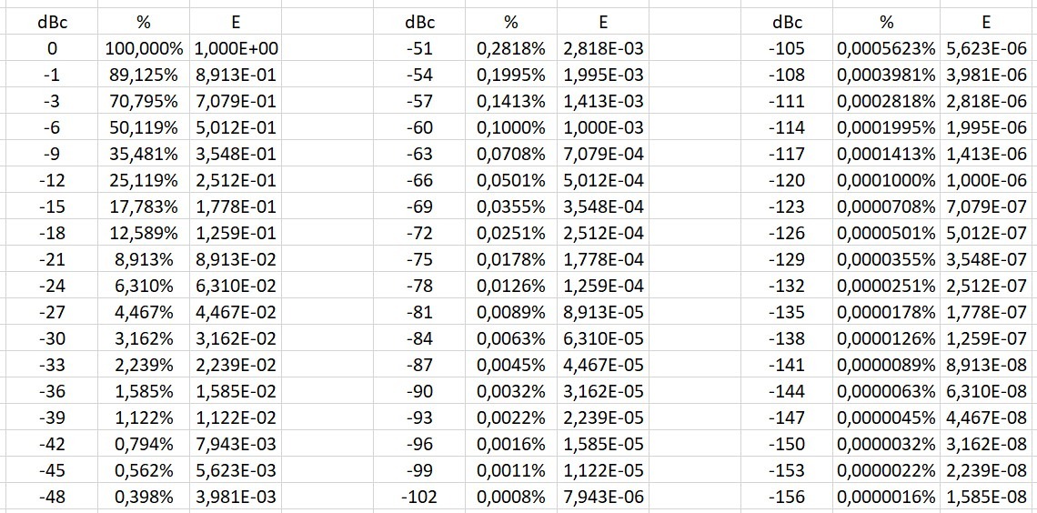

@6A3sUMMER thanks for the addendum.
I post here a table dBc - % - E to simplify the conversion:
