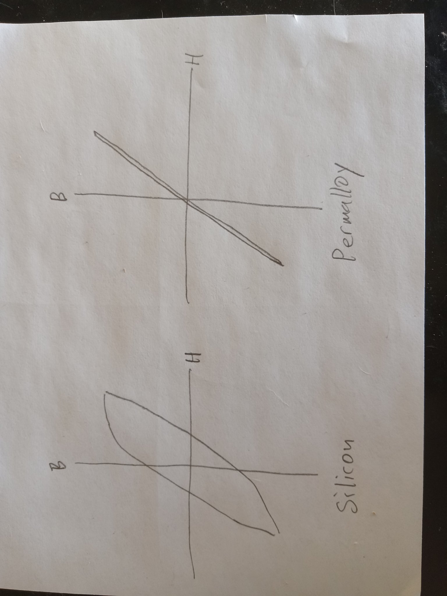

6A3sUmmer:
Hysteresis may seem horrific, but by no means all iron core transformers are grossly distorting. One example could be an interstage transformer working into infinite load (grid of a driven tube). Magnetizing current distortion will only cause signal voltage distortion if the load impedance is low (distorted current passing through resistor generates distorted voltage across it). Under conditions of low source impedance and high load impedance, distortion due to transformer core may be vanishingly low. This is very well explained in Crowhurst article on transformer distortion.
One more concern is the nature of the core material. In the graph below, there are B-H curves of silicon steel and 80% Ni permalloy on the same scale. Compared to silicon steel, permalloy has vanishingly low hysteresis; its magnetization is almost linear.
But, but, but, DC bias has a horizontal component. It (by definition) moves zero signal operating point of the OPT up (or down) the normal ("DC") magnetization curve.The upper curve on my graph is the magnetization curve of a SE transformer that represents DC bias and AC signal.
In early days there were magnetic tape recorders that used DC rather than ultrasonic AC to bias the tape. Bias in tape recording is needed because of the non-monotonic behavior of iron's B/H normal magnetization curve. DC bias proved too noisy, but otherwise works.
All good fortune,
Chris
Thank you for correcting me, Chris. Indeed, the hysteresis loop should be shifted not only upwards, but to the right as well. But the shape of the loop remains the same.
Mag tape is a different beast than transformer core material. Tape is more of a hard ferromagnetic (like permanent magnet) than soft core iron with very low remanence.

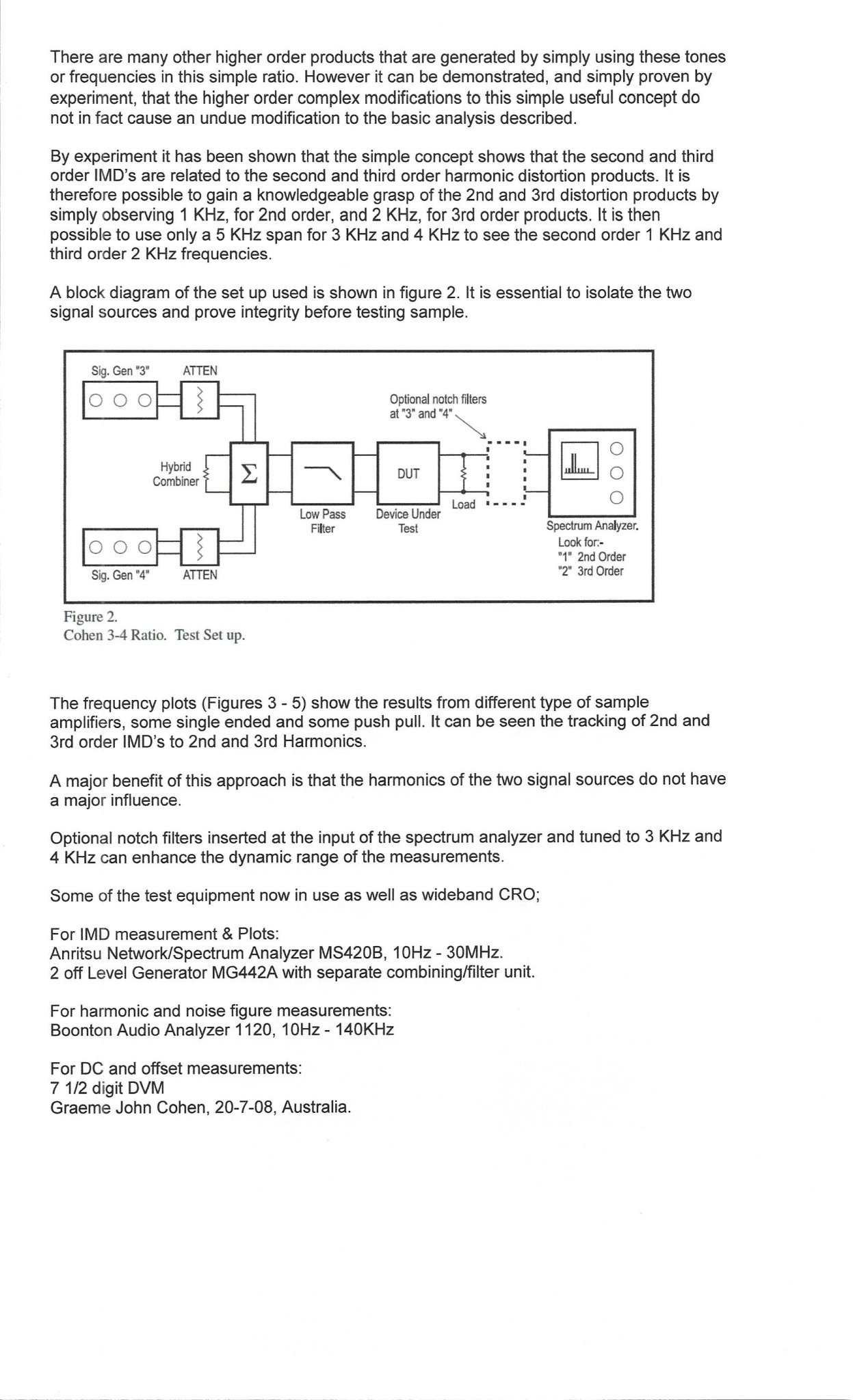

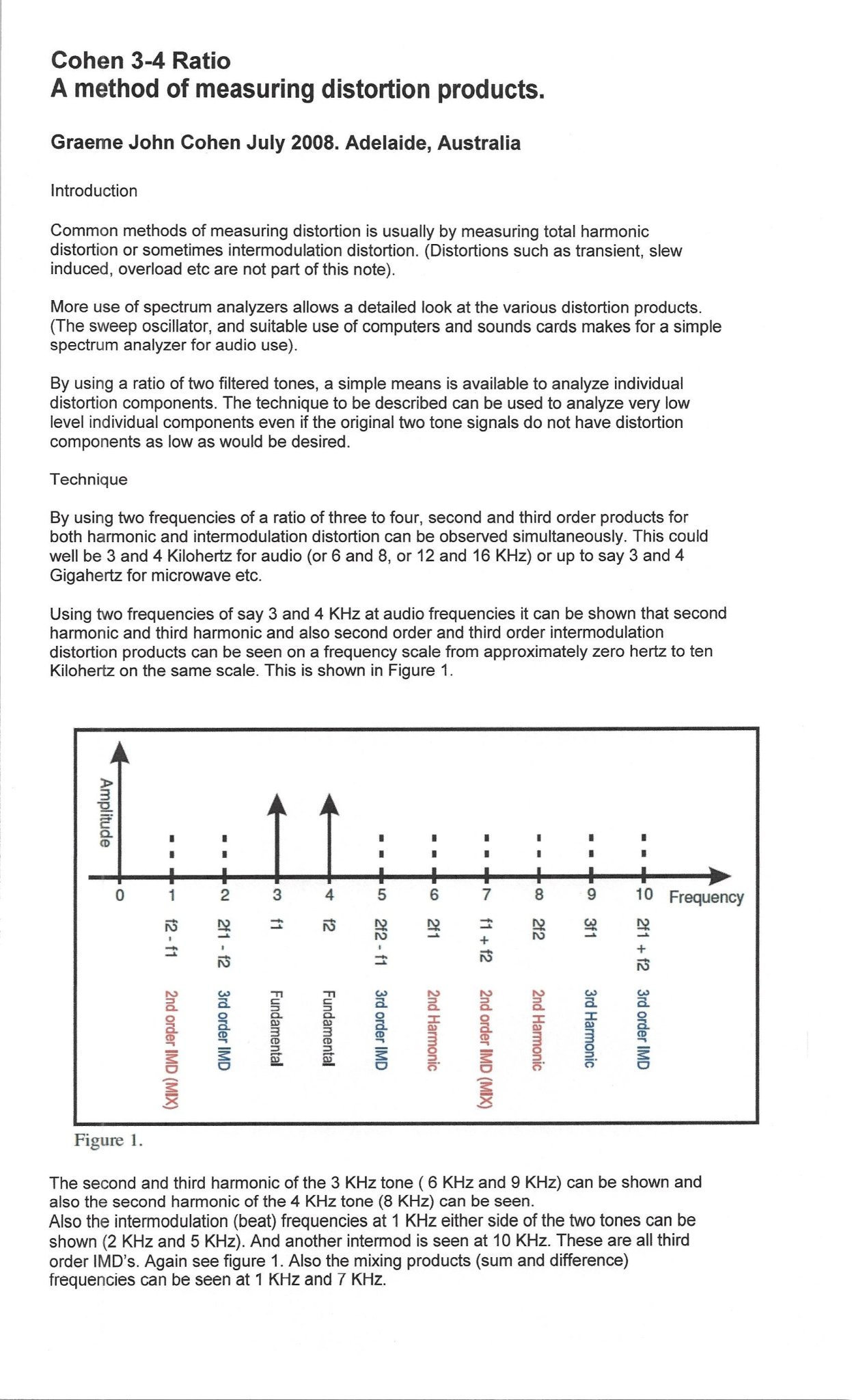

Such an amplifier was patented in Australia in 1999 by Graeme J Cohen.Build 2 SE amplifiers.
But it appears the patent was withdrawn in 2002. Probably a problem with some obscure prior claim.
The lawyers always come out on top.🙄
http://www.ipaustralia.com.au/applicant/cohen-graeme-john/patents/AU1996042023/
An article covering the amplifier was published in Glass Audio of March 1996,

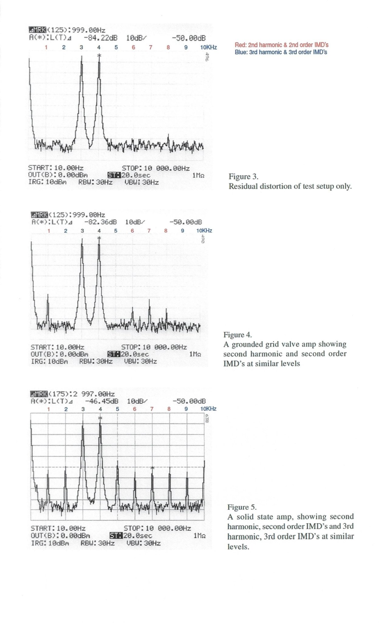

Cohen among several other papers published a very interesting technique to measure both THD & IMD at the same time.
I've used this method several times it is very effective. There is a listing of other work by Cohen on the last page of that document.👍
jhstewart9,
Thanks for the great dissertation from Mr. Cohen!
Boy!
Look at the comparison of the test equipment residual distortion; then the grounded grid amp distortion, then the solid state amp's bad distortion.
