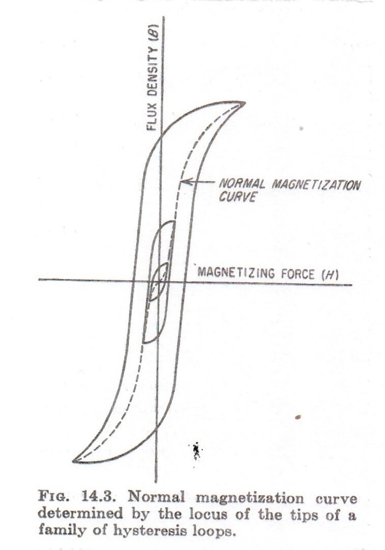

See Landee, Davis and Albrecht Electronic Designers Handbook 1957 p.14-3 Fig 14.3 which shows the normal magnetization curve derivation as the locus of the tips of the family of magnetization curves of various levels, on a B/H grid. It shows how the slope of the B/H curve decreases from its maximum when approaching zero crossing, and then decreases again when approaching saturation. The slope of the curve is permeability, and inductance varies directly with permeability (almost by definition).Anybody, please post those curve diagrams!

zintolo,
sser2,
Thanks for the Graph, zintolo.
I was wrong, sser2.
The Hysteresis curve for Push Pull is not a 2 Quadrant curve.
It is a 4 Quadrant curve.
Funny what tricks my 78 year old brain played on me.
Gee, that dotted line with the jog in the middle, looks like a Zero Crossing Error (it looks that way to me, make your own conclusions).
But it does not cause me to stop designing, building, and listening to both balanced amplifiers, and push pull amplifiers.
Now you know why I built the dual SE amplifier, drove them out of phase, and paralleled the outputs by reversing the + and common connections on one of them before paralleling them.
As I previously said, the French beat me to that topology.
Note: there is no "jog in the middle" when you combine 2 SE amplifiers that way (Just my theory, yet to be proven, or to be disproven, by those who are more knowledgeable about those things than me).
. . . Let's hear from you, if you have the proof or the disproof, please.

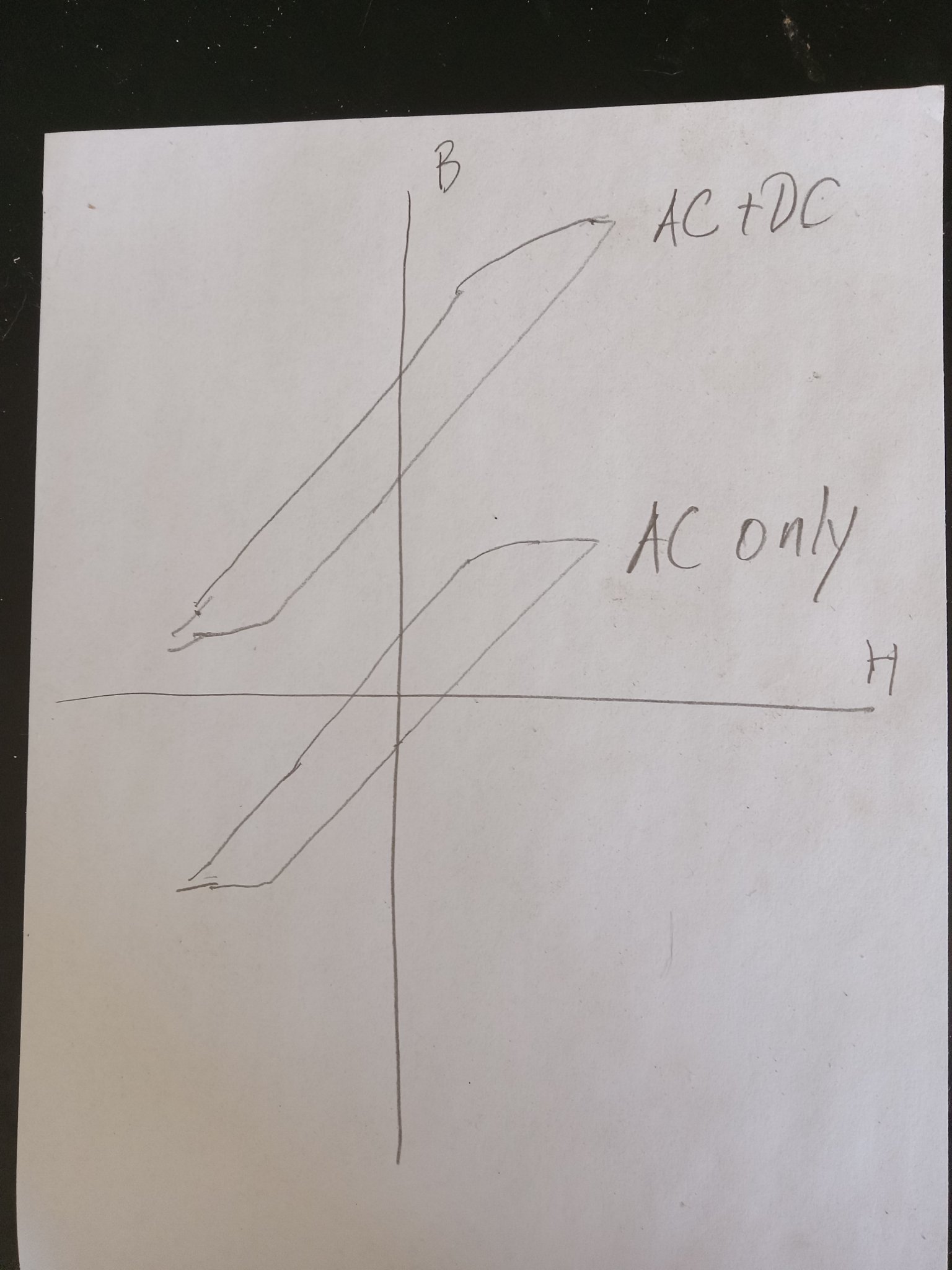

Hysteresis curves for SE are same as for PP, as Chris posted. Just shift the curves on the graph to account for DC magnetization.
sser2,
What Chris said:
" It shows how the slope of the B/H curve decreases from its maximum when approaching zero crossing"

Permeability, the slope of the B/H curve, doesn't effect signal directly, but indirectly, by its determination of inductance, it effects the shunt inductive parasitic load to the output valve. Effect varies of course with the importance of that parasitic shunt, varying with frequency and level. Significant amounts of nickel in the core straighten the burble through B/H zero crossing somewhat, and a series'd air gap rotates clockwise and stretches the normal magnetization curve.
Single ended amplifiers, with DC bias through the OPT, don't operate in this region, but with all of their well understood liabilties, are an extreme example of putting monotonicity foremost in design. One could argue that monotonicity is the most important characteristic of an amplifier. But that isn't well accepted, except maybe by me.

sser2,
Your curves in Post # 36 is very interesting!
Please draw in the normal magnetization dotted line that I saw on Post # 25.
Is that that the shape of the normal magnetization curve of an air gapped single ended output transformer that has quiescent DC current, plus signal current that increases and then decreases from that DC level, but that never approaches zero current, and never approaches saturation current?
I just want to know if there is any difference of that dotted curve's shape of SE versus PP.
