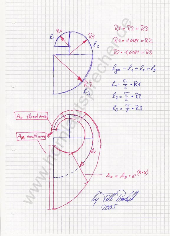

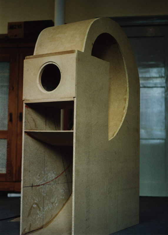

How could I calculate the horn bend/curve/fold geometry? I mean:
How can I calculate, draw and bend a straight exponential horn contour into ca. 270 grade bend like in the attached photo??
http://www.diyaudio.com/forums/attachment.php?s=&postid=724763&stamp=1126884821
Tyimo
Hi Tyimo,
this horn is also from me. I have build it 4-5 years ago.
on the drawing you can see how I bend my horns. Hope I can help you with that.
cya Till

ît was in 2000 and one of my first tries. A very expensive failure. It never worked well and that was the begining of my own deeper thougts ablut horns and how they could work. In several tries before a friend of mine and I have tried bigger chambers behind the speaker. After that he have changed the lenght and started with calculations. Now I am buling horns like the Replikon, FX-200 horn and so on. And now I can listen to them myselve.
