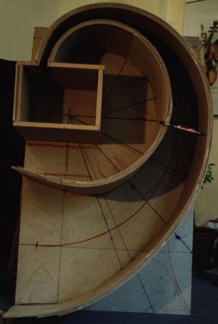

Hi!
I already asked this question in another threads, but didn' get answer yet, so I will try to ask here too:
How could I calculate the horn bend/curve/fold geometry? I mean:
How can I calculate, draw and bend a straight exponential horn contour into ca. 270 grade bend like in the attached photo??
Tyimo
Tyimo

Is this pretty similar to what you're trying get?
http://www2.mat.dtu.dk/people/V.L.Hansen/nautilus/naustory.html
Hi!
Thanks! Yes, I think it could be similar, but I have to re-read that site, because this Nautilus Math is realy "heavy" for me 🙂)
Tyimo
Tyimo

Tyimo said:Hi!
Tyimo
This site has some simple drawing tips.
http://jwilson.coe.uga.edu/emt669/Student.Folders/Frietag.Mark/Homepage/Goldenratio/goldenratio.html
GM

Is it possible to calculate the Helmholz resonant frequences in a Bass Reflex Box, but with expo-horn shaped port?? Is there any equation?
Yes, it should be possible to estimate the Helmholtz resonance of a bass reflex box with an exponential shaped port. No, I don't have a equation already derived. But using a little calculus to integrate and find the exponential port's volume, and being careful to determine an accurate end correction for the mouth, an expression could be derived.
Or, you could just plug the geometry into my BLH worksheet and see where the first peak is in the acoustic impedance plot. That should be very accurate.
