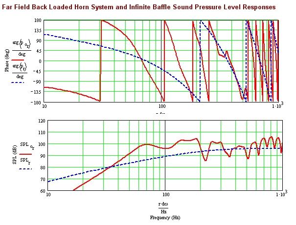

Right, found it (at last!).
At the time I did this, I was using Martin's MathCad worksheets to compare the results different horn desings would give using the same driver, in this case the good old Fostex FE206E. Whilst the Hedlund was designed for Lowther drivers, the Fostex specifications are usually relatively close to Lowthers, and I didn't want to introduce another variable (i.e. different driver types) into the comparison. As you can see, the response curve using the 206 isn't too bad. There's a fair bit of ripple, but nowhere near as much as some designs I've seen (and would rather not!) -the Jerrico, and several of the Fostex Factory designs spring to mind as immediate examples. Besides, horns are not known for an overly even response curve!
Approximate dimensions used were: Horn length 129"; mouth area 6.8Sd, throat area 0.25Sd. These were roughly calculated from Jan Hedlund's original drawings -certainly not exact, but they'll be near enough to give a general idea as to what's going on.
With, say, a DX3, I'd expect much the same cut-off point, (or perhaps a little higher) but higher spls below 100Hz -probably dropping somewhat around this point, then levelling off. If I'm correct in guessing this, then the 206 might well be a better match, as it's resonse falls away, but probably in step with room gain.
Hope some of this is useful
Best
Scott

Scott,
Looking at your calculated response curve shows me that the Hedlund horn is really more of a transmission line then a horn. Once you add the baffle step loss, say -3 dB below 200 Hz, the in room response is going to exhibit very weak bass. But I do agree with your assessment that this is one of the smoother back loaded horn response plots, that matches the observations I have obtained after analyzing many other back loaded horns. I have not looked closely at the Hedlund horn but analyzed the others you have mentioned.

MJK said:Scott,
Good point Martin -I'd forgotten about the baffle-step loss. Curses. Some form of correction is going be needed to get the best from it -ram them into the room corners too do you reckon?Agreed that like almost all other BLH designs you see it's more of a TL. This is the best / smoothest I've simulated, so credit where credit's due I suppose, but it's still only good in relative terms. I was building a horn myself for the FE103E, and I eventually gave up. I can get better results, or results that suit me better at least from other designs -ML transmission lines, and the open-baffles I'm now fooling with. On the up side, I suspect the Hedlund might have less in the way of horn-colouration than some, and it's quite an elegant thing, so there's room for all I suppose!
Cheers
Scott

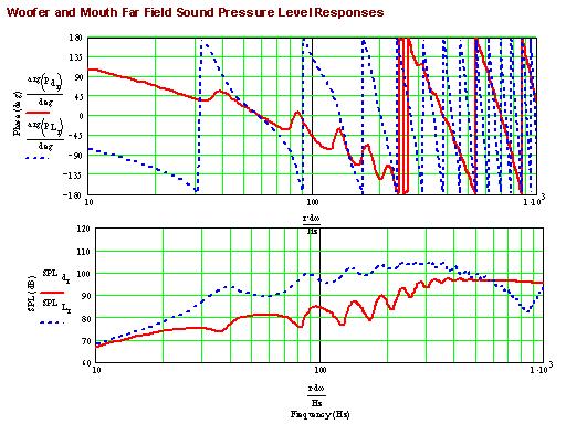

And here's my model of the Hedlund with a 2.7m horn length, keeping all the other approximate dimensions I used the same, and still assuming the FE206E. Remember, I wasn't trying for 100% accuracy -just for a rough guide / curve that shows what might be expected from a design and if it's good enough to pursue. On this basis, I would say that, if you want this sort of cabinet / type of speaker, this is still the best I've simulated, and is probably worth building.
Looking at the response curve, the cut-off point's shifted upward to circa 70Hz, and some of the ripple has smoothed out, bar one dip that has increased. To me it looks as if the earlier graph has been trunkated somewhat. I don't expect this model to be overly accurate either, but it will be close enough to show that the Hedlund is not a bad design for what it is compared to the majority of other 'horns' that are out there, and I have to admit, I do think the cab. and the folding geometry is rather elegant. With Lowthers it'll probably smooth out some more -after all, it was designed for those. I might try one last thing with it, just to see if it works -I'll let you know what later on.
Best
Scott
Best
Scott
Hi Scott!
You are fast!!!
This result looks like more BLH type than your last.
I think now you are very close to the original one's response.
I like the cab. and this kind of folding geometry too!!
I am very interesting to compare the Hedlund to another, for example to the one of the Fostex recommended enclosure....
I will try tomorrow my simulations....
