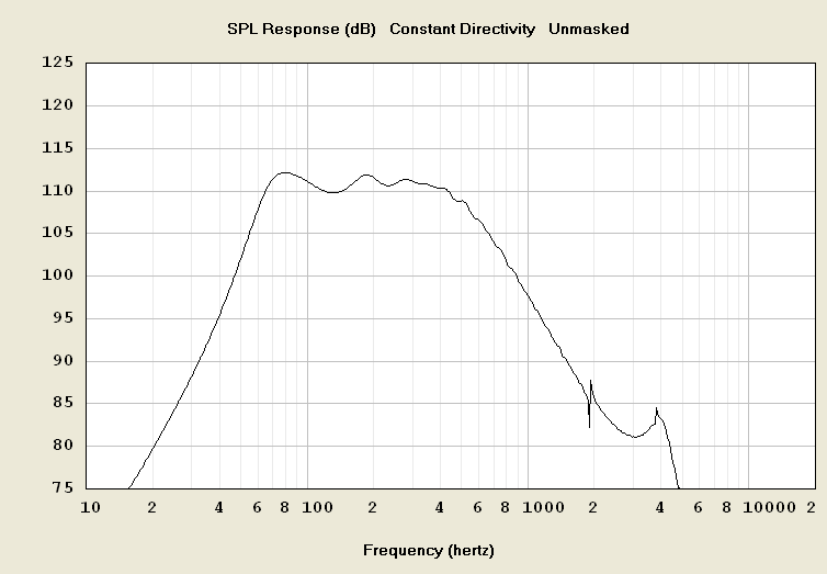

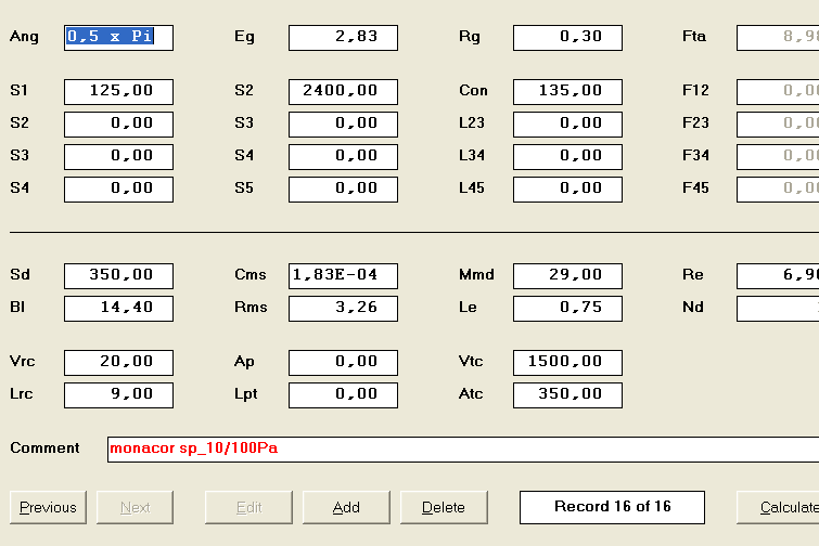

A other 68 euro driver sp_10/100pa monacor. In previous posts I forgot to play with the Vtc so play with it.
SP-10/100PA PA-Basslautsprecher IMG STAGE LINE

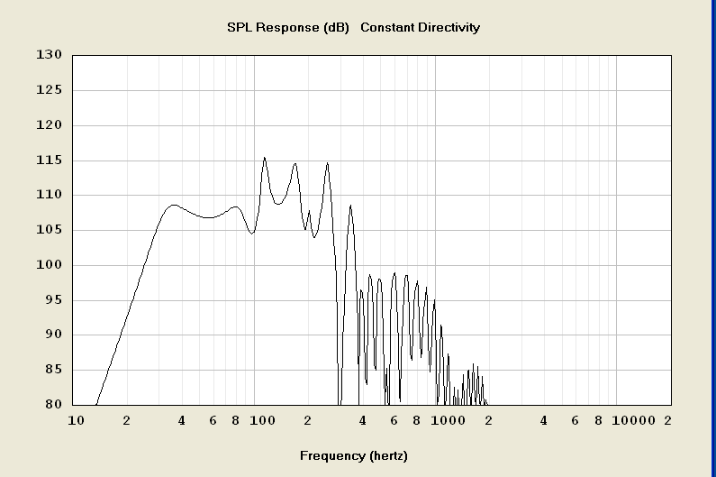

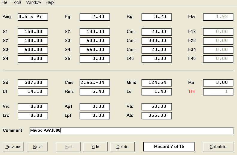

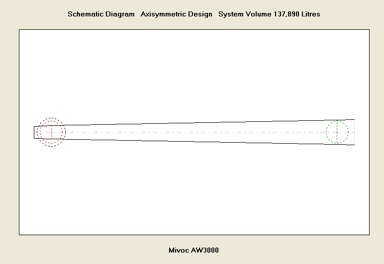

Tapped horn sub with 12" car sub woofer mivoc AW3000. 138liter due low Vas of the driver.
Edit: sim is done at 2,83V this is 2W for the 4Ohm driver.

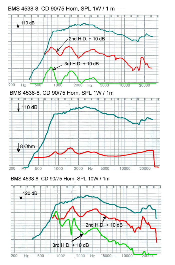

BMS-pro 4524 50Euro and BMS-pro 4538 70euro only they do not stop at 20kHz but at 30kHz.😉Which are the inexpensive but good drivers that go down to 1kHz and up to 20kHz?
B&C DE10 suburb response for hifi use 52 Dollar. With a good horn it will do 1kHz. There are a lot of speakerdesigners who make this roll of in thier XO so you do not have to correct it, it is perfect already.

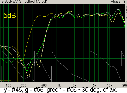

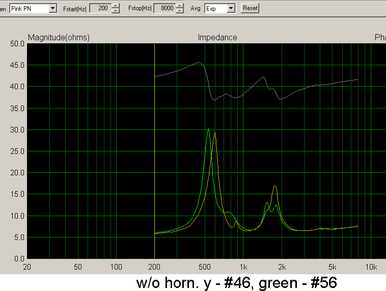

the sequel to http://www.diyaudio.com/forums/mult...ion-mid-h-f-range-drivers-12.html#post2838681
some quick rough measuremets of china k-74 3" drivers.
2380a's throat (not very good even in its original form) are gypsum plastered to 1.4" . don't know - horn or driver casuse some tin can coloration..
fr grafphs with EQ: bp (all approx.) 13 dB @ 1444Hz Q .6
