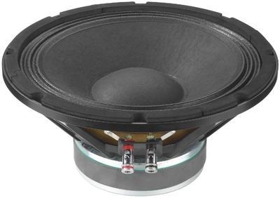

And here one for poor european guys.
Monacor spa12pa 45 euro. SPA-10PA PA-Basslautsprecher IMG STAGE LINE
