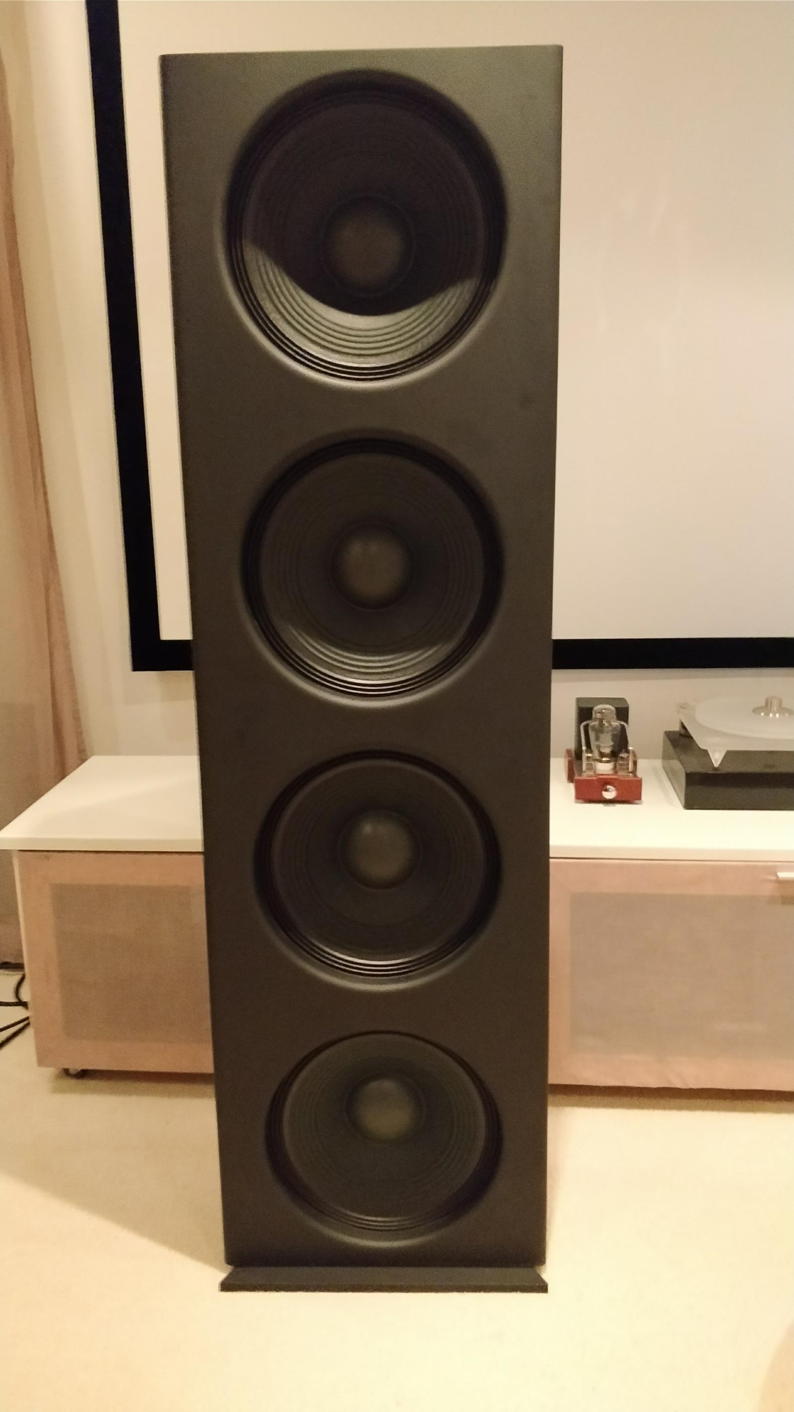

Reflector audio
True open baffle (meaning, there is no baffle). 4x18" woofers per channel with DSP. The most tremendous bass I ever heard.
Best, M
Best, M
