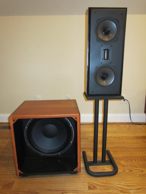

My implementation is more of a balanced approach--not the absolute deepest bass but a very good balance of bass/mid/treble. While in some ways relatively modest system the results are very musical.
It is an open baffle midrange with PHL Audio 1240s in an MTM and Aurum Cantus G2 tweeters. Eminence 3015LF Neo Kappitalite woofers in H-frame mounts handle the lows. The 3-way crossovers are via a DEQX PDC2.6 HD at 175 Hz and 2500Hz. I'm using 96 dB/octave slopes.
