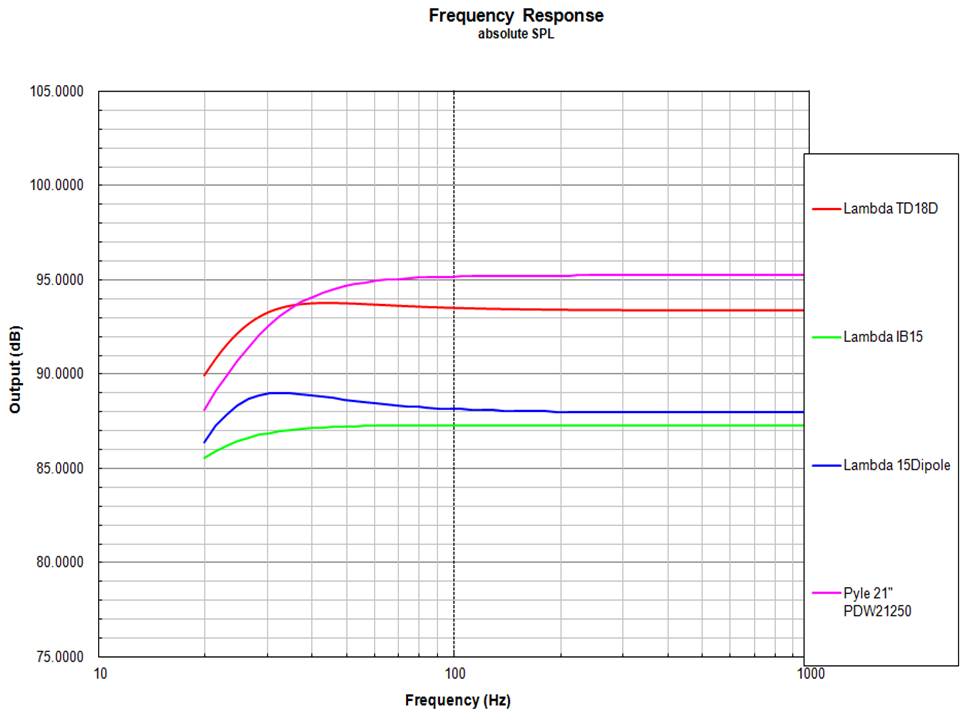

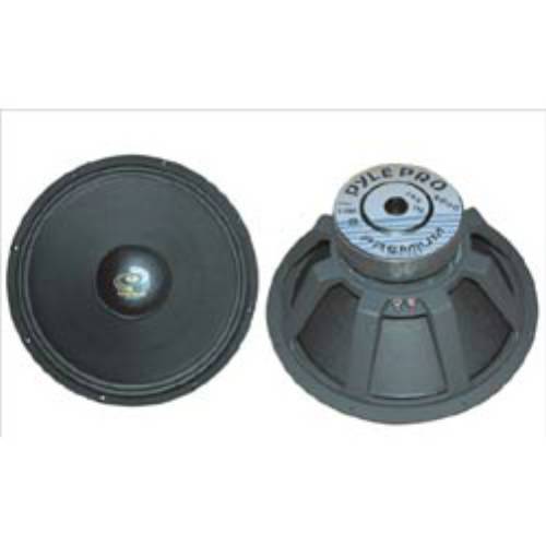

The Pyle PDW21250 21" subwoofer sells for less than $200 USD. There have been earlier reports of inconsistent T/S parameters, likely from out-of-spec parts and poorly controlled manufacturing processes. This driver was recently tested at Parts Express using a WT3 which produced the following specifications:
Fs: 27 Hz
Re: 7.8
Qts: 0.66
Qes: 0.89
Qms: 2.6
Le: 3.3 mH @ 1 kHz
Vas: 27 cubic feet
Mms: 150 gr.
Xmax: 8mm
DC R: 6.3
Similar T/S specs have been obtained from measurement by diyAudio members. I attached an XBAFFLE simulation of the Pyle21 and a few Lambda Dipole speakers for comparison.

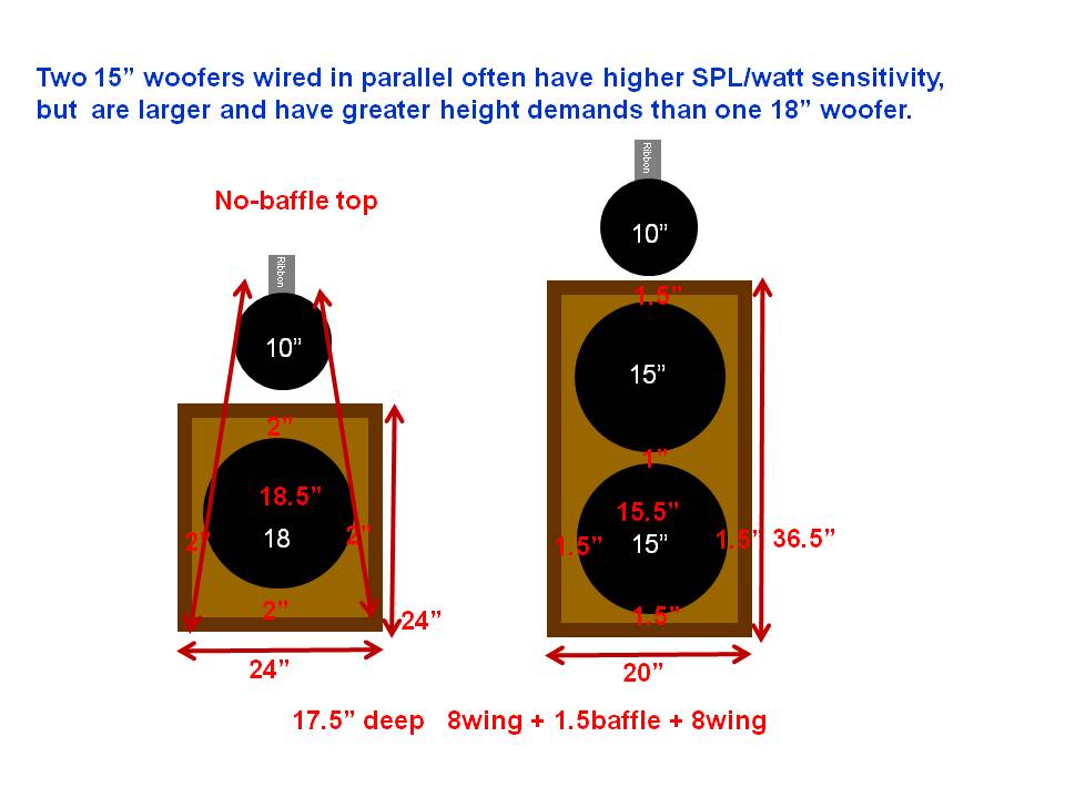

I have ten Lambda TD15D dipole woofers in our home. Wiring two TD15Ds in parallel delivers good SPL/watt efficiency, but a very large, very high H-frame cabinet. Today I would purchase six TD18D dipole woofers to get "good" efficiency with a shorter cabinet and superior wavefront launch.
The Lambda TD18D is a great "lifetime" dipole woofer. There are a few low cost 18" and 21" woofers like the Pyle PDW21250 that model well as both efficient and cost effective dipole bass. A $200 Pyle PDW21250 seem worth diyAudio evaluation.
JohnK's musicanddesign.com white papers on controlled directivity dipoles, like the NaO NOTE are worth study. I have been experimenting with 0.7" - 1.2" wide dipole ribbon tweeters which can Xover at 900Hz in an effort to meet JohnK's Fd demands with a 3-way dipole. (I love my Lambda TD10D midbass). Nude baffles and digital equalization .... dipole speaker research is still alive! An H-frame dipole woofer with a 18" - 21" will give you the foundation to experiment.
