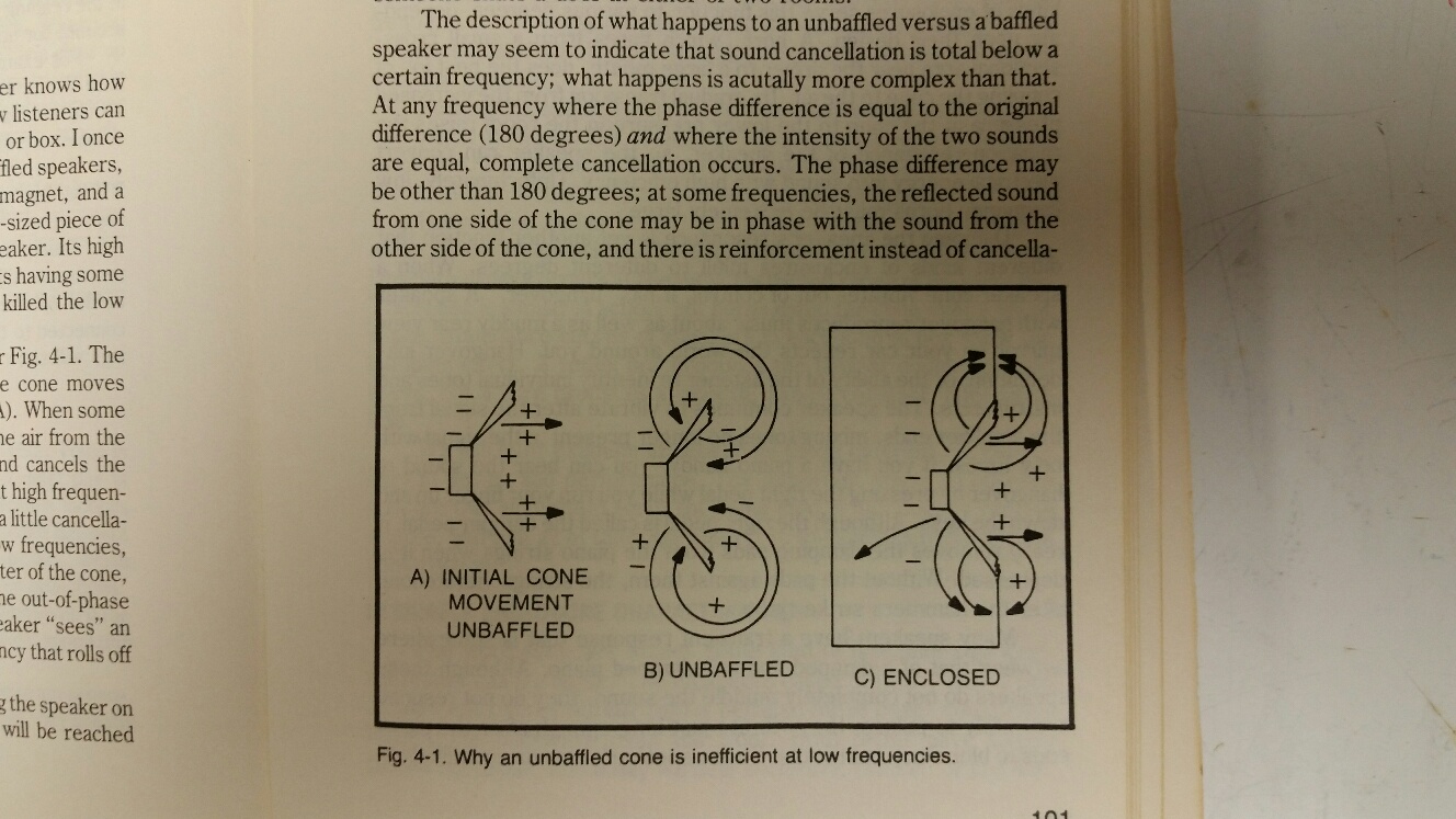

I dont get it? You either compensate with a large box or a “too big” woofer(s). There is no wrong or right. It’s all compromises
This is what I find fascinating about the cult: blatant denial.
I don't think anyone (who has a clue about OB/dipole systems) is denying that there is an increasing amount of cancellation at low frequencies.
Dipole bass works well down to some frequency, below which it becomes less and less workable due to increasing displacement requirements. If the listening space is quite large, this can be 25Hz or 30Hz. In a rather large rooms (like a large reception room) I have heard quite stunning OB bass that easily reached to 30Hz. But most people do not have such an environment in which to listen. Smaller spaces seem to suck the life out of dipole bass. So for DIYers in home environments, limiting the dipole bass to 80-100Hz and then crossing over to a closed box sub (or two) will most likely provide the most satisfying balance of bass presence and clean, uncolored midbass (and higher) frequencies.
There is nothing cult like about wanting your loudspeaker to sound good, and be free of coloration. But everything has its limit.
Yeah, I don't or didn't ever deny there were cancellations. Hardly cult like. What I do refute is the detractors who say how awful open baffle bass is and that it's a meaningless pursuit. All audio reproduction is a set of compromises and tradeoffs of some degree. Open baffle is no different.
Naturally a baffleless speaker will have a ton of cancellation, and one with a baffle will have less, and one in a box will have much less. Let's not pretend cancellations are solely the result of whether or not the backwave is taken into consideration. I've heard plenty of boxed rooms with huge cancellations and the sort that made the listening experience less smooth than some open baffle systems.

100 Hz di-pole is doable, I suppose, but still, the net result will be poor efficiency.
