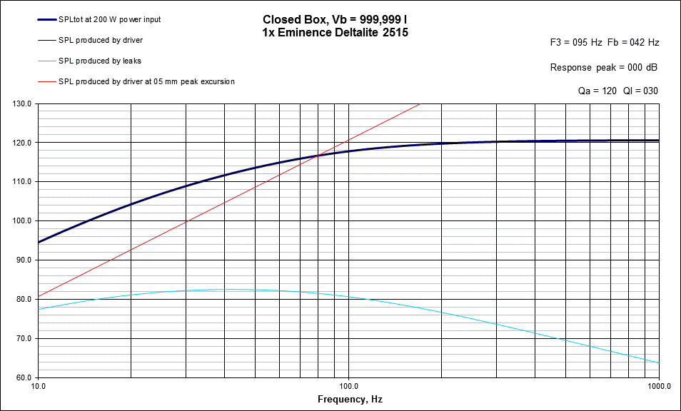

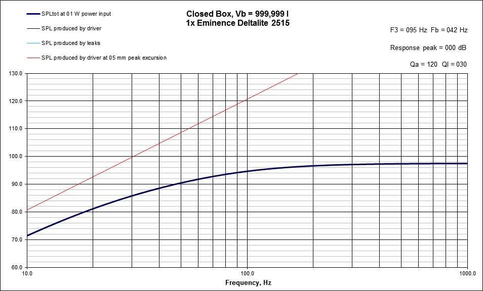

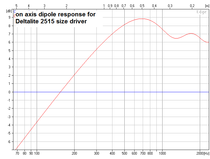

Let me give you an example and you (and others reading) can decide for yourself. I will use the Eminence Deltalite 2515.
I have attached three plots. The first is the dipole response gain/loss curve for the 2515, nude, that is just the driver without an additional baffle. I created this curve using the Edge using accurate sized for the radiating area of the cone and OD of the driver frame. The second plot is the infinite box (closed box of infinite volume) response for the 2515, as created from the MFG TS parameters, and at 1W input power. The third is the same IB response, but this time at 200W. This causes the driver to reach Xmax at 80Hz.
Estimating 1W sensitivity:
To get an idea of what kind of sensitivity we can expect from the driver at a given frequency, we need to combine the dipole response gain/loss curve and the 1W IB response. Let's look at 100Hz. The gain/loss curve model shows a loss of about 3.5dB there. The 1W IB response SPL at 100Hz is about 95dB. The sum of these is about 91.5dB, so we can expect this to be the 1W sensitivity of the 2515, when used nude, and at 100Hz. Because the gain/loss curve is not flat, sensitivity is a function of frequency.
Estimating max SPL:
Along the same lines, we can use the excursion of the driver at higher power to estimate the max SPL for a given frequency. The 200W IB response for the 2515 at 100Hz is about 118dB, and the excursion is just under Xmax. Again, we add the gain/loss curve value at this frequency (-3.5dB, as above) to get the SPL level, which is 114.5dB.
Comments:
For home audio, a 1W sensitivity of 91.5dB is above average. There are no additional "baffle step" losses that need to be factored in, like what is done with a closed box. This sensitivity is relatively high because the dipole losses are just not all that high at 100Hz and the driver's own IB sensitivity at 100Hz is high. Only modest input power (50W is plenty!) will be necessary for practical home use, since few people will need to reach 115dB with their speaker. Still, this driver (even without a baffle) will produce a lot of SPL at 100Hz if you want it to.
If you try to operate this driver down to 50Hz (another octave lower), the dipole losses increase by 6dB. Also, as you can see from the IB response curves, the driver's own output is falling off at 50Hz because you are nearing Fs, and this would add a further 5-6dB decrease in SPL. While you can try to compensate for this by increasing power as frequency decreases, you would need 12dB (8 times) more power at 50Hz! Since we are already near Xmax at 100Hz, the maximum output at 50Hz is also 12 dB lower. Not only would this require very high input power that may exceed Pe, the driver does not have Xmax to produce the same output at 50Hz compared to 100Hz. It's a losing proposition.
I find it better to keep the usable sensitivity high by not doing that, and instead cross over to another driver that is better suited to provide the necessary SPL at these lower frequencies. When builders allow the losses to compound too much, they can find themselves disappointed by the result. Even though this is a 15" driver, I cross over no lower than 80Hz, especially because of its limited Xmax. By removing the low end requirement, excursion is kept low and this driver can be used as high in frequency as is practical, which turns out to be remarkably high for its 15" size.

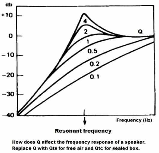

An old graph that is often forgotten. (bass roll-off towards fs vs. Qts/Qtc)sometimes due to a high Qts woofer
I consider high Qts-woofers as woofers with built in EQ.
Take that Visaton WS25E you´re using for instance; it plays down to its fs easily but just as an heavily EQed woofer you´d have to watch excursion if you don´t high-pass it or take 2-4 per side (depending on aimed SPL).
That said there is probably a sweet spot for Qts (in contrast to higher Qts is better). Can´t remember where and why but Linkwitz mentioned a Qts of 0.5 appropriate.**
One has to consider though that his speaker systems were mostly active.
When designing passive it makes life/XO easier when using a woofer with Qts>=0.5.
