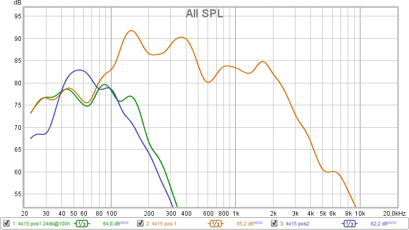

And here I am. About 6 month later, and I am very very pleased with the sound I get. The speakers go deep. They start falling rapidly at about 28 Hz. So I guess the listed FS at 26 Hz is about right. I cross them over at 100 Hz 24dB-LR filter. I wouldn’t go much higher than about 110 Hz. The sound is deep, punchy and has good detail. 8 woofers move a lot of air and thus the distortion is low. But 4 woofers can also do, the job nicely.

Here are some measurements:
I have measured te frequency responce at 2 different positions in my room, to show how big an impact the romm has on the bas responce.
I have also included a measurement, with no x-over. The x-over is 24db @100Hz

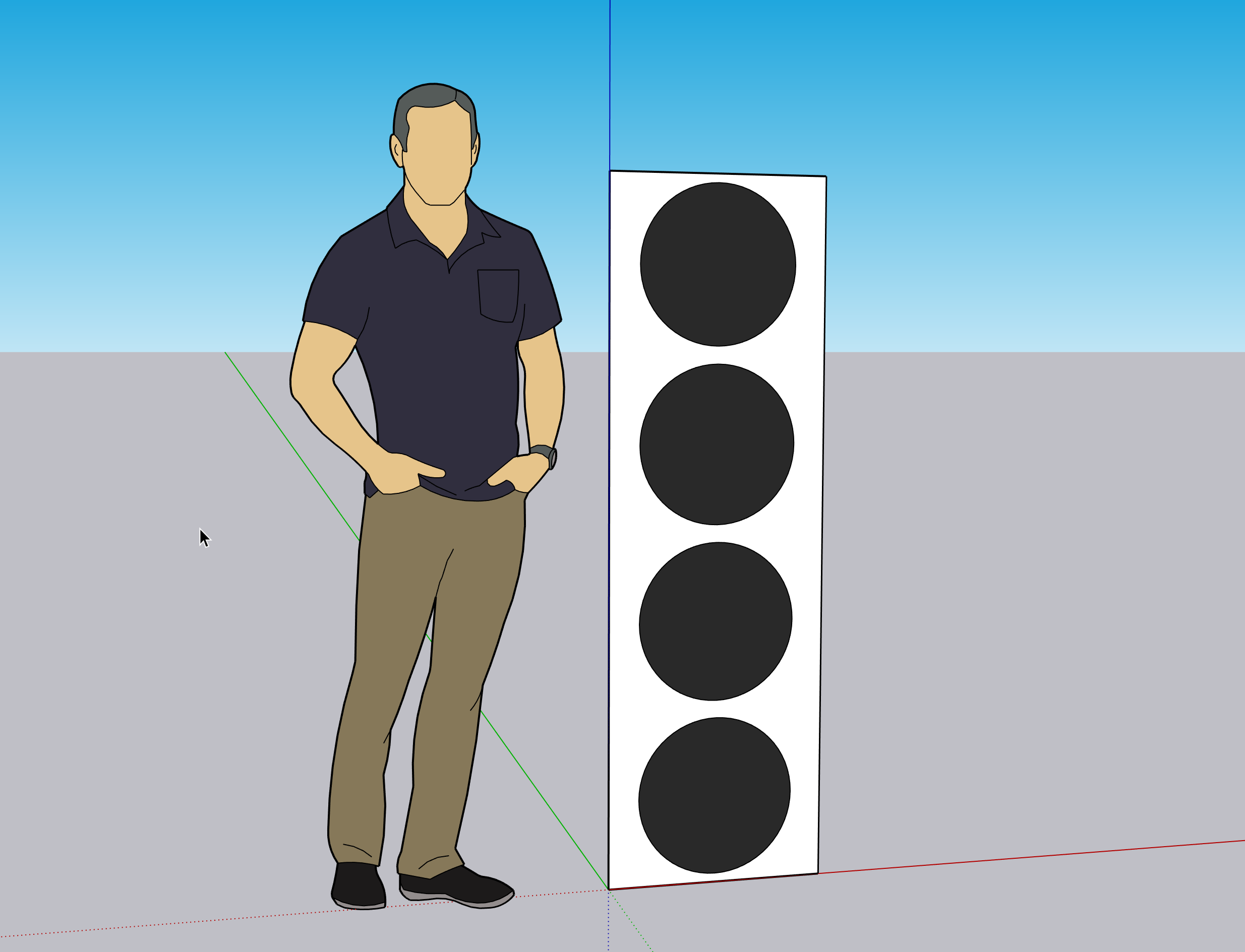

Thank you for your swift Reply Mikkel! I was thinking using an inexpensive woofer like:
vervangingsspeaker 15 inch kopen? - Elektronicatekoop.nl
or a GRS like this one:
GRS 15PF-8 15" Paper Cone Woofer
GRS 15PF-8 woofer kopen - SoundImports
Not the best for open baffle im sure but close enough and the combined cone area should compensate for low bass response quite a bit.
Made a quick sketch:
Gr, Mike
I would go with the GRS 15PF-8.
