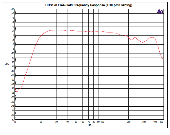

You didn't mention actual level desired, but one box I have been quite pleased with is the Mackie HRS 120.
It is -3 dB at 19 Hz, 117 dB one meter free field response. Not bone crushing loud, but when you start looking at LF levels down deep, pretty respectable, especially considering an internal volume of just over 2 cubic feet. Uses a 12 inch woofer with "over 45 mm cone excursion" and a 12 inch passive radiator powered by a 400 watt amp.
Oh, I am a big fan of the P-2200, they can do 350 watts at 4 ohm, 500 watts at 2 ohm, but current limits below 2.8 ohm. I wouldn't doubt they can put out 700 watt peaks at 4 ohm, that is one amp that always seemed to do way more than it's specs would say, unlike most of today's amps.
The HRS 120 response in my small control room with it in a corner goes well below 20 Hz, while doing the digital equivalent of "tape scrubbing", it has hit the resonant frequency of the sheetrock behind it, the walls literally were shaking at around 15 Hz or so. It will visibly move the control room door, which is quite heavy.
I purchased the sub used, after demoing it in a large showroom. I was impressed that it had enough guts to excite the reverberant field at VLF frequencies in around an 8000 square foot room. It made all the other studio subs I had demoed that dayseem like toys, they all chuffed and coughed when pushed, the HRS 120 could shake stuff and flutter pants legs.
It is one of the few speakers I own that I have not built myself. I can't think of any speaker with much better LF output to size ratio, and believe me, I have looked at a lot of options. It also sounds quite good.
The response below is with the 15 Hz HP filter engaged, the spec sheets don't show the response without, but it does seem to handle VLF "junk" without any audible sounds of destruction, even if it may not put out much level below 15 Hz.
