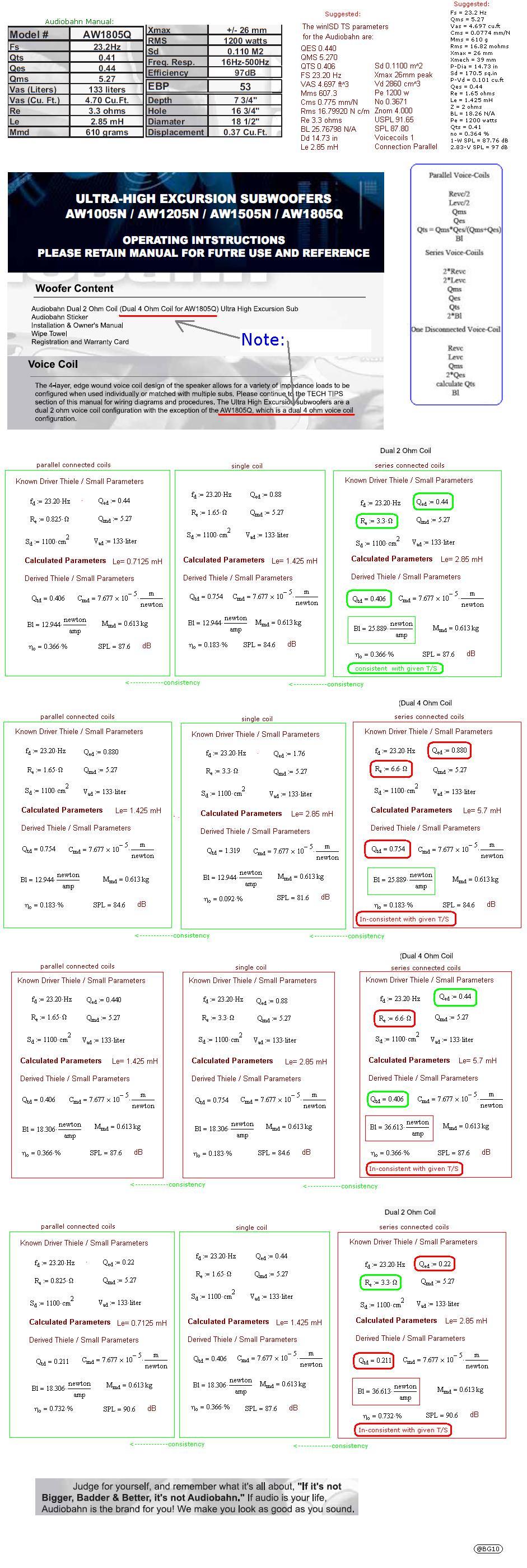

That's exactly what I am looking for, however my enclosure is cut for an 18' driver and 2x 4' vents.
So what can fit in it if the JBL is too fragil and the Audiobahn is unheard?

The whole goal of this tread was to see if anyone could help me find out why the Audiobahn AW1805Q was not performing well in a 12^3 foot box that is supposed to have been tuned to 20Hz. Unfortunately only a few comments have offered anything I can try do to remedy the problem.

IMO: A piece of cake but...
The whole goal of this tread was to see if anyone could help me find out why the Audiobahn AW1805Q was not performing well in a 12^3 foot box that is supposed to have been tuned to 20Hz. Unfortunately only a few comments have offered anything I can try do to remedy the problem...
First,You have to bring order to the Audiobahn T/S mess: See the picture..
b🙂
