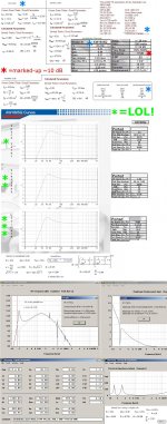

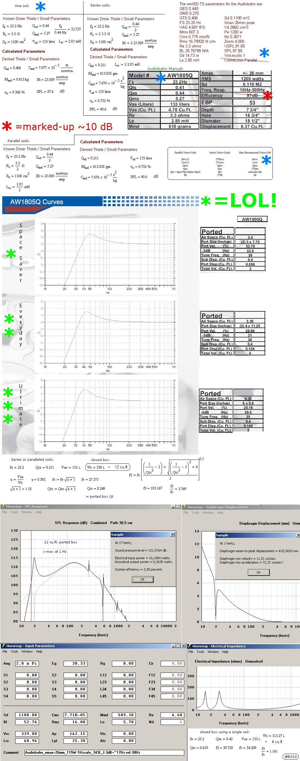

FYI,
No need to use fudged numbers:
b![]()

At this time I am also questioning whether the TS parameters I have are correct, if there is anybody out there that knows the true TS values for the Audiobahn AW1805Q let me know if the values I listed earlier are correct.
The quoted Re suggests that those published values are not correct. If each coil is 3.3 ohms, quoted Re should be either half that figure or twice that figure.

This is what bassbox gives for both coils in parallel.....
Fs = 23.2 Hz
Qms = 5.27
Vas = 4.697 cu.ft
Cms = 0.0774 mm/N
Mms = 610 g
Rms = 16.82 mohms
Xmax = 26 mm
Xmech = 39 mm
P-Dia = 14.73 in
Sd = 170.5 sq.in
P-Vd = 0.101 cu.ft
Qes = 0.44
Re = 1.65 ohms
Le = 1.425 mH
Z = 2 ohms
BL = 18.26 N/A
Pe = 1200 watts
Qts = 0.41
no = 0.364 %
1-W SPL = 87.76 dB
2.83-V SPL = 97 dB
The program suggests a 6.8 cubic foot enclosure tuned to 19Hz. Two 4" ports would need to be ~25" each (a slot port would be ideal here).
