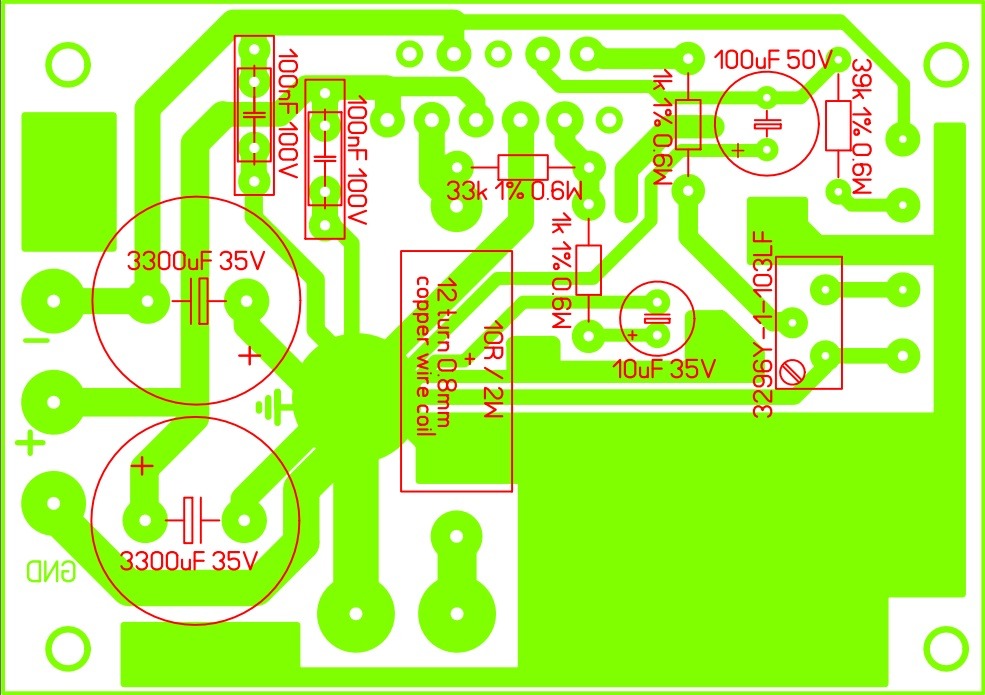

Have you an advice for a good LM3886 diy PCB (I like to make my own PCB, despite I know that Neurochrome PCB is excellent)?

LM3886 is a good example too http://generalguitargadgets.com/pdf/ggg_lm3886_amp.pdf where existing PCB drawing in first page is fully functional. Also, the LM3886 IC is in production and available, and finding genuine should not be a problem.
If it helps, here is a LM3886 PCB made at home with using the fastest - toner transfer method, the dimensions are a little smaller than the original GGG drawing. 75.7x53.5mm are the dimensions of this PCB. Since I don't have a lot of software on this computer I'm using at the moment, unfortunately there is no way to convert this file directly to pdf, but this pdf document without changing it should maintain correct proportions. If someone needs this file, I have it in lay 6 format (it was not an allowed format here therefore I cannot post it to the public).
