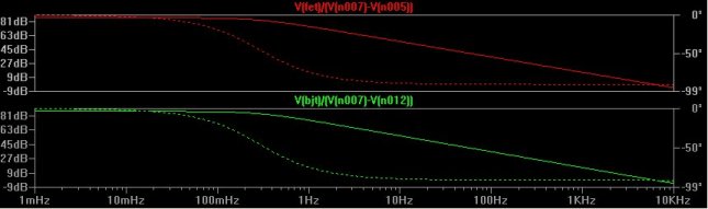

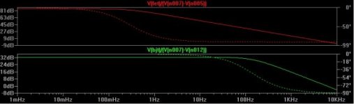

Rodolfo, I don't understand what you have done with the gain char. of the bjt side. It is no longer operating as an op amp, as the open loop (OL) gain is ~32dB. Further, the open loop bandwidth (OLBW) is >10Hz, which means that the FFT setup jcx devised is not operating the bjts in the -6dB per octave/90 degree region.
I have attached two dual plots to show this discrepancy, one with your settings (Rodolfo fet_bjt_compare.jpg) and jcx's original setup as modified with added bjt emitter resistances of 210 ohms (jcx equal gain bjt_jfet.jpg).
The OL gain (dB) of the JFET side can be approximated by 20*log(R3/250), where 250 ohms is the FET dynamic resistance at 1mA. This works out as ~86dB, as noted in the plots.
The OL gain (dB) of the bjt side can be approximated by 20*log(R7/(210+re)), where re is about 26 ohms, the bjt dynamic resistance at 1mA. This also works out as ~86dB, as noted in the plots.
But, with your modified values, the OL gain on the bjt side drops to about 32dB, and the OLBW is >100Hz. It would appear that what you have done is to extend the OLBW to well above the bandpass where the bjt distortion products would fall. This would appear to give an entirely different picture than jcx's simulations.
Walt Jung
With this in mind, I modified both the Miller integrator resistor from 5 Megs to 10k and rised the feedback divider from the original 13 / 1 to 1300 /1. In doing so I lowered significantly the applied feedback.
The other variation is to include 210 ohm emitter resistors for the bjt pair - following jcx advise - bringuing the equivalent transconductance to aproximately the same as the one corresponding to the fet pair.

Hi Walt:
I scrambled back to the sim to find what I could have messed but couldn't. I must be overlooking something, for I do not find the discrepancy that should be bringing down the bjt gain down to 32 dB as you show.
Please advise which are the nodes (once you change something in the schematic, LTSpice will renumber them) you choose to compute the ploted responses (i.e. V(bjt)/(V(n007)-V(n012)) )
With respect to the OpAmp condition, I was not particularly concerned with keeping with the OL bandwith and rolloff. I interpreted the current subthread focused on input stage behavior, and in fact as I expressed previously, I somewhat dislike the idea of closing the loop with high gain ideal devices.
To that effect, the following post presents results where the loop is disposed off altoghether, so as to unveil the bare transfer characteristics of bjt vs. fet differential input pair.
Thank you for your comments Walt, will keep waiting.
Rodolfo

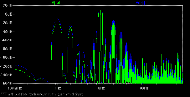

bare bjt - fet diff input pair
Delving further into the bipolar vs fet transistor technology for the differential input pair, I stripped the original test circuit by jcx of all loop feedback elements.
I kept the collector / drain current mirror loads and adjusted the bipolar pair emitter resistors to obtain the same voltage gain provided by the fet pair. This results in outrageous 39K values that only highlight the large difference in gain afforded by each. The large values nonetheless have the beneficial effect of greately improving stage linearity.
Biasing conditions are the same as previous tests.

bare bjt - fet diff results
The previous test circuit yields the fft plot attached below.
This simulation is not a good approximation to reality as indicated in a previous post because of (almost) infinite impedance loading in the output devices. A better one is forthcoming.
The high level of harmonics and IM products are simply the result of bare device nonlinearities.
In this case, the result is more in line with what was to be expected in that the fet pair presents lower departures from linearity than the bjt pair even with gross emitter degeneration.
Yet, as could be seen in previous results, the higher gain afforded by the bjt pair can be used to advantage to correct and surpass performance, but then it should be noted the actual feedback elements should not degrade overall open loop response, that is, they should behave as nearly as possible to ideal devices as per simulation.
Rodolfo

WaltJ said:Here is an AC sim that shows matched bjt and FET gains.
Walt Jung
