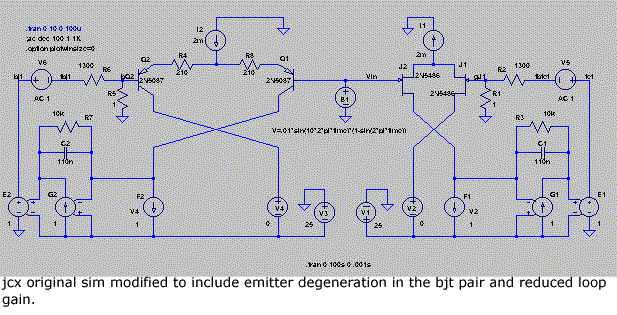

bjt - fet input comparison
Taking from the excellent work by jcx, I tweaked the simulation a little more in order to address some issues raised at least in my oppinion.
The original simulation makes clever use of some tricks in order to isolate what the actual device behaviour is and as such it works fine.
Yet I was left with a nagging feeling the configuration does not match adequately with actual operating conditions in the field.
The strong feedback constructed from ideal controlled current and
voltage sources could in principle be emulated by a local FB loop (in the case of an actual amplifier) but could not be really applicable to a complete device (i.e. a global loop).
With this in mind, I modified both the Miller integrator resistor from 5 Megs to 10k and rised the feedback divider from the original 13 / 1 to 1300 /1. In doing so I lowered significantly the applied feedback.
The other variation is to include 210 ohm emitter resistors for the bjt pair - following jcx advise - bringuing the equivalent transconductance to aproximately the same as the one corresponding to the fet pair.

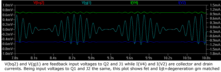

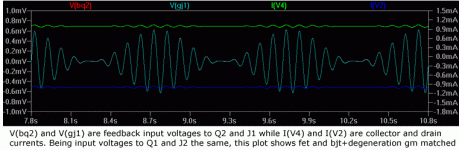

bjt - fet waveforms
A further observation is both Q1 and J2 are loaded by high impedance current sources, and I am not convinced this situation is fair or representative, a cascode load for the fet in principle should be a distinct advantage for several reasons. The bjt by nature behaves much better as a current source and is therefore less affected.
The selected input signal level and operating point I find is more nearly matched to what is to be expected for an input stage.
This plot shows input voltage to the diff pairs and collector / drain current. Input signall voltage is from the same source, and feedback voltage plots superimpose neatly as can be seen.
Input voltages are almost identical and output currents are also alike, meaning equivalent transconductance for both pairs if fairly well matched.
