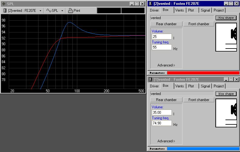

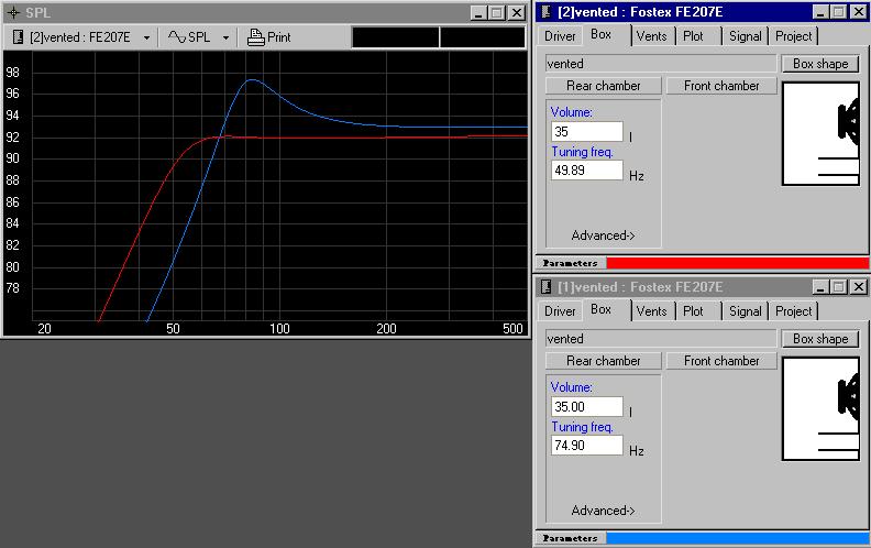

The other way is to add 1.5Ohms (red line) in ser with the speaker and decrease the sensitivity by 1dB, use the same box and tune the port frequency and I get a nice curve that goes much lower than recommended. Or maybe they know that most people will use it with a tube amp and have high output impedance (1-2 ohms) and that why they suggested the enclosure the way they did, but the port dimentions ar wrong that way too.
What would you do? Would you use a resistor?
/Greg
/Greg

Hi GregGC,
The Fostex design with the big hump at resonance is probably an attempt to beat the baffle step problem by producing a greatly exaggerated (spelling?) bass. I bet that design sounds terrible with booming one note base.
The flat design you plotted looks nice but my guess is that the program treats the speaker as if it were working in 2 pi space over the entire frequency range. That is also what my MathCad worksheets assume. So if you built that design, the bass would sound weak. If you go the the phase plug thread, going on now, you will see some of this discussed along with some explanation on how I treat the baffle step in Fostex and Lowther ported enclosures.
There is also a short write up on designing BSC circuits on my site under the Genrral Speaker Related Articles heading. This document shows how to size a BSC and how to adjust it to get the best performance.
Hope that helps,
Hope that helps,
