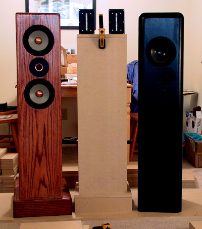

BrianGT said:Here is what the sheets tell me for the recommended 8.5" port and no stuffing. Their cabinet had similar dimensions also.
Brian
since the "original" cabinet has ripples, does this mean that it's a ML-TL?
Bricolo said:since the "original" cabinet has ripples, does this mean that it's a ML-TL?
I guess that they both are ML TL... I showed the second one, as that is the one that the manufacturer recommends. I guess the next step is to listen to it and just try different configurations.
The cabinet looks different, since it looks short compared to my Peerless Pipes and Seas Thor TL. It will look much better when I add a 1.5" roundover.
Brian
I have been thinking about the BR and ML TL question all afternoon. I have no clue where the transition point is between the two designs. But the major difference is the constant pressure in the box for a BR helmholtz resonator and the standing wave with local pressure peaks in the long direction of the box for a ML TL. I have found that the amount of bracing needed for a ML TL is less because the pressure is local and for the first mode peaks at the top of the box where it is strongest. Also, in a ML TL damping is used which I believe helps with the leakage of higher frequency noise out of the port.
The point at which a BR becomes a ML TL is not clear to me. Again, I don't really think spending a lot of time trying to assign labels is worth the effort. If the simulation looks good then build the design and enjoy the results. If you realy want to be sure you have a ML TL make it tall. If you really want a BR make is almost equal lengths in all dimensions.
