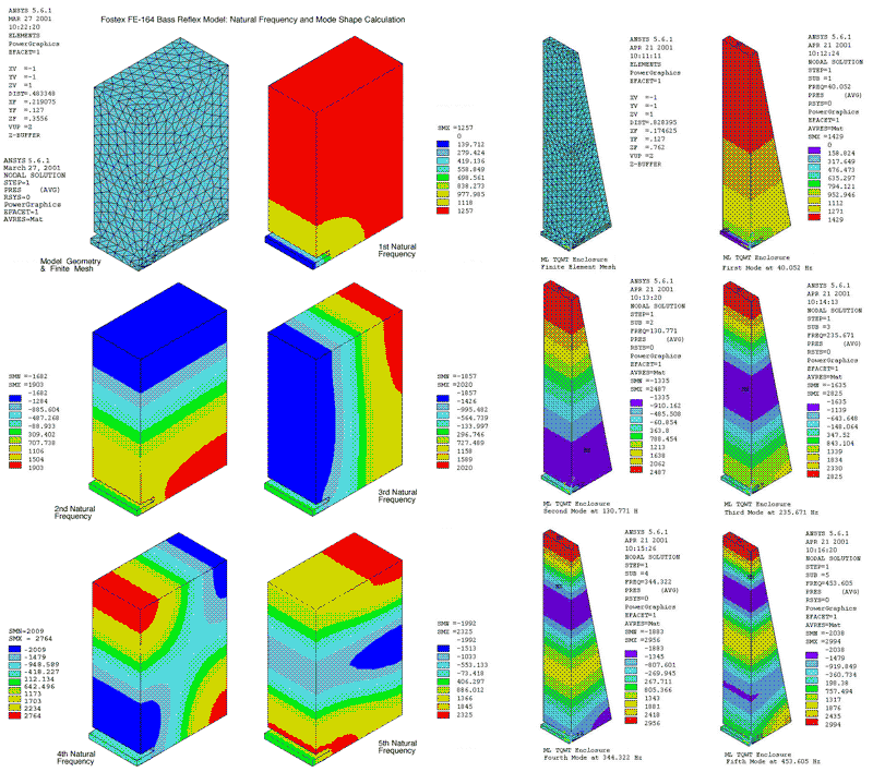

Here is a picture collaged together from Martin's ANSYS simulation of a BR vrs his 1st ML-TQWT which clearly shows the different characteristics caused by a stretching the box... both have the same driver, volume & port -- the only difference is shape. The image is still not finished -- it got back-burnered when my emplyment situation deteriorated shortly after Martin 1st published this -- it is part of an unwritten commentary on TL design for my site. (i did get an Intro finely written & up.

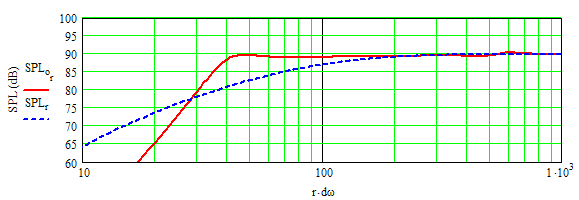

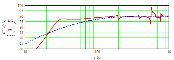

First, become familiar with what the quarter-wave harmonic series looks like. Simulate an end-driven TL, that is, the driver at 0.01*L. Now simulate a cubic BR. These are the limiting cases. As a BR morphs into a TL, you will see the quarter-wave pattern develope.
If, by the quarter wave harmonic series, you mean the dips at n*Fp, yes I see what it looks like.
The BR is ruler flat, no or minimal peaking at Fp
Do you mean that a ML-TL is somewhere between the 2? Acting a little like a BR and a little like a TL?
Except from the dips at n*Fp (that can be damped with more stuffing), I don't see much difference on the other graphs.
No, No! Being a quarter-wave pipe is like being a little bit pregnant. It either is or it isn't. The quarter-wave harmonics may start out weak, but they are either there or they are not.

ksl said:planet10, is there a place to download these ANSYS models?
You'd have to ask Martin for them... i just used the pictures published in his ML-TQWT paper as a starting point (his were spread over 12 pages, so i figured a single side-by-side would have more impact)
